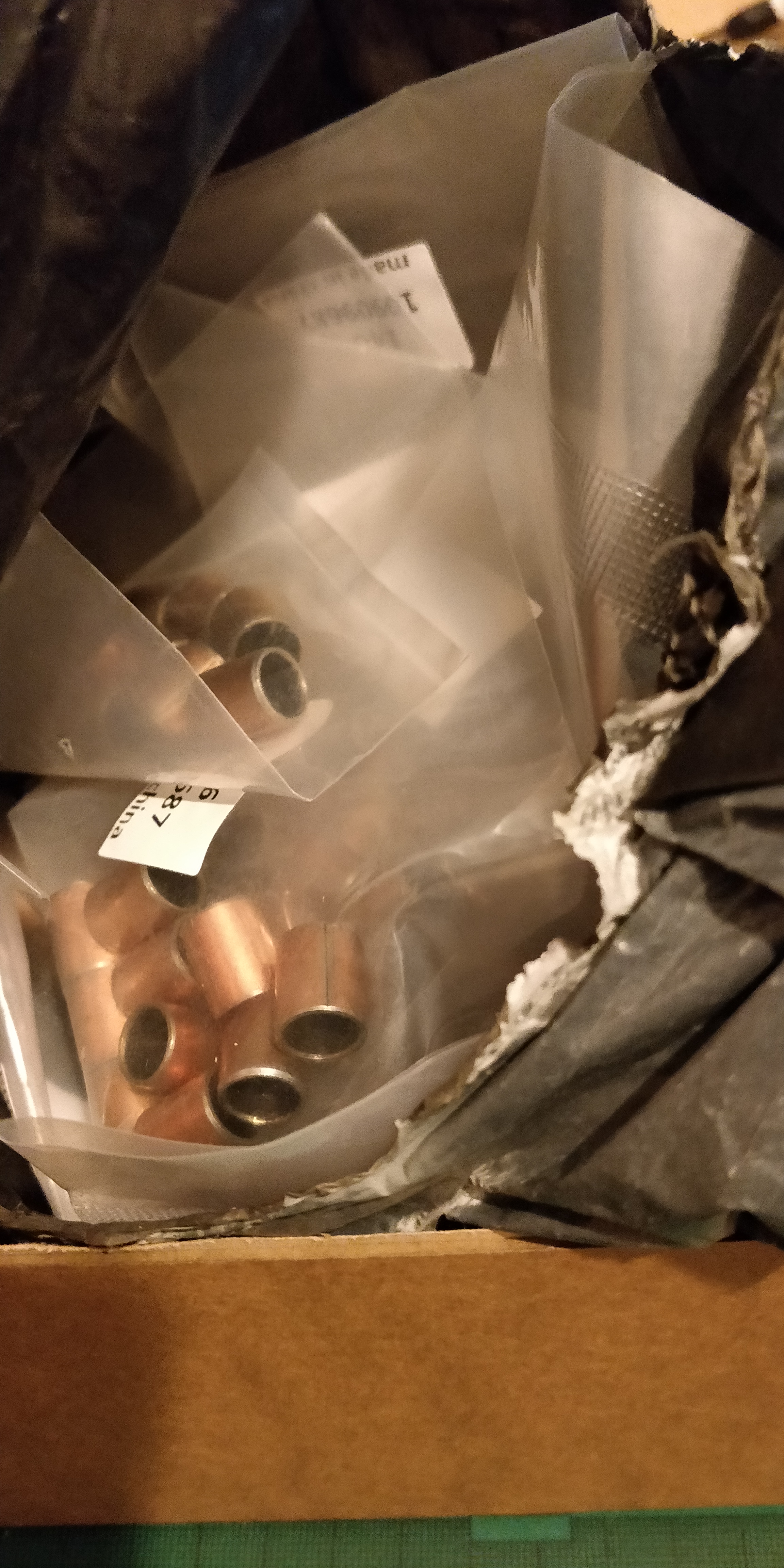

All copper bushings in there sleeves (FYI to @dermot & @Vagwin I’ve printed those for you too )
Printed parts in there little boxes :heart_eyes:
