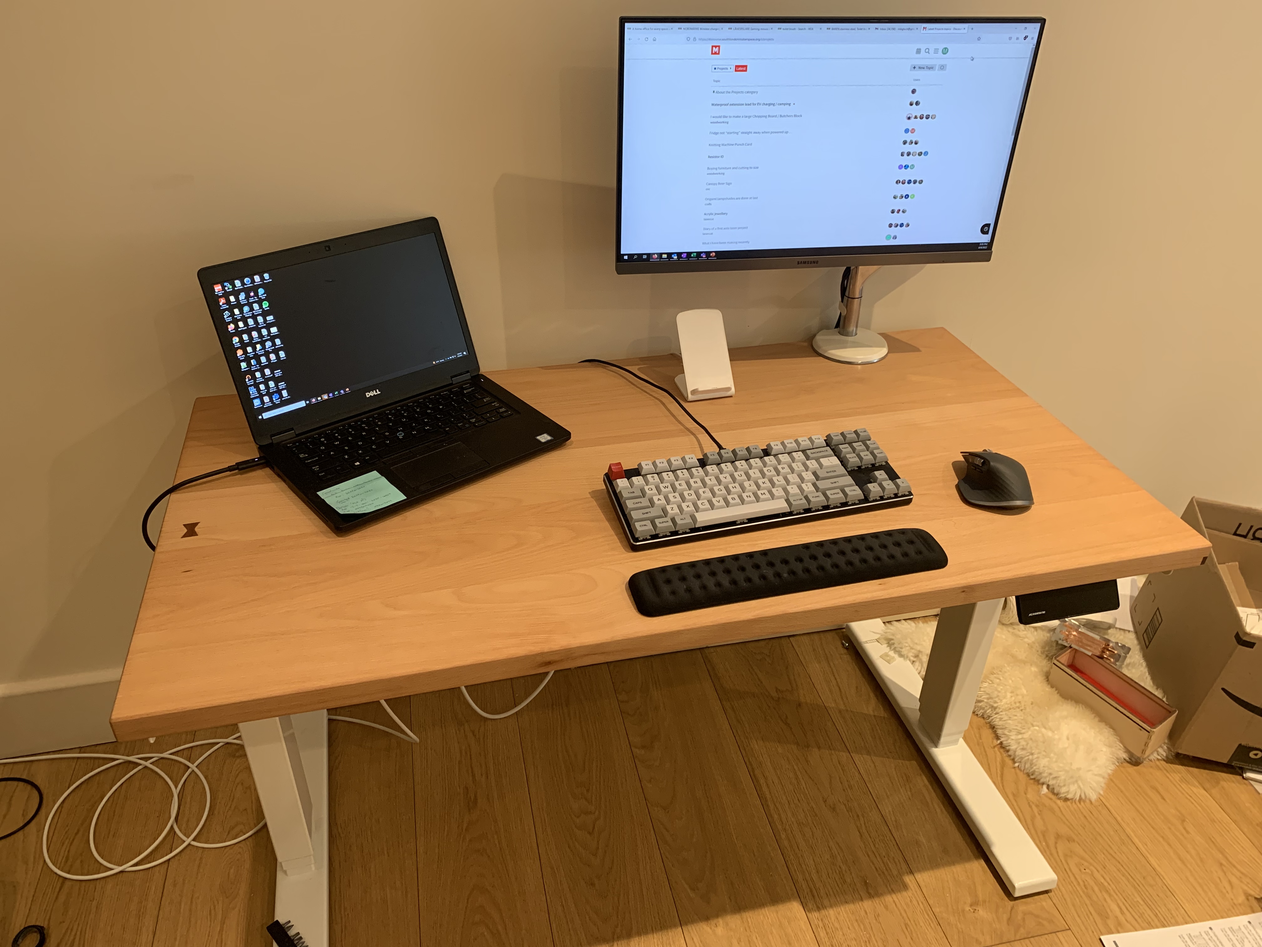

Might have seen this one taking up space in the space a couple of weeks ago! I’ve moved flats recently and wanted to upgrade to a nice standing desk. With access to the Space and a desire to get into woodworking, I decided to get a frame and make a tabletop for it. Here’s a few photos of the process, and some of the lessons learned:
Decided on using beech as it was the cheapest hardwood I could find (sourced from SL Hardwoods in Croydon, they were very professional), and purchased it PAR. I was hesitant because my internet research leading up to the project had me believing that beech wouldn’t look very good, but I have to say after doing this project that that’s a load of BS, it looks great and has a lovely pattern.

And here’s the final table installed on the frame, with some detail shots:
