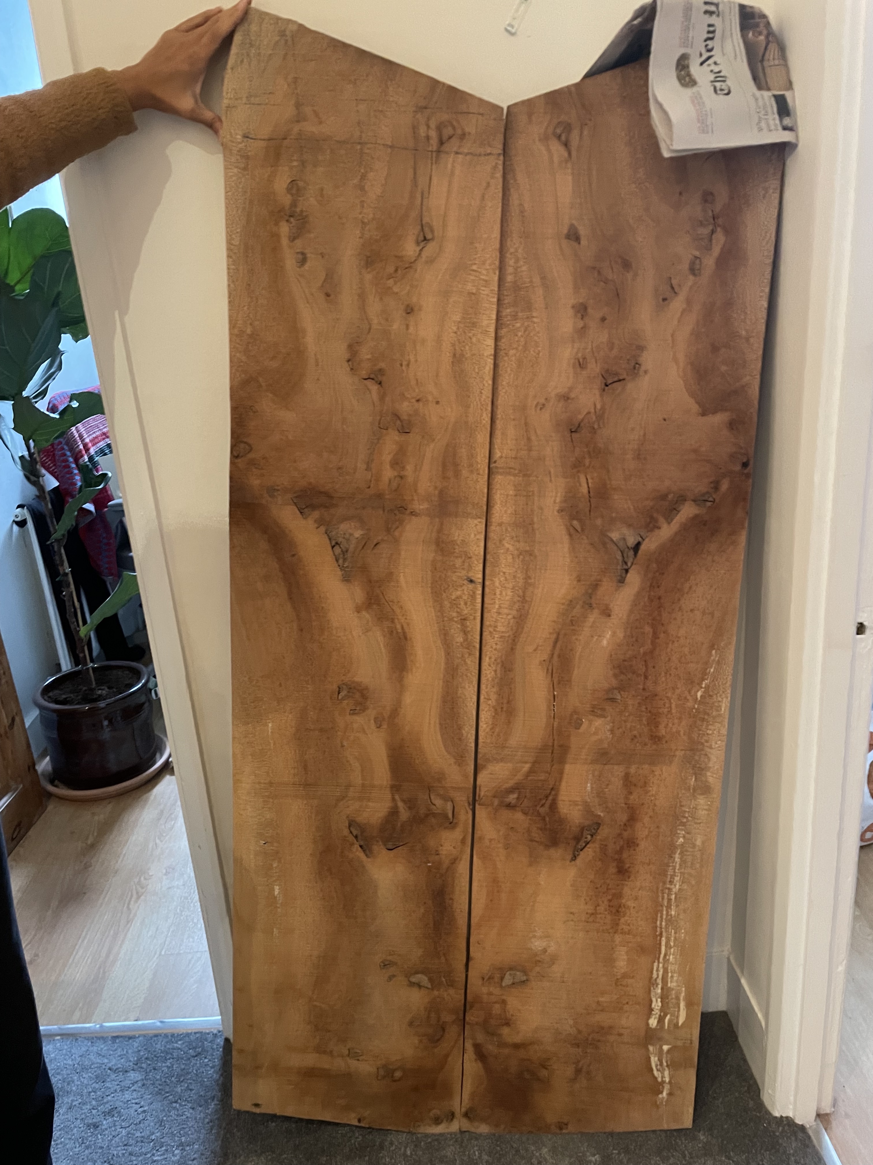

I’d love some advice. I’m planning on making a coffee table out of some rough London plane boards that I got as a gift.

  1. How would you recommend planing a rough board like this? It’s pretty cracked up
    • Planer thicknesser
    • Hand plane
    • Router sled…
  2. When to fill cracks in the wood, before or after planing? Thinking of using a wood filler or an epoxy
  3. Any advice on squaring up the combined boards so it’s a proper rectangle? Would a plunge saw be a good choice? It looks fairly straight to the eye already
Thanks!
My answers (with limited experience)
  1. The planer thicknesser would work well if the blades are sharp and you do really thin passes I would suggest Router sled if you are unsure but again shallow passes and bring your own flattening bit as ours aren’t sharp. The best option would be the drum sander but you wouldn’t be the only one waiting for that.
  2. Fill after plaining. If you are doing wood filler and you care make your own nothing from a shelf will be the right colour
  3. I would draw out your square then cut the edges on the table saw if the piece is not too big, plane the edges as needed
  1. could also do a rough flattening on the cnc table. If less than 30cm wide, it’ll fit on the planer though
  2. square the boards up before joining them, then trim the ends flush on the crosscut sled on the table saw. If your question is about getting a square edge on the unattached boards before joining them, jointer if it’s close enough, track saw first if you need to. To get a seamless panel glue up, joint the facing edges, flip the orient the facing edges over the jointer so whatever error you have in the fence is matched, touch up one of them with the hand plane to match the other perfectly. Use either the domino or biscuit joiner to help with alignment.

Also, no idea of your woodworking experience so apologies if this is remedial advice or I’m misreading your post, but unless it’s an intentional effect, you should always be flattening and squaring your board, and confirming flatness and squareness at multiple points along the way

Yeah, I’ll definitely play around with making my own wood filler and look into the router sled
That’s going to be a beauty! what a gift!
Seems like you’ve got great answers to your questions already. If you’d like help with any of the steps, feel free to shout
Thanks that’s helpful about the joining the boards. I’ll look into those past projects a bit more. The boards are bit too wide for the planer, unfortunately
