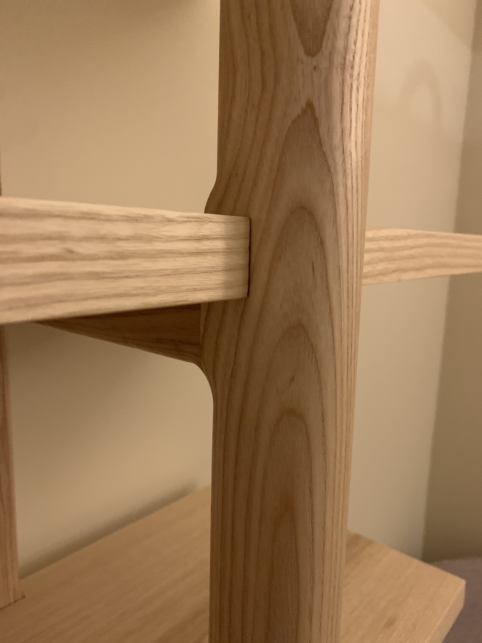

Detail:

By the time I got to the final design, I’d dropped the breadboard ends and detailing from the shelves and dropped down to two vertical supports rather than 3. I’d also dropped the idea of using two types of wood, and settled on making it all out of ash:
Some other feedback I received that helped influence the final form of the project: A friend told me the prior angled look was too “hetero-normative” and needed to be less square. I’m pretty sure he was taking the piss, but that did play into the idea I’d been exploring on the differentiation between the shelves themselves and their support. What I ended up settling on was a simplified horizontal rectangular shelf, and (at least an attempt at) more subtly intricate rounded vertical supports. Also I hadn’t done “round stuff” with wood yet. Another friend mentioned to keep the context of the shelf in mind - it will eventually be covered in books and other objects that are colourful and shaped differently. As such, you don’t want the shelf to “overpower” the objects that are placed on it - I really liked this idea, it influenced the decision to remove the two tone wood and use ash. I removed the breadboard ends to reduce the complexity of the project, and removed the chamfers on the shelf ends. At this point, I started to consider the size of the wood that I’d be buying and playing with the proportions on the project. Having never bought rough sawn timber and milled it, there were a few unknowns that led to some excess deliberation and hesitation before actually getting the project started. After a call to the wood supplier, they said it typically comes in 3m lengths and is a bit oversized from the listed dimensions to account for warping and such. As wood is expensive, I settled on shorter 1.5m shelves to economize (two from each board). I also had the idea of having overhangs to allow space for other objects on the shelf. By making the shelves shorter and the supports closer together, I was able to drop the third support. I also worked out the detail I wanted on the joints, and thought through step by step how I was actually going to make the relevant cuts:
