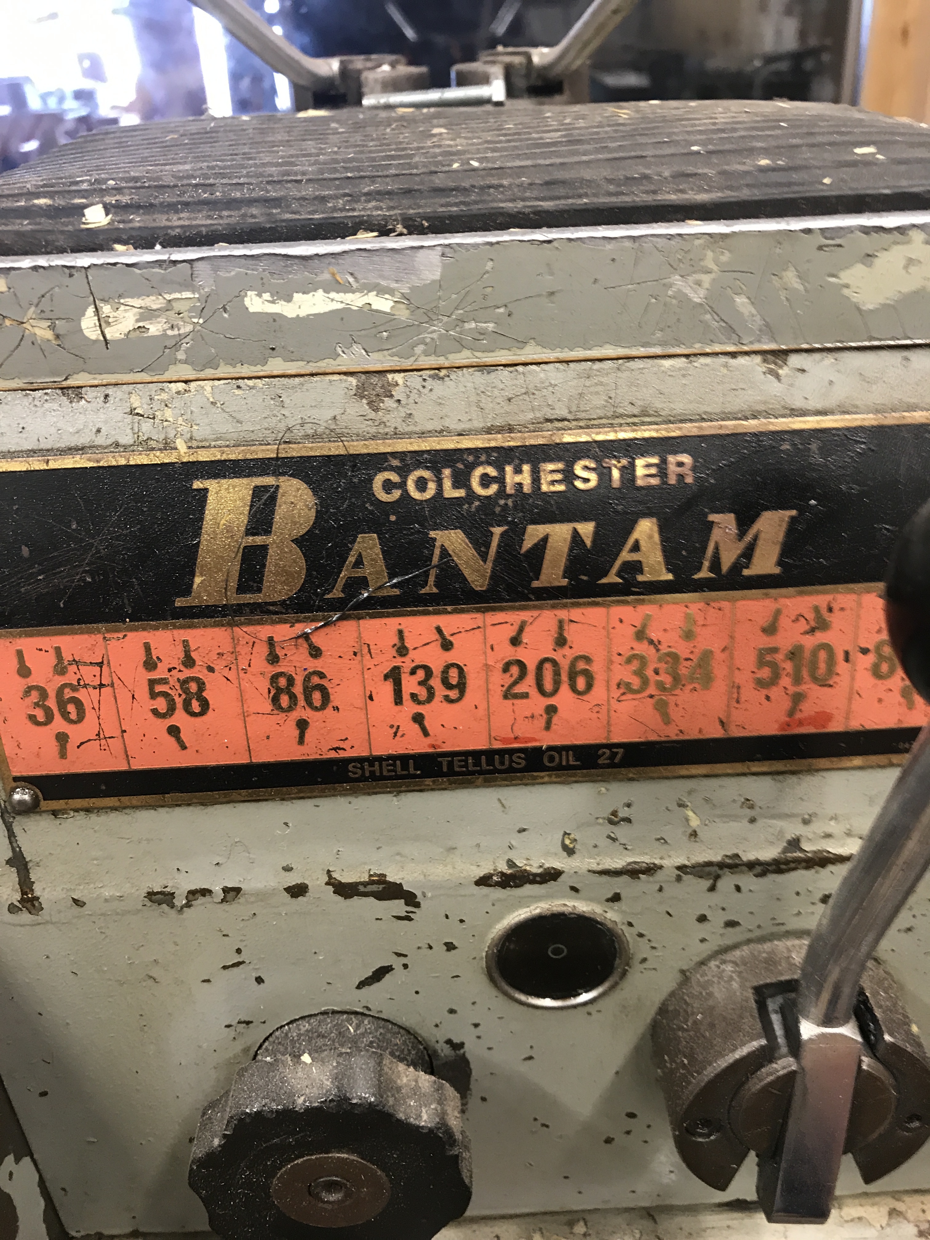

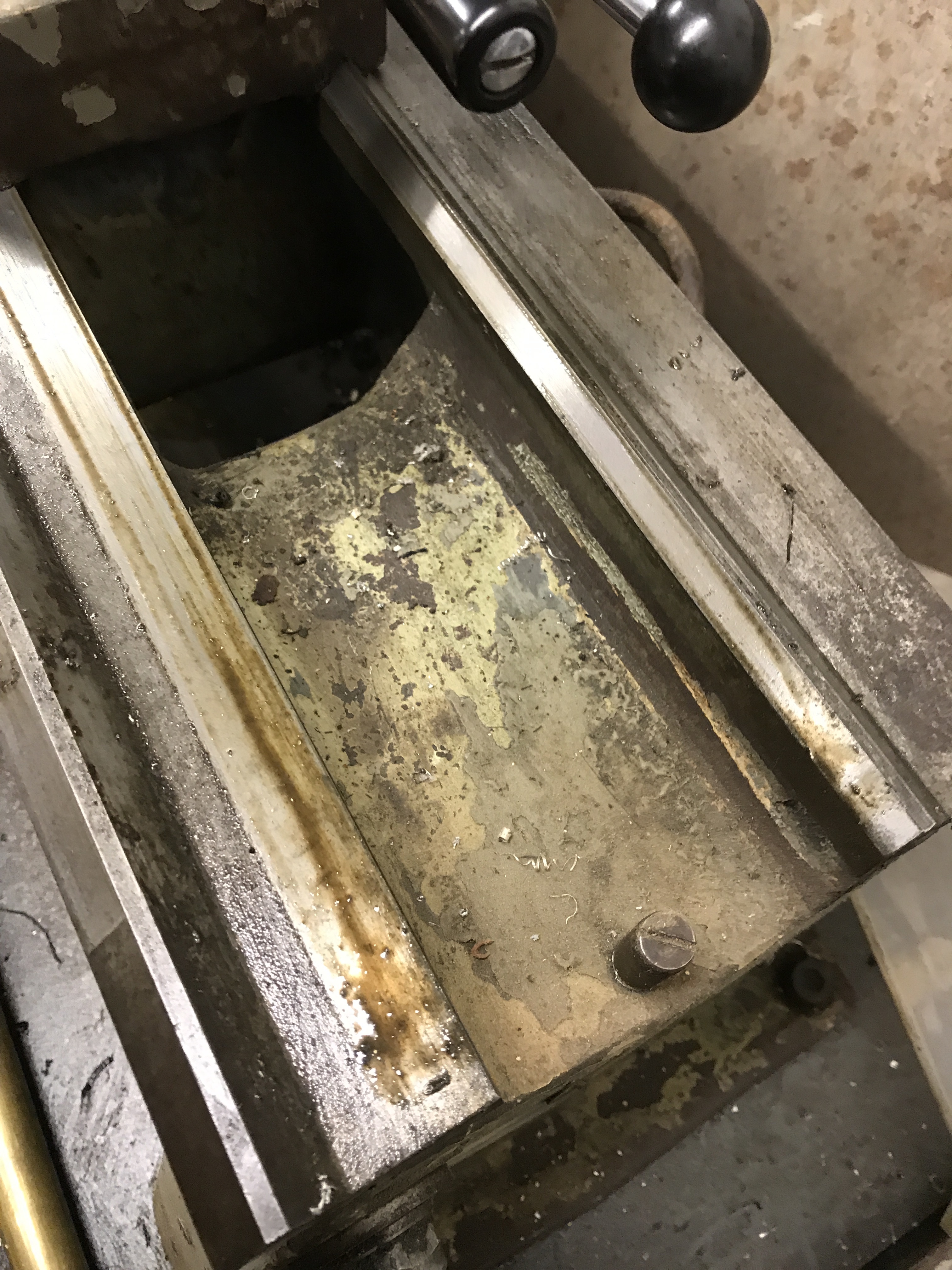

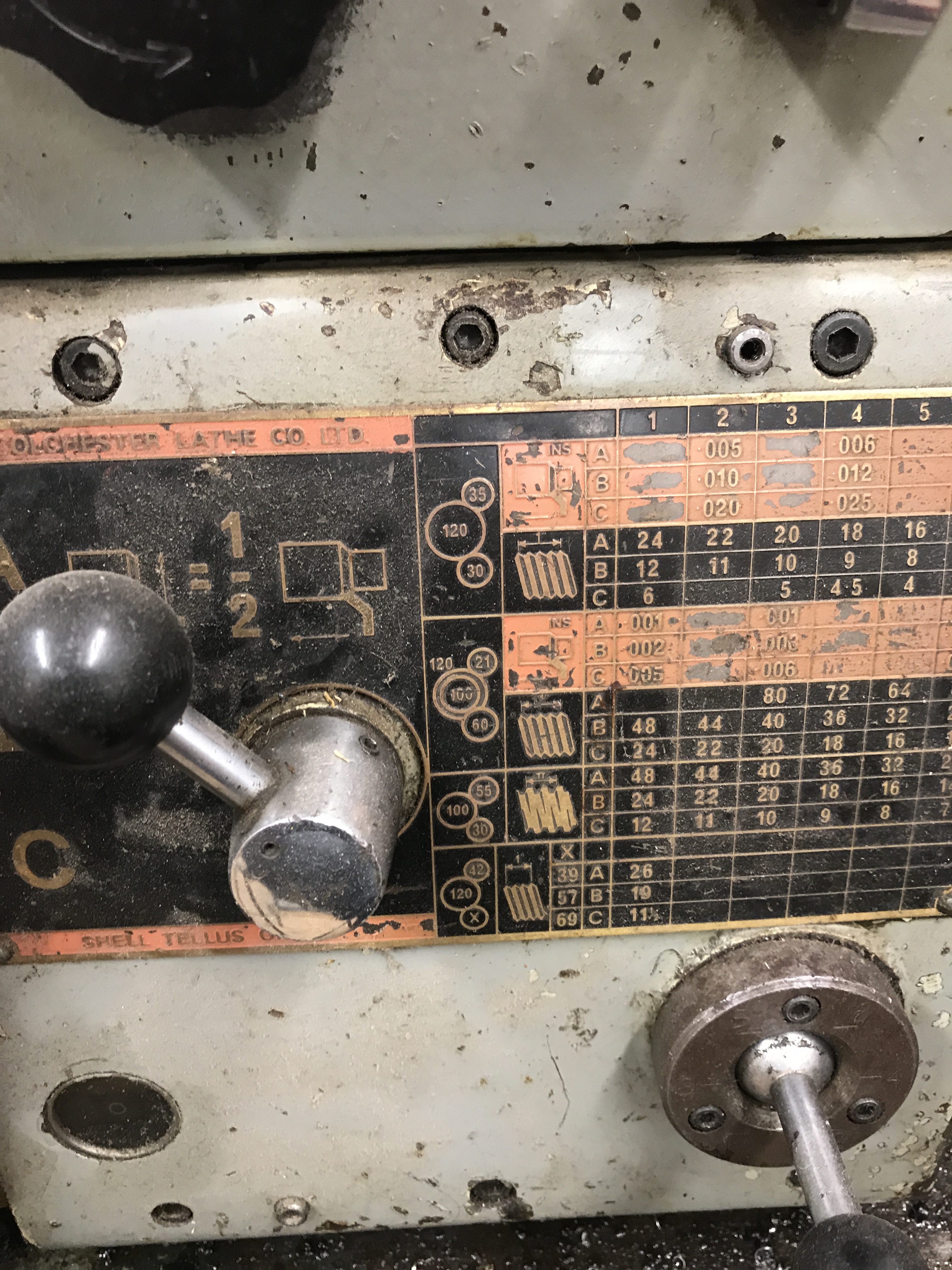

@platinumnqueen22 @Howard @lewisss have opened the door recently, they might be able to find it
lewisss
(Mark Johnson)
11
No serial number I can find but maybe identify from these
lewisss
(Mark Johnson)
12
The bottom right small shaft is the one that requires bearings

frasco
(Frank Scott)
14
Looking at wrong end. It should be at the tailstock end. If you can’t see it there, try moving the tailstock to see if it’s hidden underneath.
