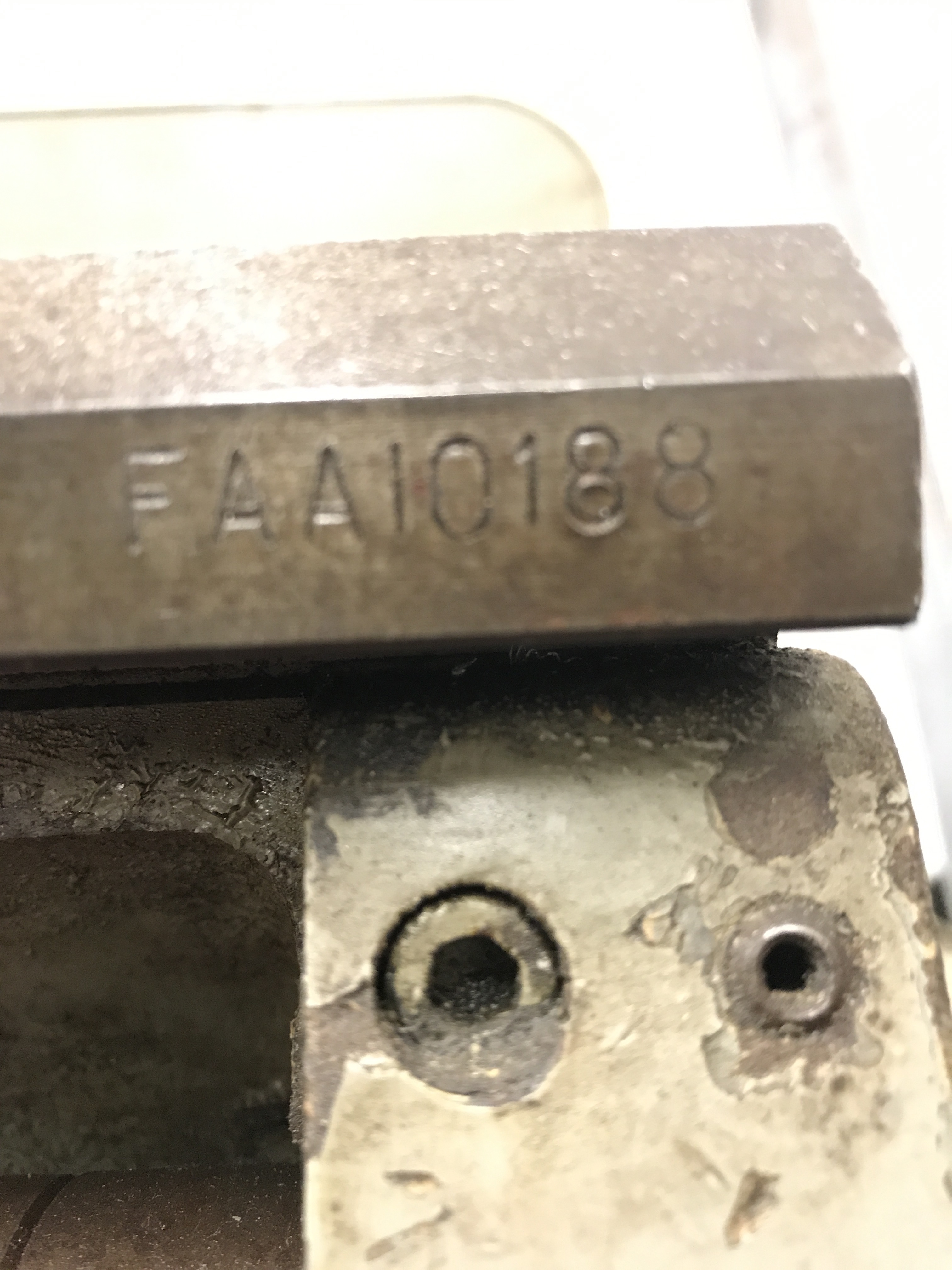

Stamped into the bed on the right hand side, next to the tailstock
Thats exactly right.

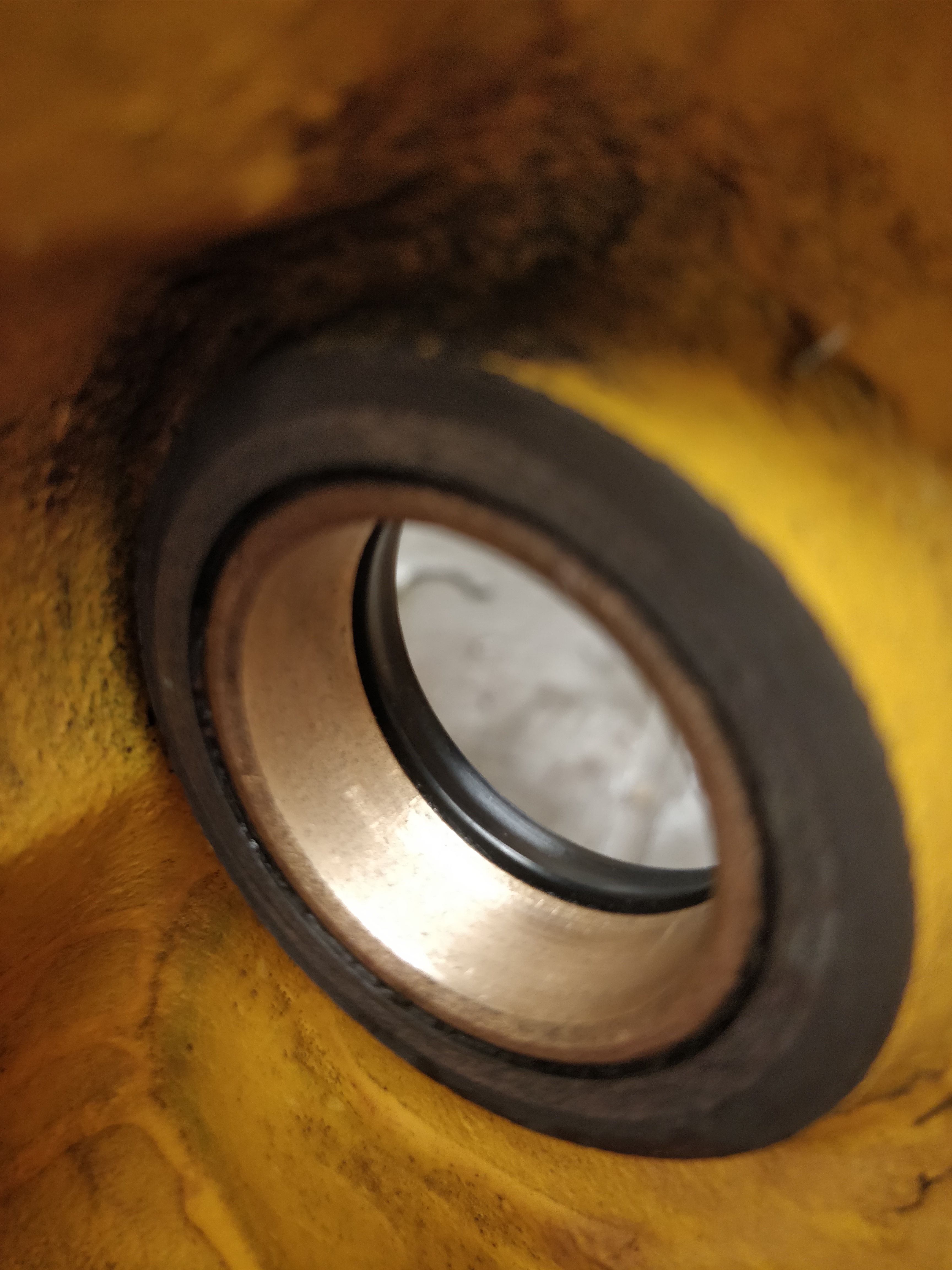

It needs to be levelled, and then everything checked over and put into tolerance before money is spent on it really.
Pull the bearing and take the numbers off of it. Should be a few quid from a online bearing shop.
I think it needs to be pulled tonight and an action plan put in place. If it’s a standard part bearing or bushing, that can be overnighted and it can be fixed on Saturday
It needs pulling and assessing. Make sure that is that part that’s the problem though first.
If it’s a bush it could be more work than that. Higher chance the shaft is damaged and if not the bush would likely need to be reamed once fitted.

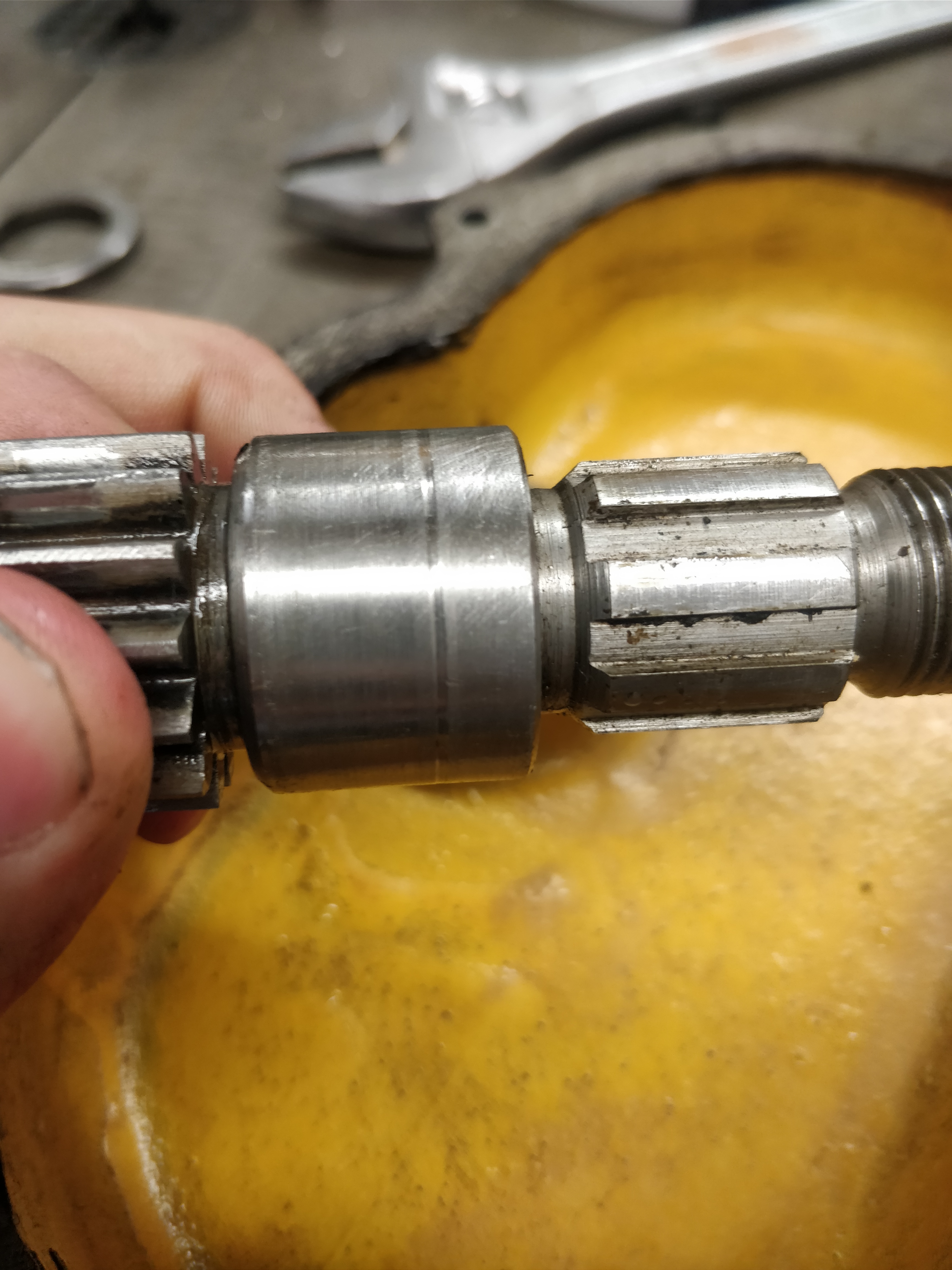

Mark and I did a little investigation into the noise this evening - the lathe itself operates fine, but there is severe play in the lowermost gear that drives the leadscrew/thread cutting device.
This is caused by a worn out bushing, which has in turn caused increased wear to the shaft. Both pictured.
There are no metal particles to speak of, and no damage to the rest of the lathe.
It’s currently draining of oil, which I will replace (along with a gasket) tomorrow morning.
Two options, as I see it:
1: Leave the gear assembly as-is, there will be some knocking noises and tell users not to cut threads.
2: Blanking plug of some kind until new parts arrive.
Opinions?
