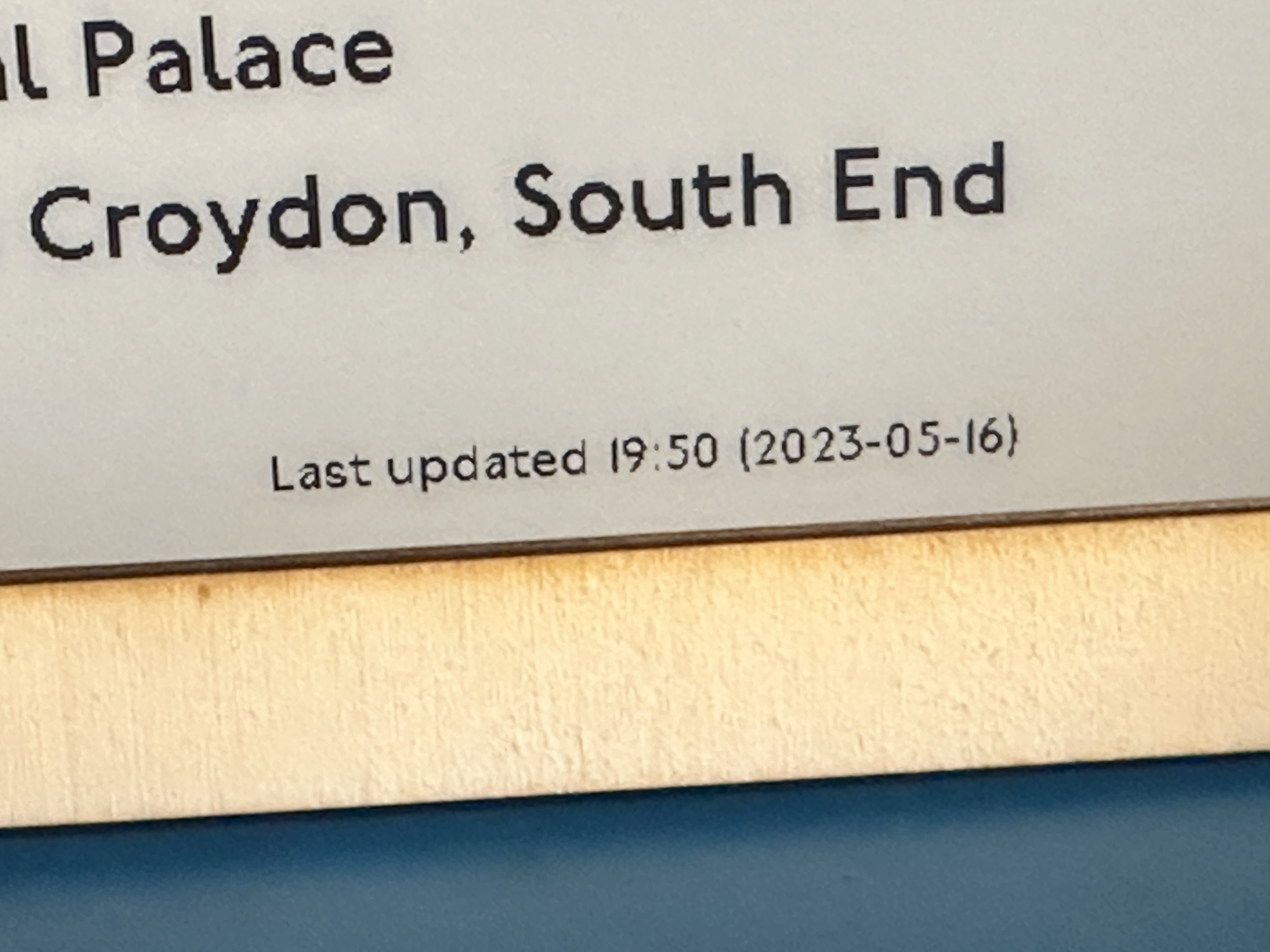

A couple of observations so far - it seems to get hung up and stop updating from time to time, probably need to look at the logs etc…
Also - maybe add the last update date in addition to just the time, because when it does stop updating it unfortunately could be last updated yesterday not today!
Thanks!!
:sob: I need to find a way to get it to save some logs somewhere first … it’s Micropython, so the onboard thing is pretty lightweight, but maybe there’s a way to send some “heartbeat” and some logs to the cloud somewhere. Or to at least set up an onboard watchdog that auto-restarts it more reliably than my current exception handlers.
What do they say about a stopped clock? It’s still right twice a day :wink: (or once, if I remembered to use 24h time). Yes, I’ll add the date too :slight_smile:
I’ll come in on Monday (or Tuesday, if nobody is hosting on Monday) to work on this, and also play with another option that uses a VGA display.
@asander1 This has now been updated to show the last updated date and more importantly to have a watchdog timer which should automatically reset it if it crashes.

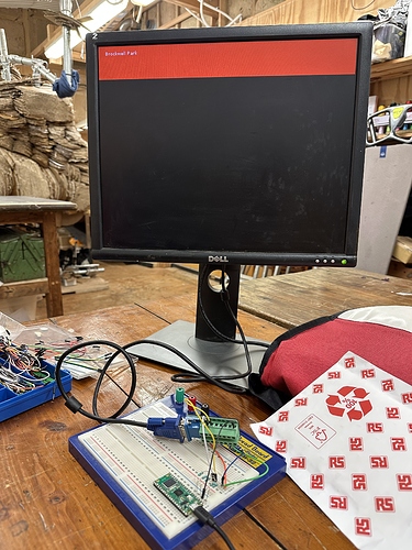

FYI, it looks like the e-paper display may have been a poor choice for frequent refreshes, as it’s already faded away. I’ll see if I can resurrect it but in the meanwhile I’m also trying a different approach to output this to a VGA monitor.
I’m going to mark one of the monitors that were destined for recycling with my username and ask that it’s not thrown away so it can be used for this project. I might take it home temporarily while working on this, if that’s OK.
