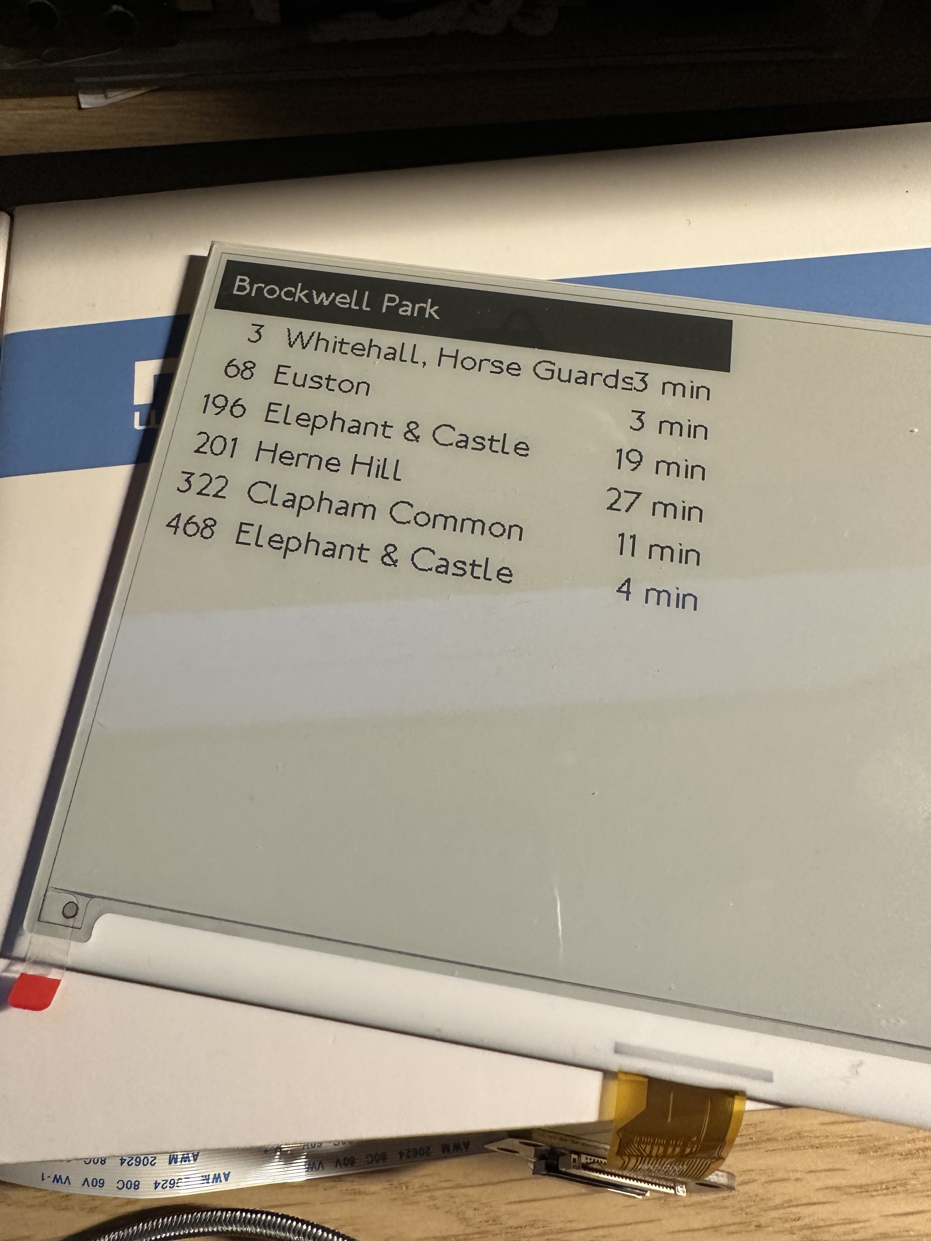

First attempt to make it show on an e-paper display. Ignore the size, I was originally designing for a smaller display but I managed to get a 7 inch one.
Looks great! Size is good?!

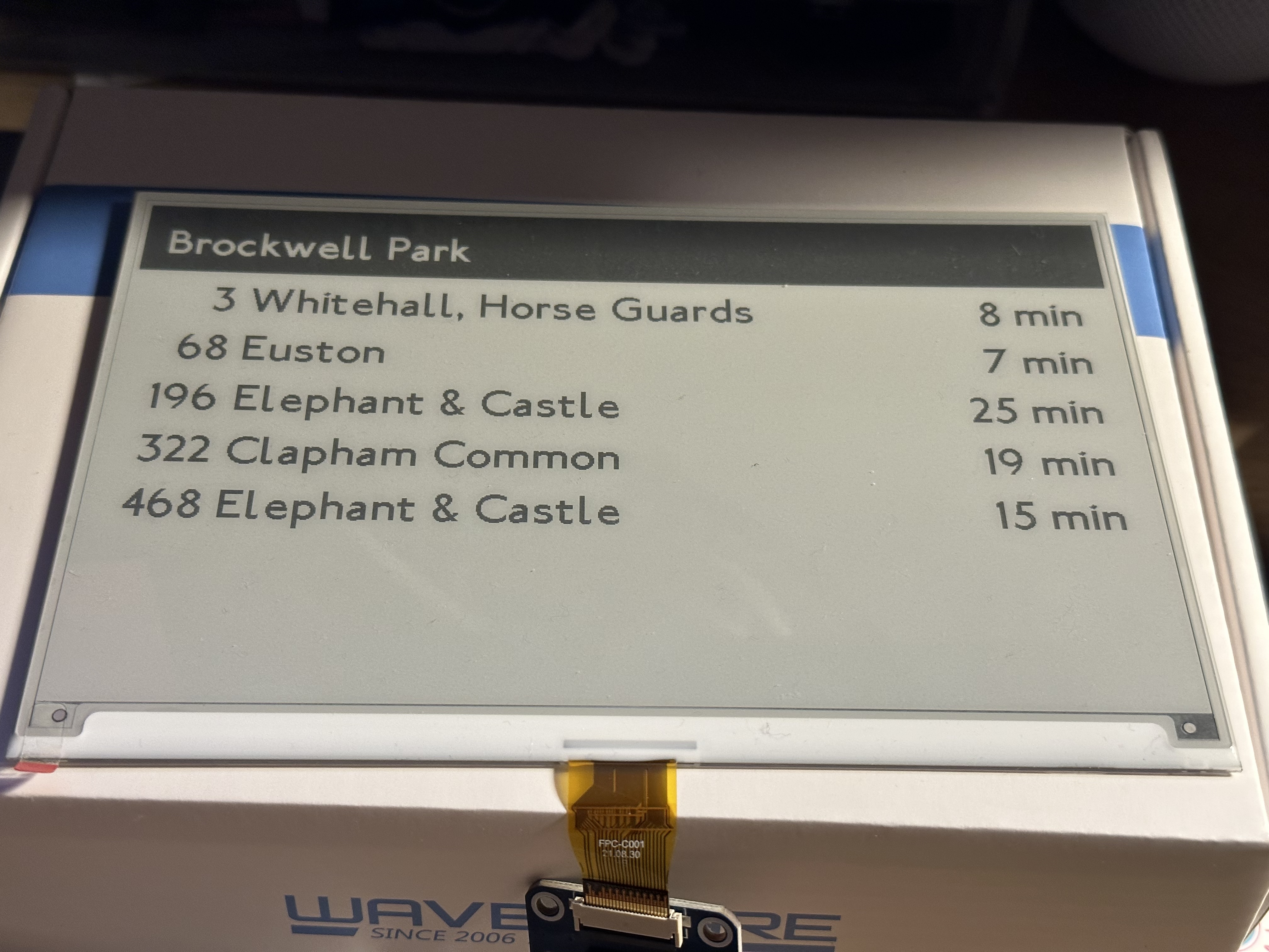

Here it is with the right size, I reckon it’s readable standing 1 meter away or something like that. It’s similar size to the displays you sometimes see outside a meeting room showing if it’s booked or not.
I don’t see my train… :frowning:
Trains are coming. I’m focusing on getting this to work reliably end-to-end showing 1 bus stop, then cycling between multiple bus stops, then I’m going to also add train stations.
Looks very nice! Great work!

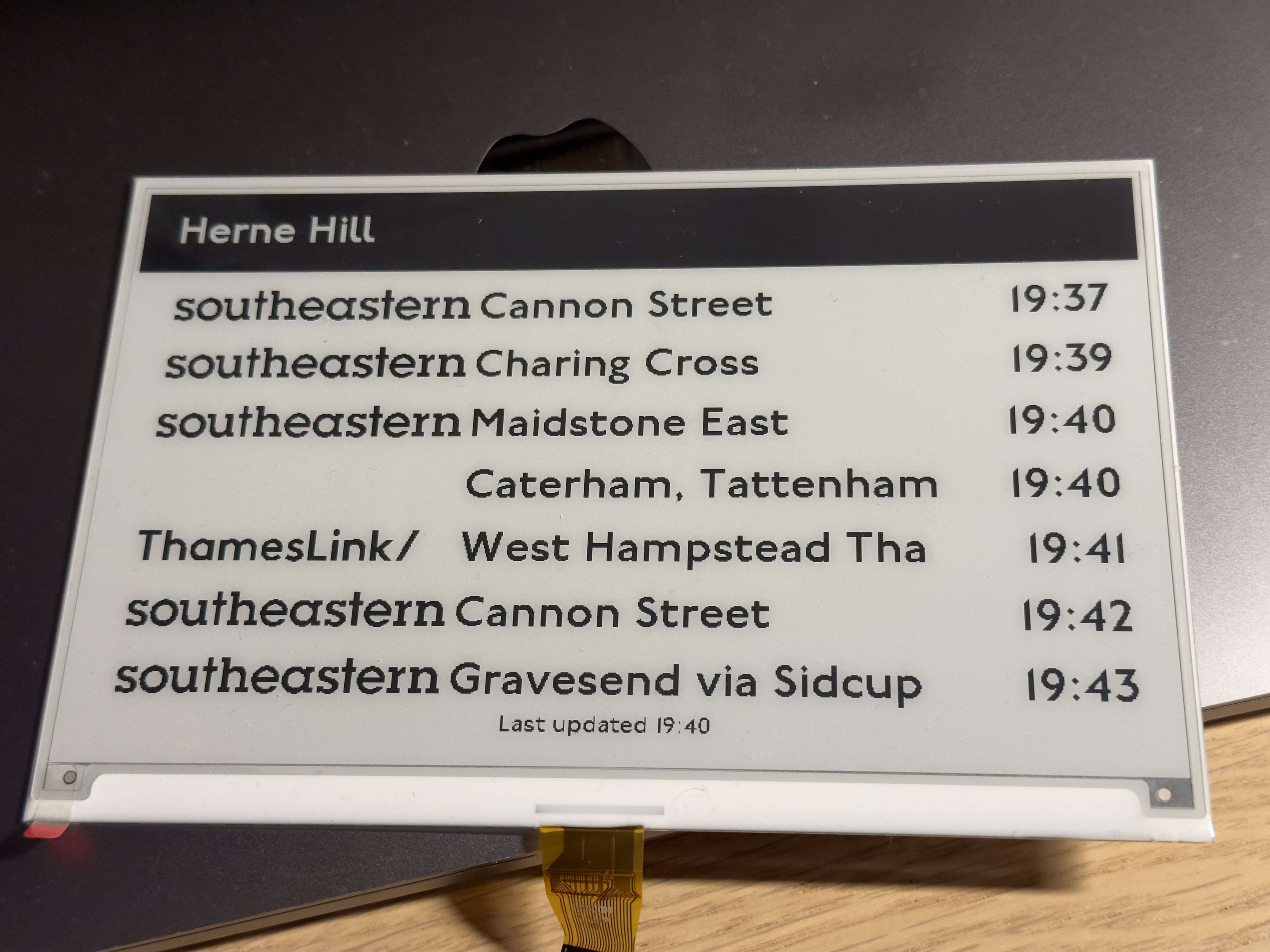

Now works with trains too! Honestly the hardest part was not the device but finding a way to consume the National Rail API which is horrible (in the end I built a little wrapper in the cloud)

I like that official TfL font. Nice touch.
Don’t tell TfL though, because I “borrowed” these web fonts from their website and their intellectual property department might not be too happy :shushing_face:

If you want to be squeaky clean, Railway Sans is an open license font that very closely matches Johnston
