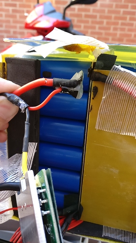

I bought the above battery a few weeks ago and today I had an accident. While putting on the charger a very big spark fried the contacts and made reduced my motorbike a useless junk as it wouldn’t power on anymore.
I’m using this bike to commute to work and would like to make it work as soon as possible.
After I disconnected the battery I started to dissect it an I found that one of the positive strips has been ruptured, thus completely cutting power to the bike and the charger… after I measured the other output I found that the battery is in tact and luckily survived.

I already found the problem… That’s why I decided to remake it better in telsa style

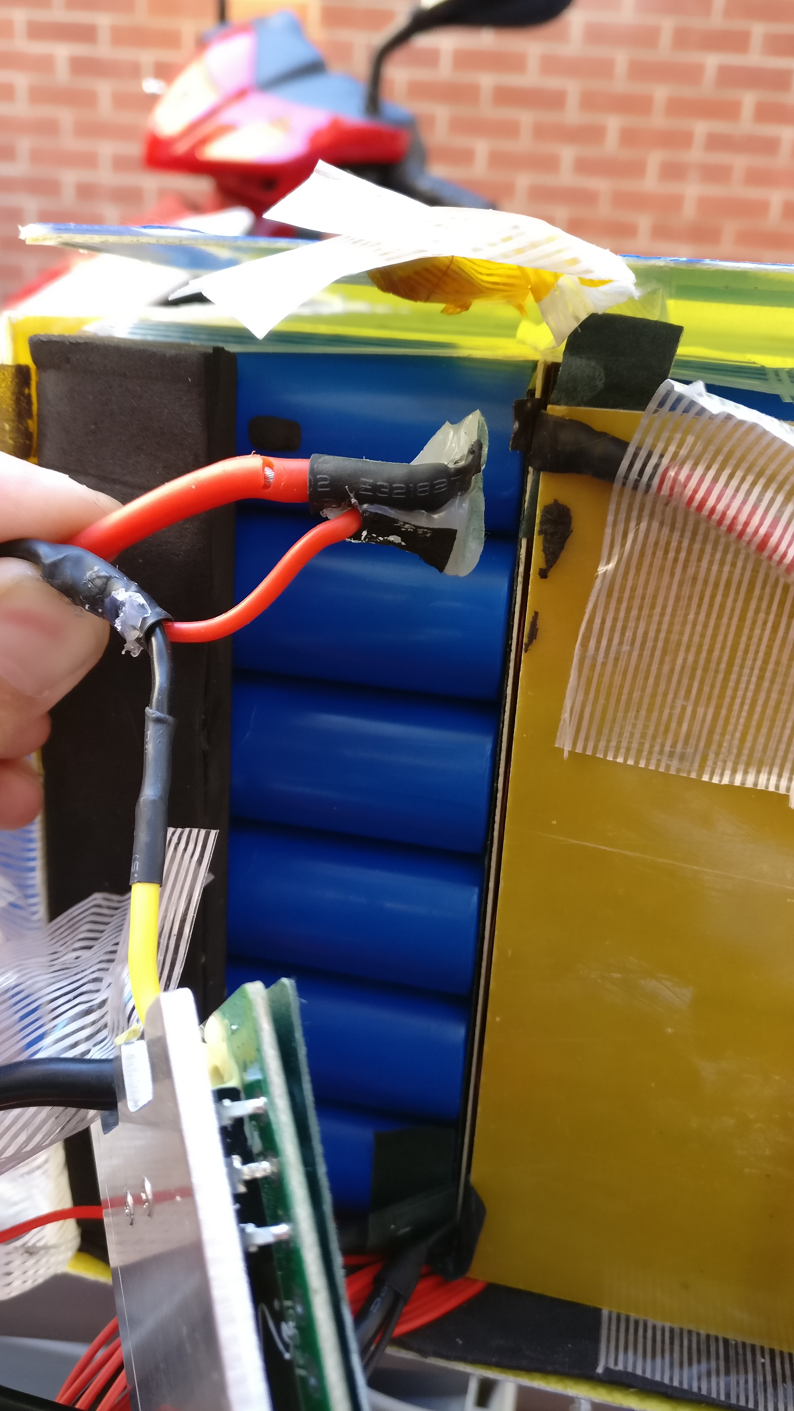

You can see the charger and one of the output cables broke off
The other red cable is giving normal voltage
But having seen that ‘beautiful’ tear on the cable I would like to make it as safe as possible for future use!

Just as extra detail these are 26650 5000mAh cells

I managed to patch up the battery and replace all the cables needed… Also ordered parts once they will arrive I will reconstruct the whole thing. until then I hope the fix will do
