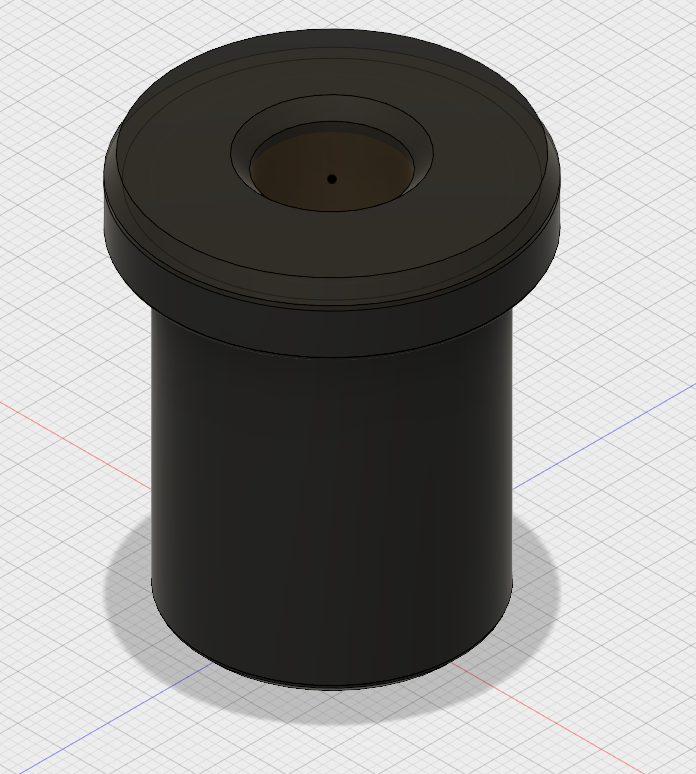

So I threw together something in Fusion 360 which would go into the monitor pole, and hold the mic arm:
And then I went via 3D Hubs to ask @josef (hello!
) to print it for me, as I didn’t have any filament to hand myself, and wanted to try it in ABS.

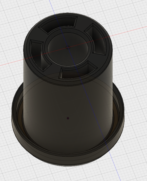

Unfortunately, I hadn’t taken into account the shrinkage, and the fit on the mic arm was much too tight (even after drilling it out, it was very much press fit), and the fit on the monitor pole was very loose. So I redesigned it, and removed a fair amount of material to make it a bit more thrifty to produce, whilst hopefully retaining it’s structural abilities!
