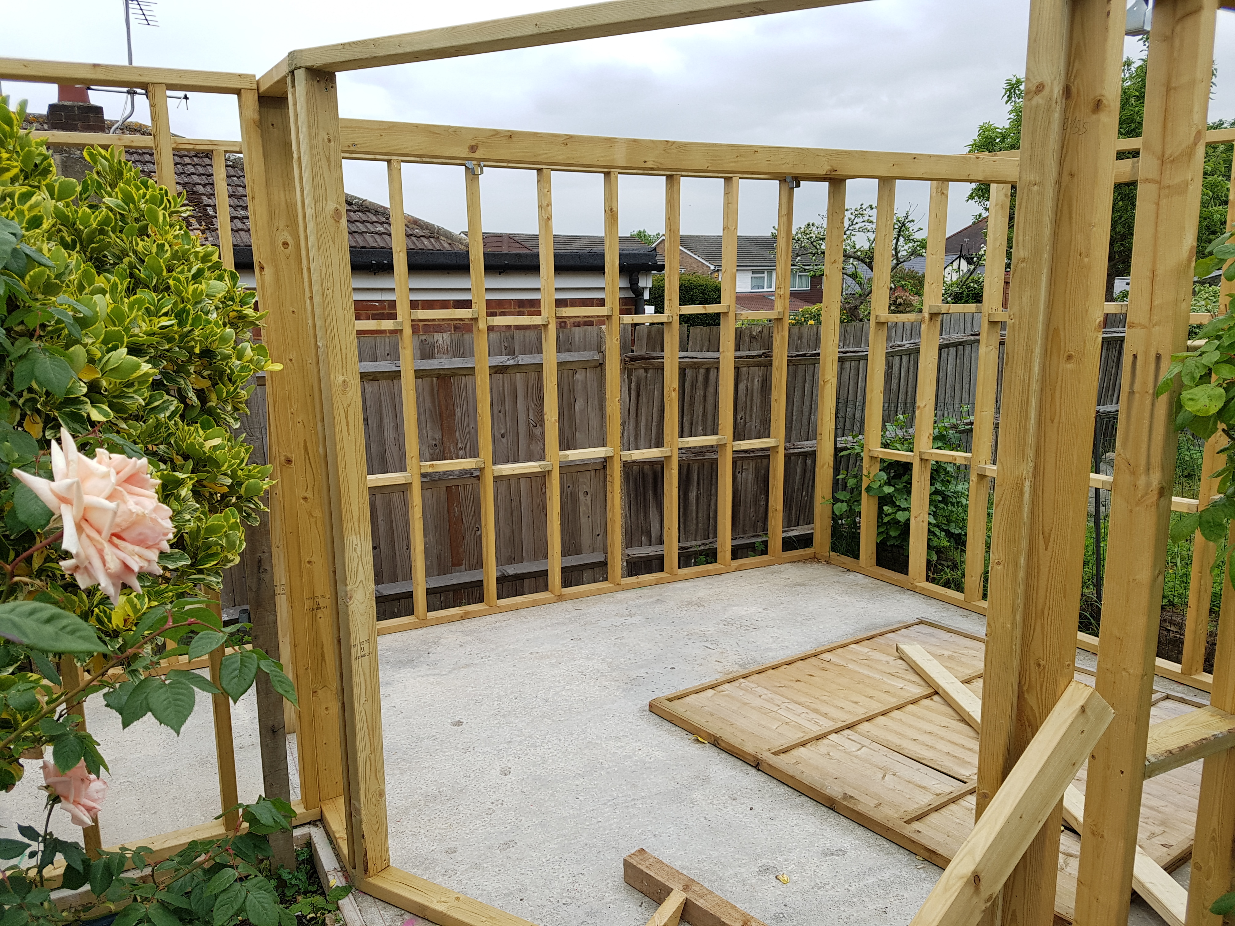

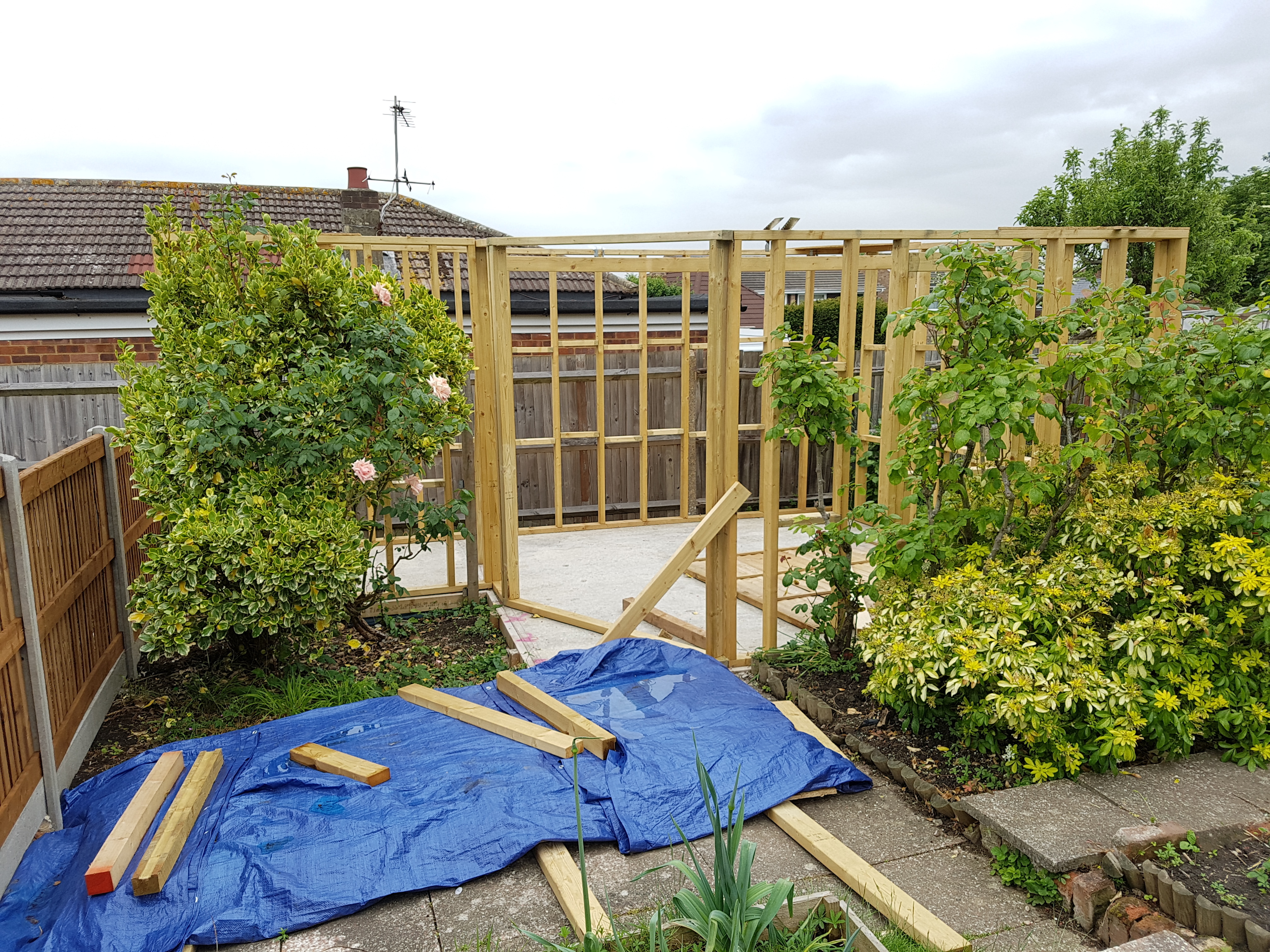

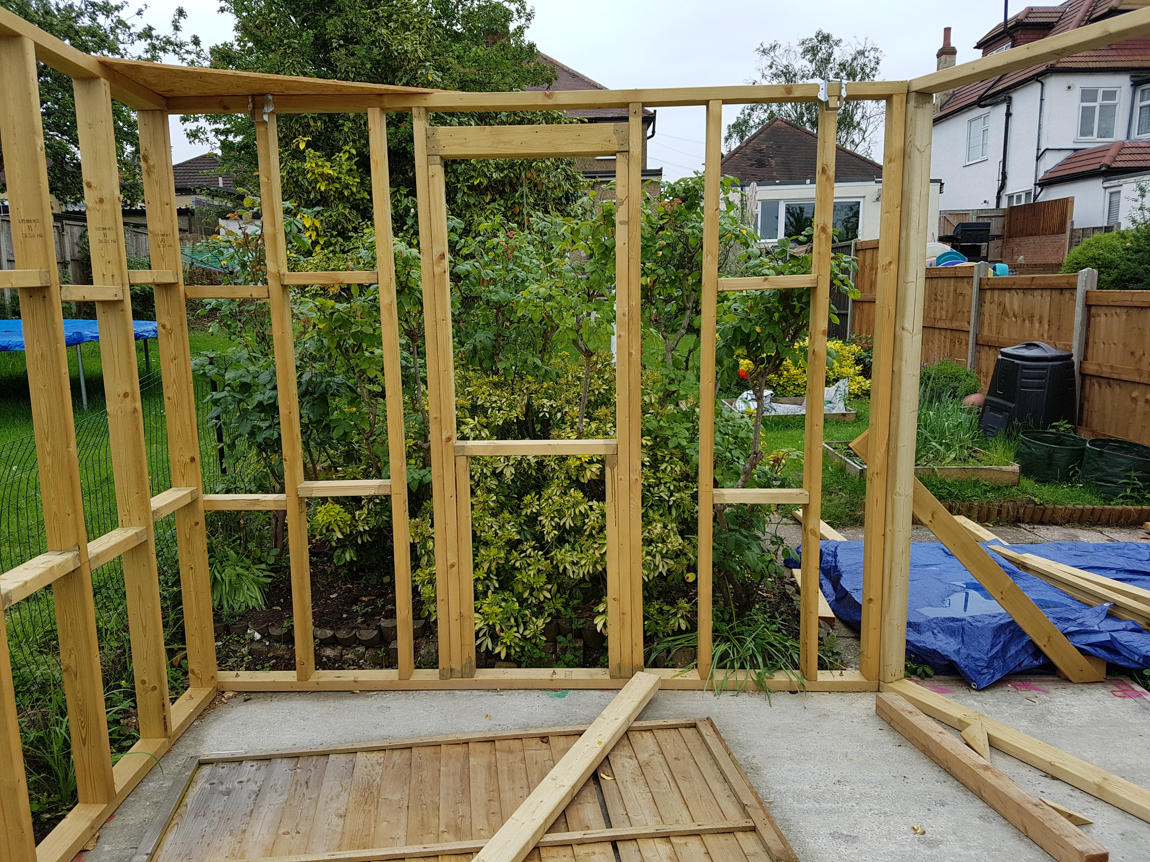

I just started making my shed, it has been a very slow process because life keeps happening.
I also know a few other makers/spacers who have built sheds too and been very helpful.
What’s your design?

That’s gonna be one impressive space when it’s finished. What’s the plans for it? What are you cladding it in/making the roof out of?
Would’ve loved to have built a larger shed/workshop, but was only allowed a 6x4 by the council :pensive:
I am planning on exterior OSB with shingles on the walls and GRP roof. That’s the plan…
Never seen the shingles on osb technique before. Do you have to treat the osb first, or will the adhesive/shingle coating provide enough weather protection?

No so I can’t afford cedar, I am thinking to use the kind of bitumen roof ones. Originally I was thinking of using shiplap cladding but the shingles are cheaper. I can’t find anyone who has put them on the walls but I can’t think of a reason not too. Can’t use them for the roof ironically as it is less than 5° pitch.
