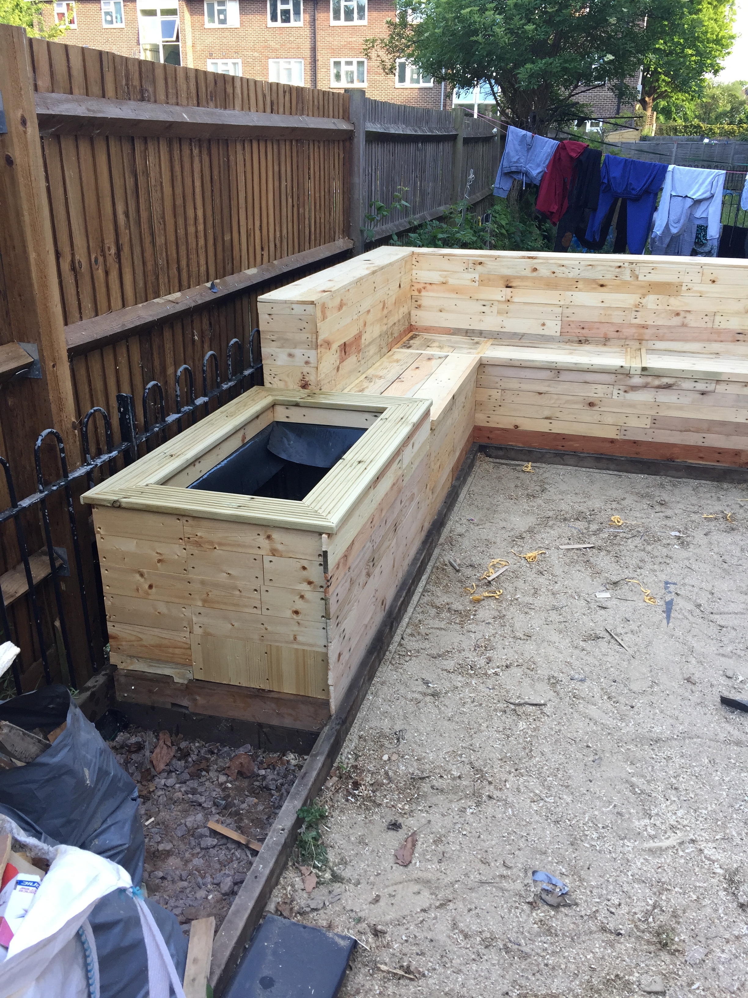

This looks cool. What did you use to paint it? And was it more for weather proofing or style/aesthetics?
It’s not been painted yet. Just had a couple of clear coats of wood preserver. Gonna go round and fill all the screw holes, sand the lot down and then use a Ronseal/Cuprinol type weatherproof stain. Maybe a light cedar colour. Then going to stain the decking boards with Croma organic wood stain. It’s a nice rich brown colour and will contrast with the cedar. Also, the decking boards top off some raised vegetable beds I’ve built and I don’t want to use any harsh chemicals on the boards and have nasties entering the soil and therefore the food chain!

Fun. Well, I enjoy it. Dunno if ‘fun’ is an accurate description though. This is the third summer of sorting our garden out. It was a state. Chest high weeds and brambles. Took one summer to clear and flatten it and two to get to where we’re at now. Maybe another 6-8 weeks before it’s finished and we can lay the artificial grass. Can’t wait!
