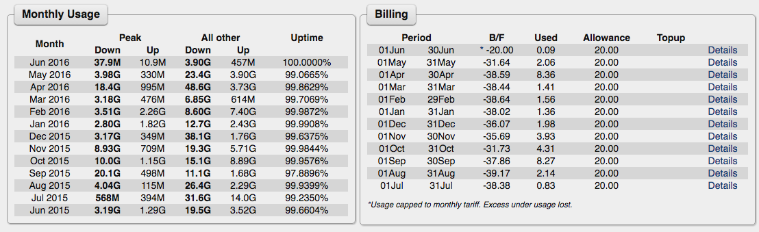

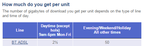

Our bandwidth allocation is 20.0 units per month, I don’t really understand what this means: Units

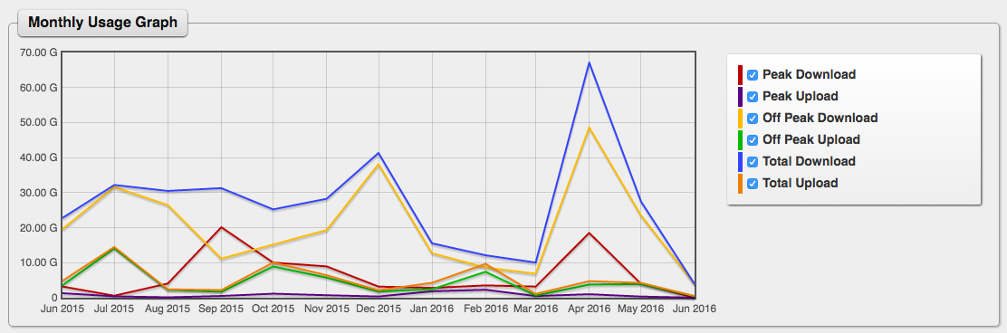

The utilisation figures indicate we’re not normally using anything near that, always less than 50%:
You can see in April and September someone went mad and there are random months on there that go up and down.
Interestingly the high utilisation of bandwidth is happening between 9am and 6pm weekdays which is their cheapest byte per unit time, so someone is presumably using the space’s broadband heavily during those times, who knows…

Was that April usage spike due to Arduino Day? If so, that suggests caution in holding more than one such event in a single month.
Was there a lot of downloading then?
I think it’s the other way round.
You get 2.5GB per unit during office hours and 50GB per unit evenings and weekends. So we’re getting poor value for our units, if peak usage is 9-6.

Spotify runs at 160kb/s so 20kB/s so 70MB/hour.
In terms of A&A units, that’s .03 daytime units or .001 evening/weekend units per hour. Basically irrelevant.
