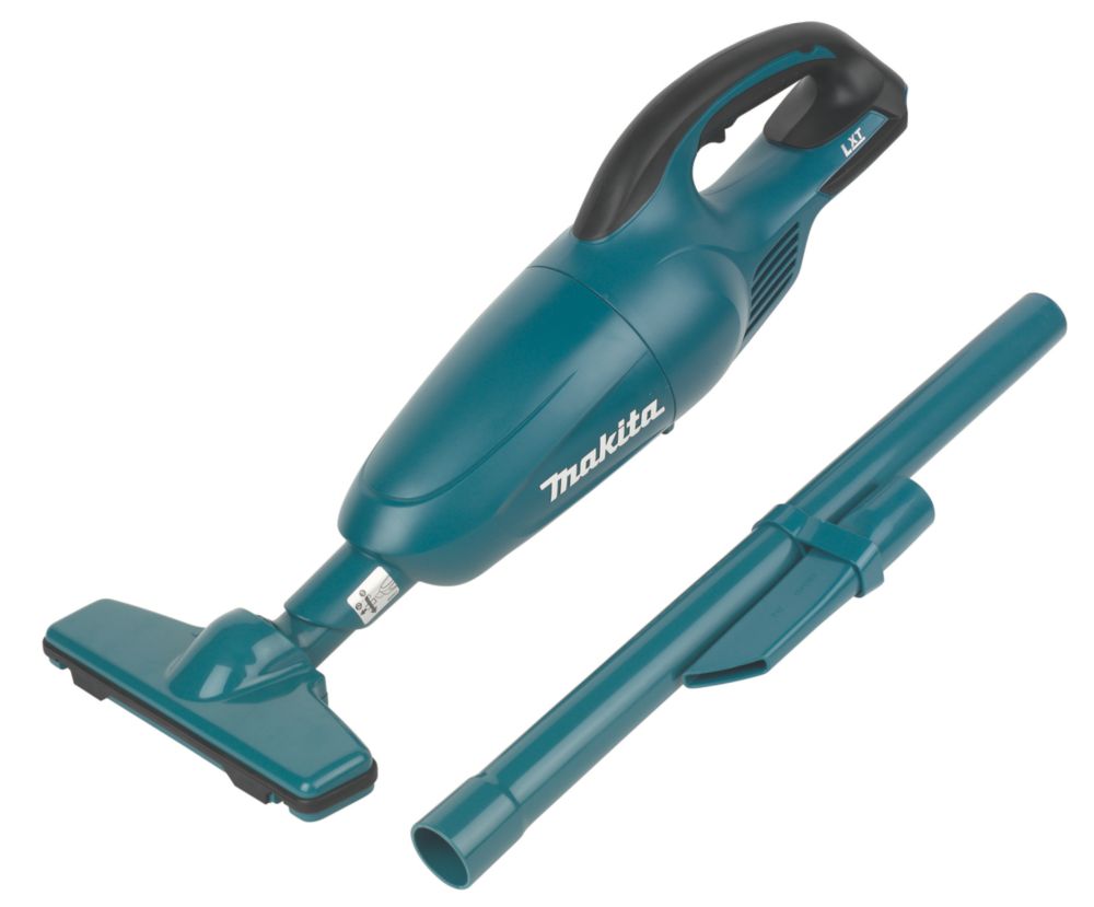

how about something like this for doing quick light weight cleaning in the clean room?
Expensive to feed

Looks cheap, but read the small print - no batteries or charger included
What cordless tools do we already have? Is it just the Hitachis? They probably don’t do a cordless vacuum.
They do, but it’s a nozzle-less “dustbuster” type.
Plus all of our batteries are on the way out anyway
