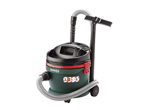

I looked for the cheapest vacuum recommended on some builders forums, and found this one:
advantages: has a bag, but can be used without. Has a filter which is not cheap, but washable. I bought a spare filter, and every Friday after leaving site I would take one home and use the garden hose to clean it properly. Both filters have been with me for a couple of years and show hardly any wear.

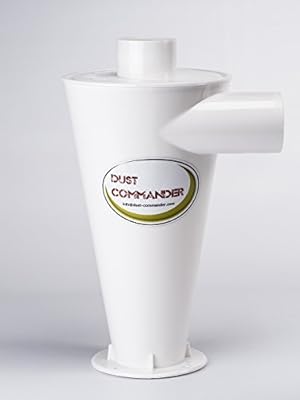

The trick: Very little dust ever enters the vacuum cleaner. Because two more items get grafted onto it - a vortex separator:

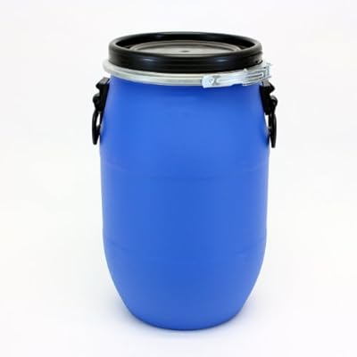

mated tightly with any old bin, as long as it is properly air-tight:

Well, I had my doubts. But I have seen good quality vacuum cleaners die of clogging and overheating ten minutes after they met fine red stone dust. And this combination… it lasts. And it, erm, really sucks!
Fine dust will clog up the final filter after a few hours - but by that time the blue bucket has already been emptied two or three times, and the Metabo only has a smattering of stuff in it’s own collector. And that’s when you swap the filter, and all is as new.

As an aside, using a pre-separator is still a good idea for professional tools. Especially when vacuuming around metal workshops, it’s nice not to have sharp bits rattling around your expensive hardware - the vortex separators are incredibly efficient, and the buckets are nice to carry out and tip out!
