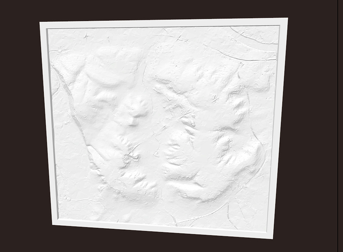

I grabbed the coordinates of the area that I think you’re interested from the TIF you uploaded (using gdalinfo), and the command to generate a PNG of elevation data for this area would be:
Each time I try and attach the resulting PNG to this post it doesn’t work as discourse is converting it to a JPG
This PNG can be fed to hmm though and it produces an STL (quite a big one, so here is one which has been simplified and scaled).
I applied a bit of z-axis exaggeration when generating the STL with hmm as the area is quite flat.
