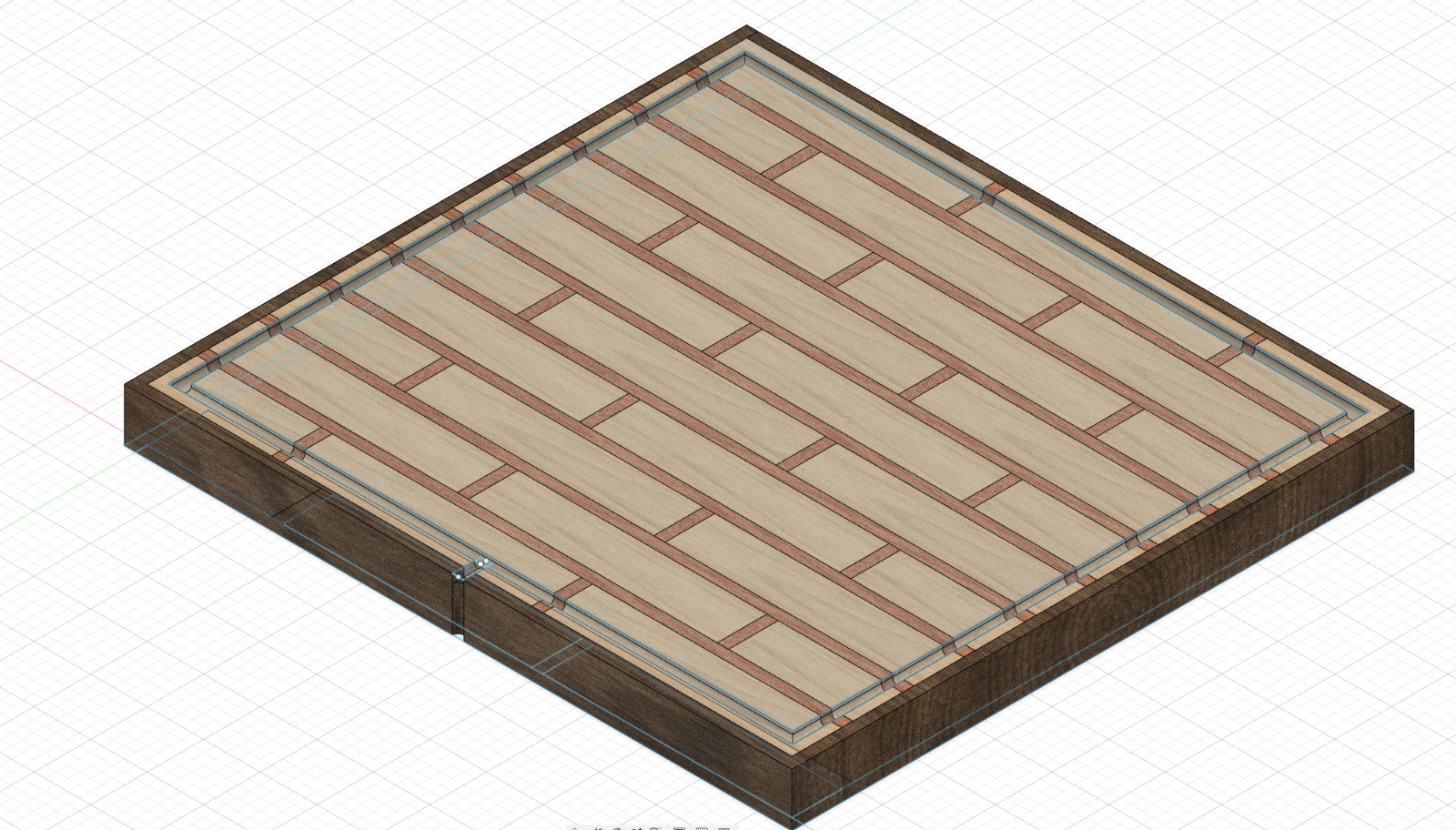

I would like to make a large Chopping Board / Butchers Block
Here are the current draft plans, for reference it’s about 570mm wide

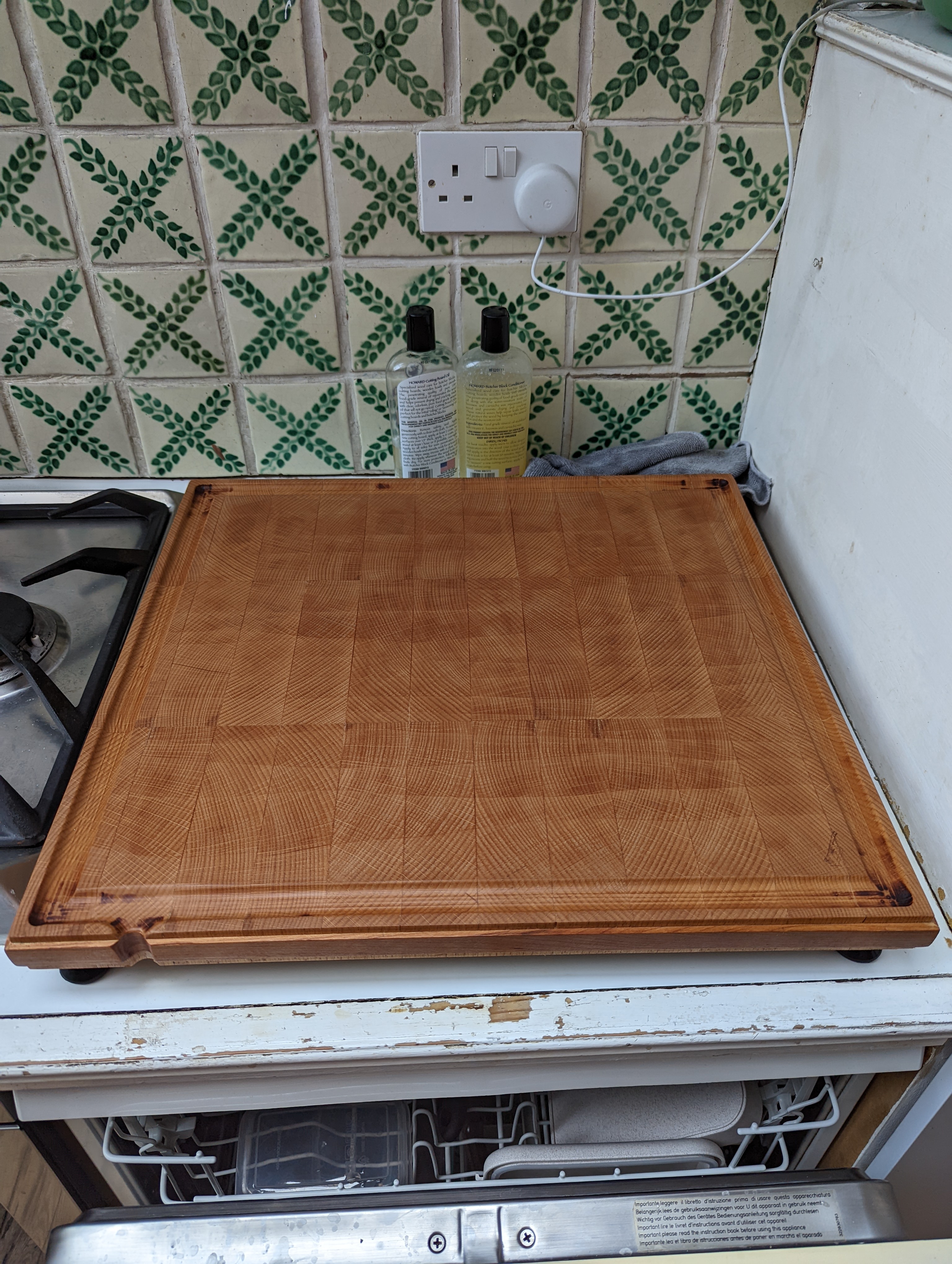

Thanks to everyone who helped. It wouldn’t have turned out half as nice without everyone’s help!!

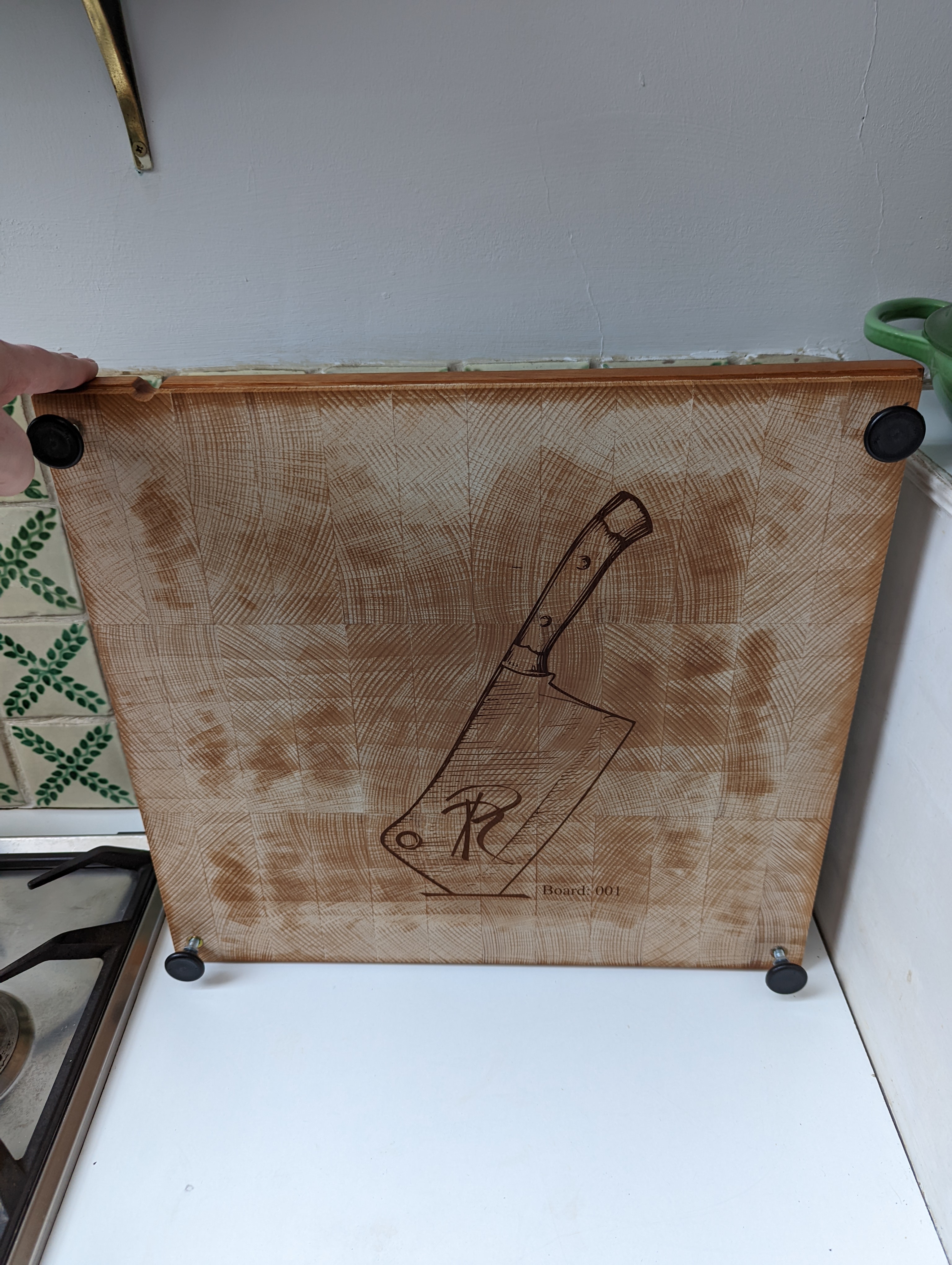

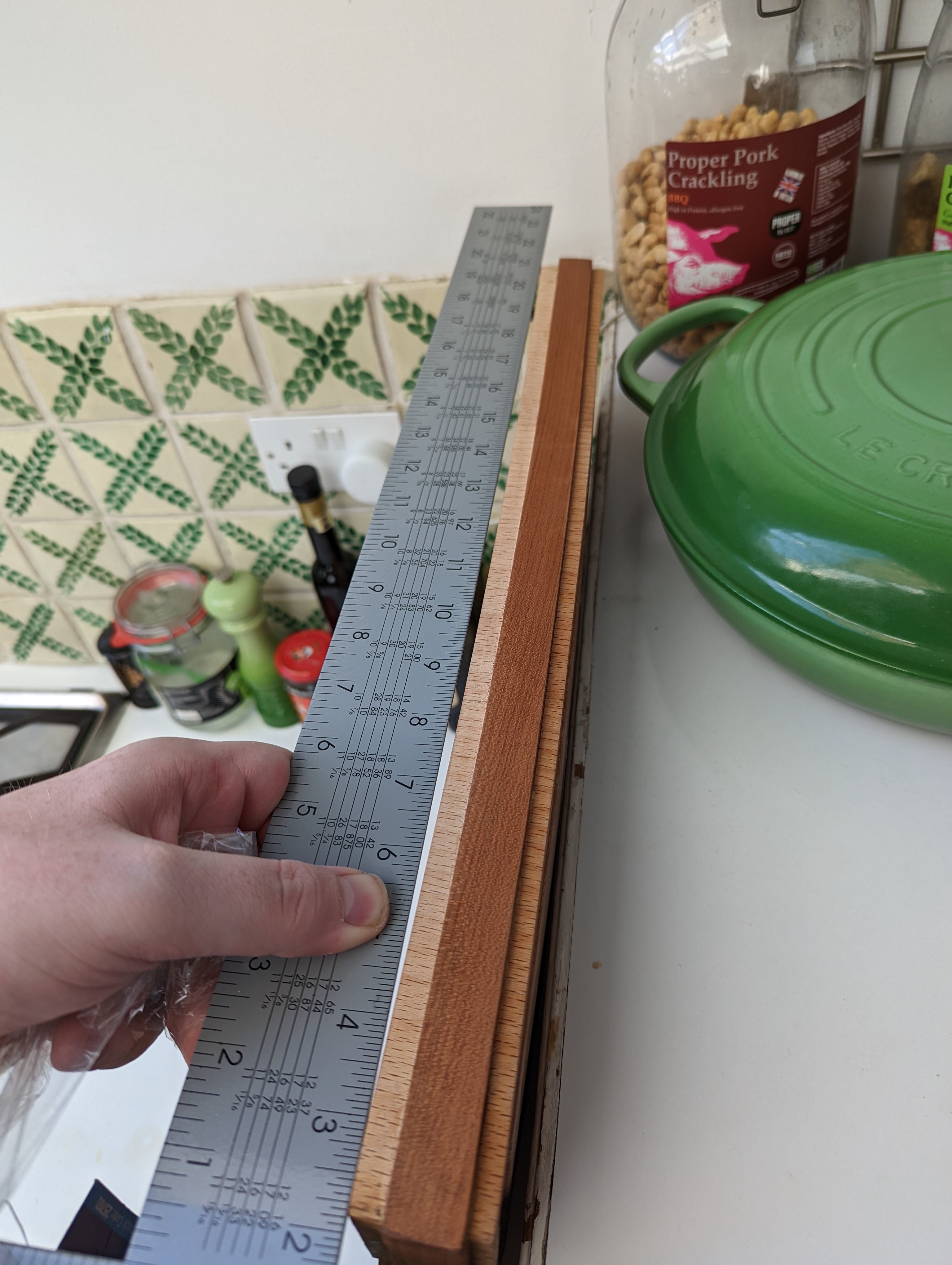

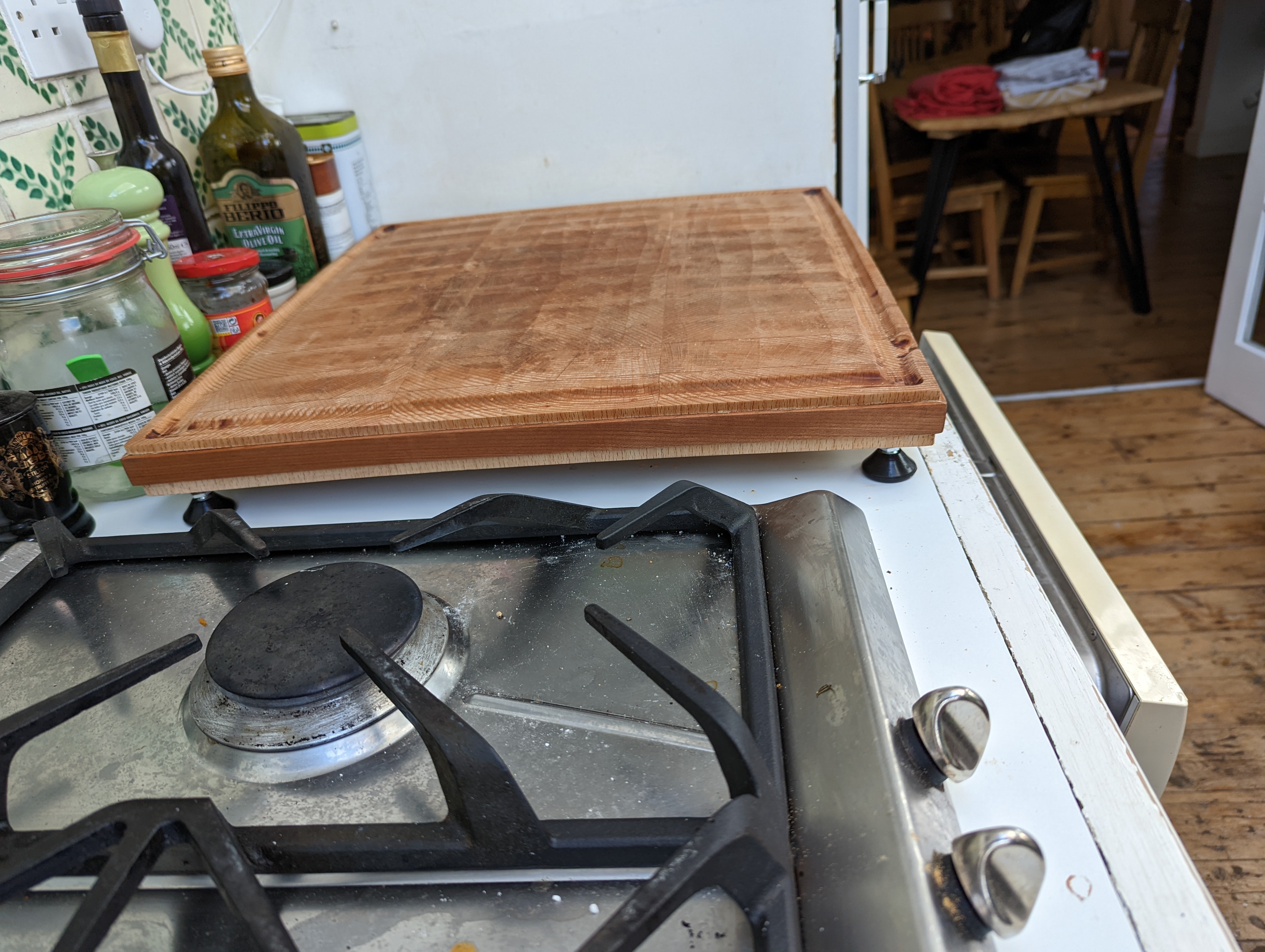

Does anyone have any idea why the warping would have happened?
total shot in the dark here as i don’t have enough experience.
But was the grain the same orientation when you made it cause i read that would cause warping like that.
The grain is pointing up and down
not too clear from your pictures, but is it bowing away from the legs? and is it bowing on all sides? ie highest point is the centre of the board(the side you cut on)
did you oil the bottom as well as the top? Finish on only one side can lead to warping
It’s effectively convex on the cutting side and concave on the underside
Only very lightly on the bottom. This appeared to be where the top got wet, however there were 5 coats on oil and 1 of wax so I thought it’de be Safe
It’s just your boards way of helping you clear out the juices from meat :slight_smile: I’d say if it isn’t too noticeable, you could live with it.
There are many reasons why this could happen. I haven’t made a cutting board, but read some forums and it could really be number of things. Were you cutting hot meat on the board and then it warped? You could try equalise the warp by applying a bit of moisture and heat to the reverse of the board. I’ve never done this, and wouldn’t know the pitfalls, but might work!
It actually has gone back to flat…
