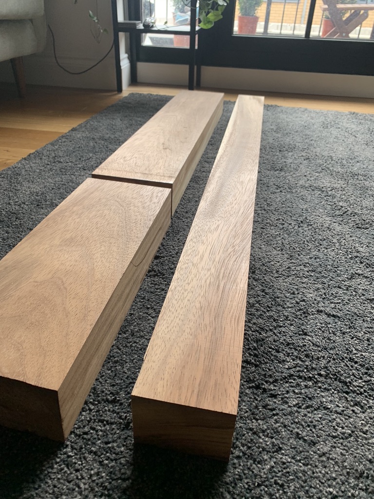

I would like to make a large Chopping Board / Butchers Block
After Sanding a wet it to raise some of the fibres ready to sand it again.
I used some gorilla glue that I had lieing around, clamped it for around a day.

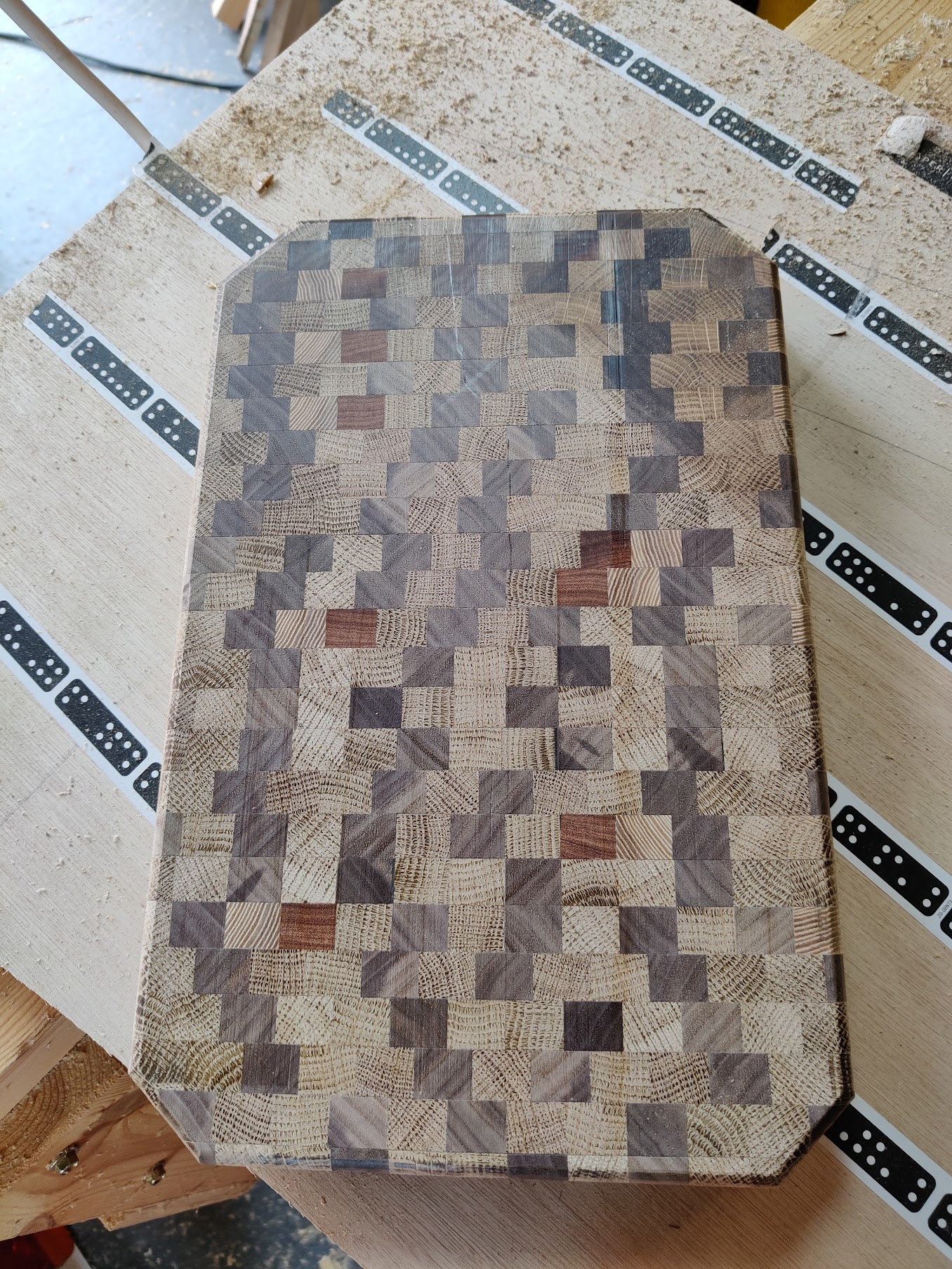

Updates on the butchers block chopping board.
My dad (for some totally different reason) bought an Axminister planer thicknesser a few months ago, so I ran the butcher block through it to see what had happened.

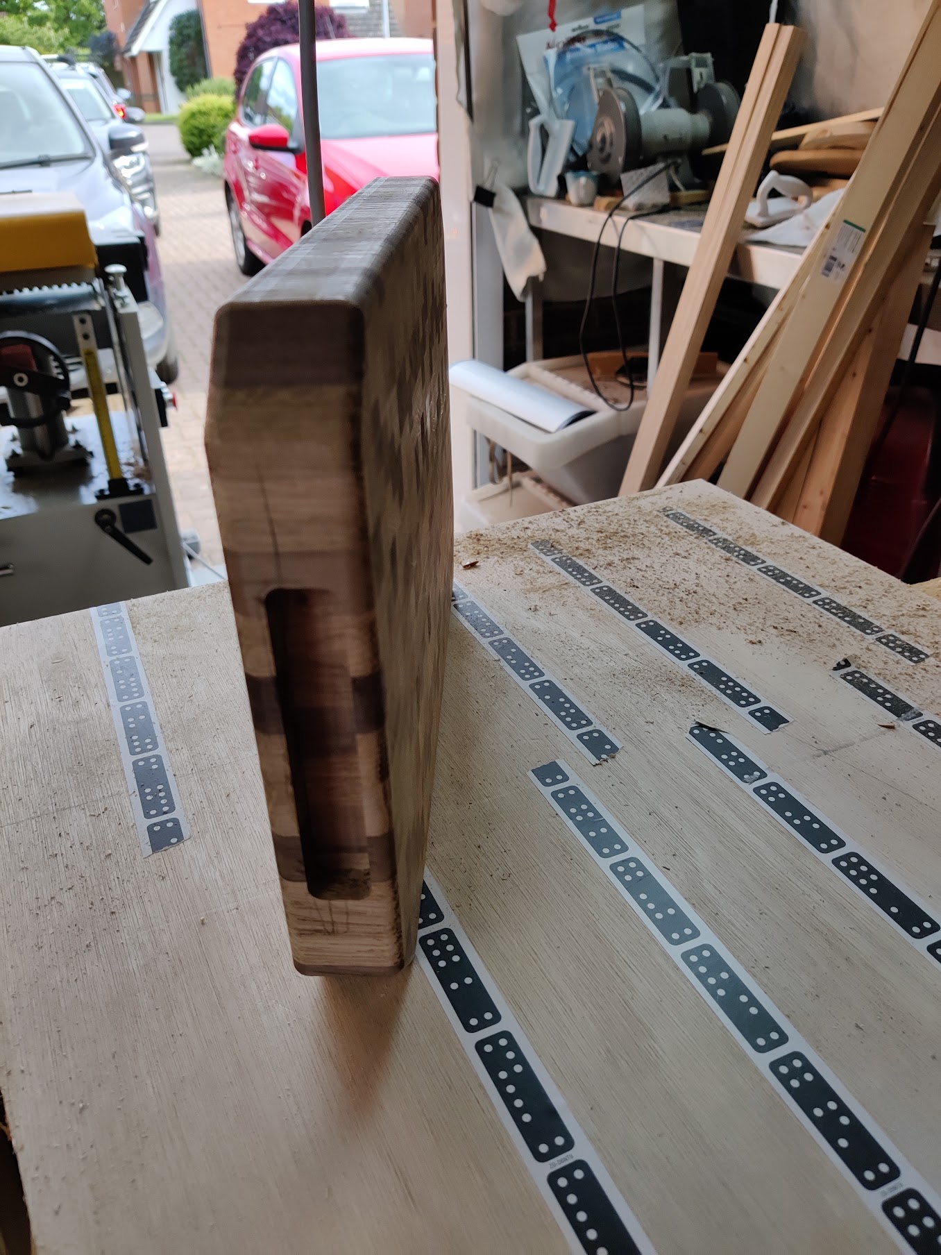

It didn’t deal with the end grain perfectly, but it was pretty good! Just did very small passes of 0.2-0.4mm at a time. It certainly started to catch and tear on the edges, but I got round this by routing round the chopping board with a roundover bit before passing it through the planer thicknesser.
He’s also bought one of these awesome CNC routers (https://www.shapertools.com/en-gb/origin/overview), which was so good to router the handholds in it.
Next thing to do is sanding seal and oil.
