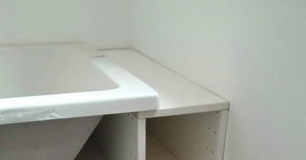

I’m looking at making a panel for the bath with some access to the space for storing cleaning products etc. There seem to be off the shelf solutions for full size bath but not a mini bath.
I was initially thinking a sliding drawer with push to open/soft close runners ala:
I used an IKEA drawer unit cut down to fit under the sloping end of the bath, and then neodymium magnets to hold an access panel on the rest of the length of the bath.
What could be neat (assuming there’s space), is using push catches like these mounted to a frame, so they’re fully extended when the panel’s closed. So then, you could click the panel in, slide it to one side, but still have it flush and somewhat hidden when you’re not using it.

The long panel is just held on with Neodymium magnets and the small panel is a cut down cupboard front. It’s held closed by the soft close mechanism on the drawer runners.
