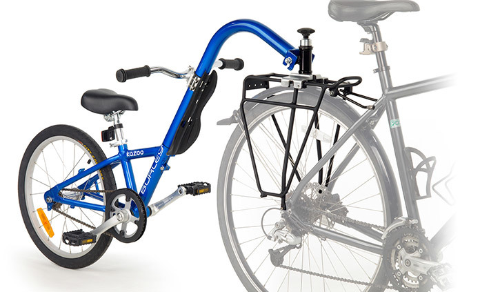

It’s perfectly feasible to push a bicycle with a powered trailer.
You can do this with the trailer connected to the seat post or to the rear wheel stays.
You can have the trailer powered by one wheel only. The weight of the batteries helps with traction of the powered trailer wheel.
If you want to share the trailer between different bikes the seat post connection may be easiest.
You also need to run a throttle to the handlebar but this is relatively easy to swap between bikes so 5-10 minutes work each time. Nothing else is needed to connect to the bike - just the trailer mount and the throttle cable.
This will then be a throttle only assist which may now be illegal in the UK as the law has changed recently. Making it pedal assist is easy enough but difficult if you want to swap between bikes.
