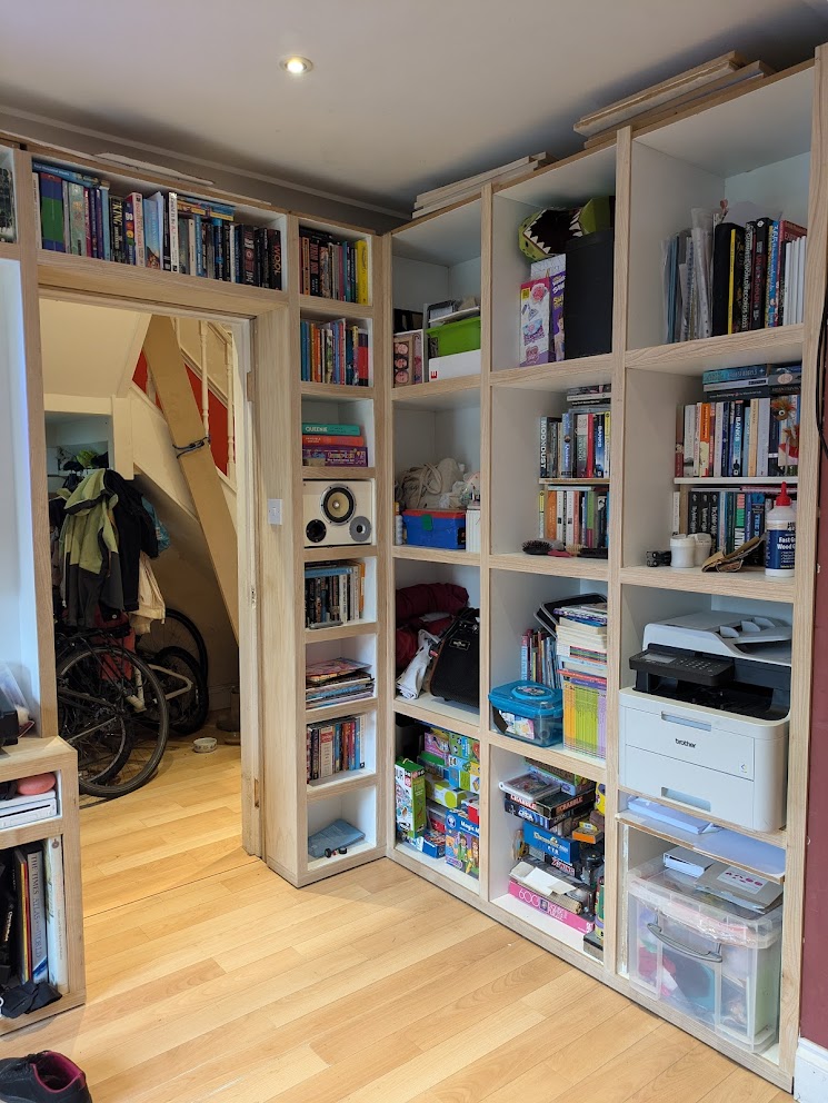

Got the TV wall finished today (apart from the top rail which will be the very last thing).
The door slides very nicely behind the TV, with soft close action and a home-made self closing mechanism involving bike brake cable, pulleys and a lead weight in a bit of drainpipe. On to the wall on the right next!

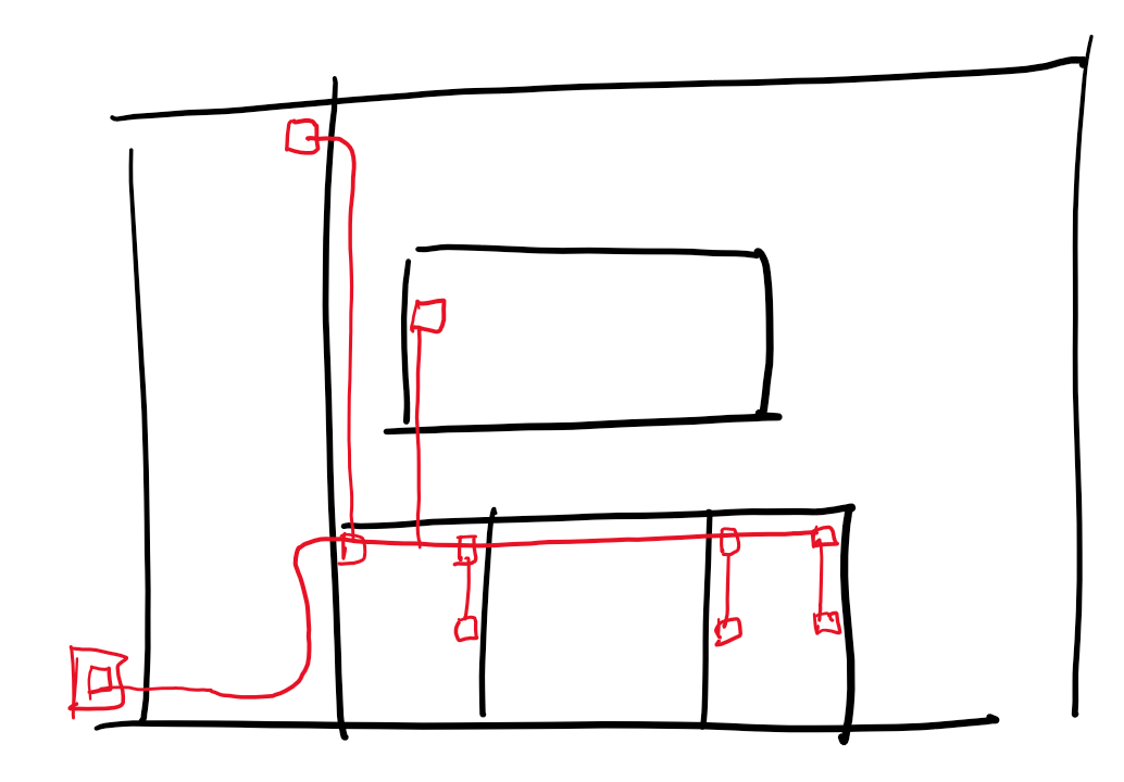

Hi Peter,
Thanks for the advice, although it’s all been wired up for over a year now with no complaints!
It’s all running as a 13A spur (you can see the socket with the grey cable bottom left). The sockets in the furniture are all single gang, and it’s a tree+branches topology something like:
Total load is no more than you’d expect running on a power strip behind a TV stand. All the cables are neatly routed and pinned, and all junctions are wago clips in boxes. There’s no power to the speaker shelves, although there are speaker wire terminals there. There’s power to the top left shelf for a VR sensor.
In the final condition I’m planning to replace the socket with a fused spur (with the junction box being accessible in the same location as the socket is now).

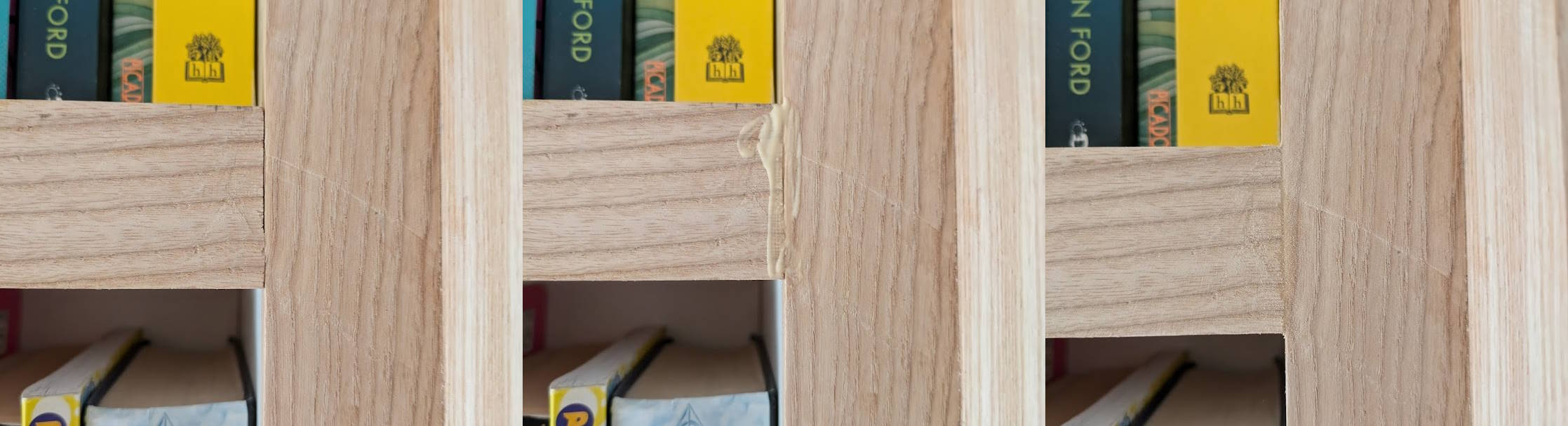

Phase two complete! It was a real backbreaker of a day cutting up all the MDF for this one, and somewhere along the line the table saw fence or stop block must have slipped because the widths of the carcassing ended up being +/- 3mm out in places. Something I only realised after I’d already glued the first row of boxes down and was stacking the second. >_<
To correct my mistake, I used the ash trim as a guide. Each horizontal piece is the same length so I used the chop saw to make them all identical. Then I could use clamps on all the vertical pieces to stretch/squash the box edges back into line. I nailed through the ash with panel pins to hold things in place, used a punch to push the nail head under the surface, then glued little slivers of wood back in on top. I managed to match the grain almost everywhere.
I found some acrylic paint in the kids craft box with an excellent colour match so did the whole “paint the crack and sand it while wet” trick to hide the joins. I’m leaving a final sanding and oiling till the whole room’s done, to get a consistent finish.
