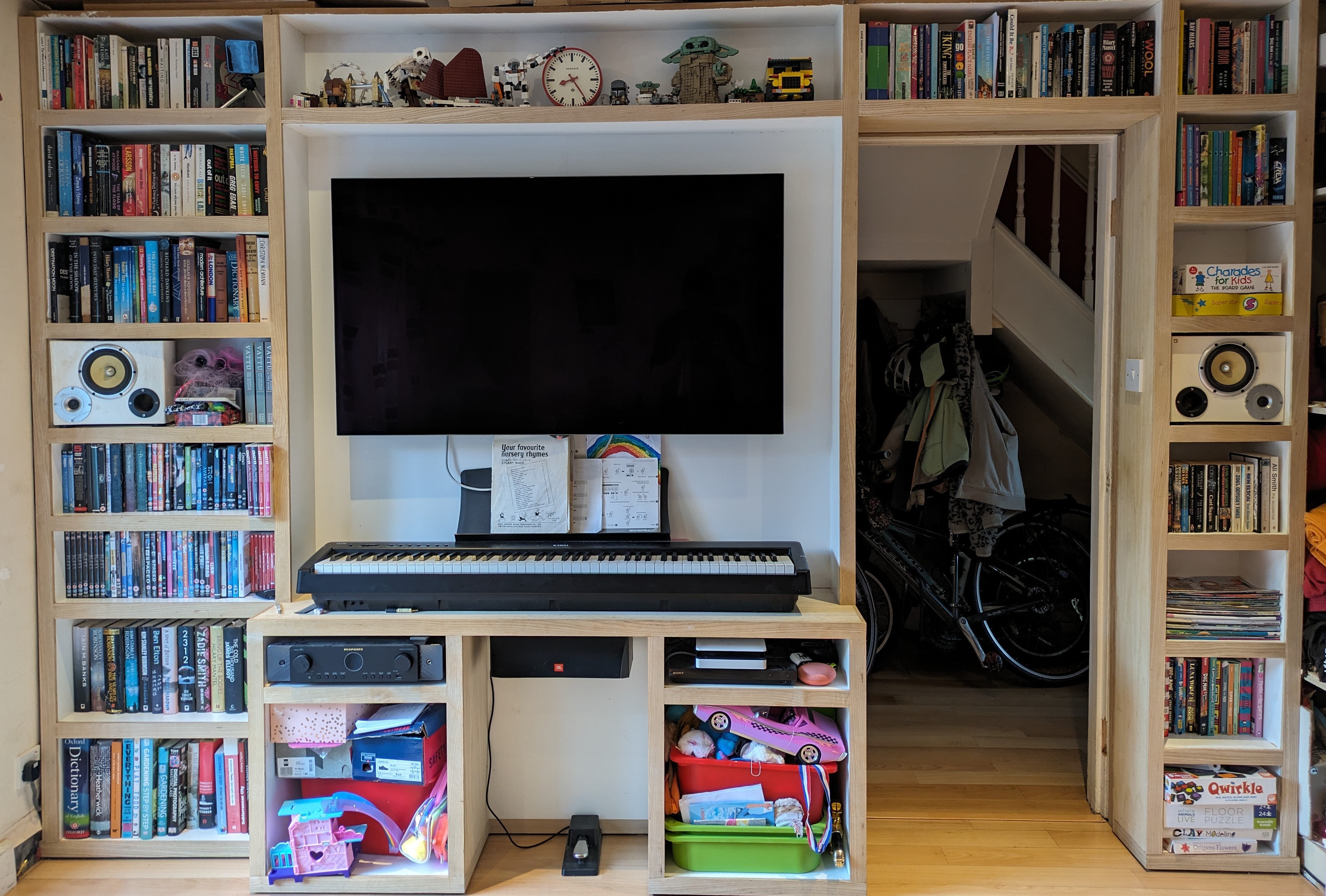

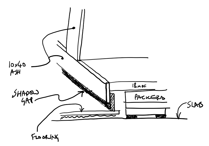

I literally just did this at home. Used the “stack of packers and scraps” method, with each stack under the landing point of the shelf boxes above. I’m putting 40mm strips of ash on the front of the joints between boxes, then also along the edge of the plinth with a shadow gap to hide any irregularities in the floor.
