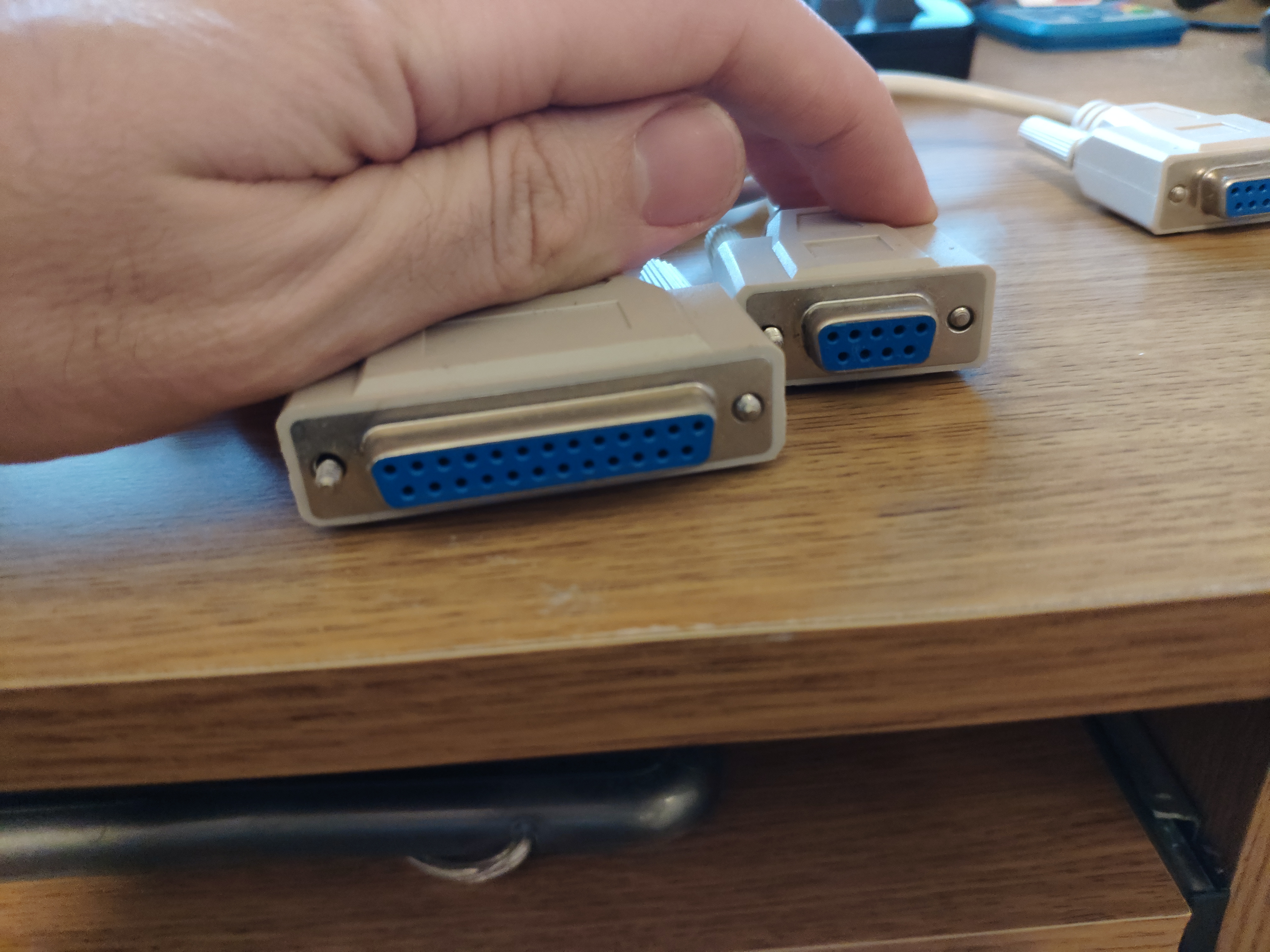

@RobertL we would like to try another F-F null modem serial cable if you have one! Pop it in the blue box of CNC parts on top of the machine, that would be amazing! Thanks!

Hey @RobertL did you get a chance to look for the cable? I may buy one if it’s still required so we can get back onto the testing…
