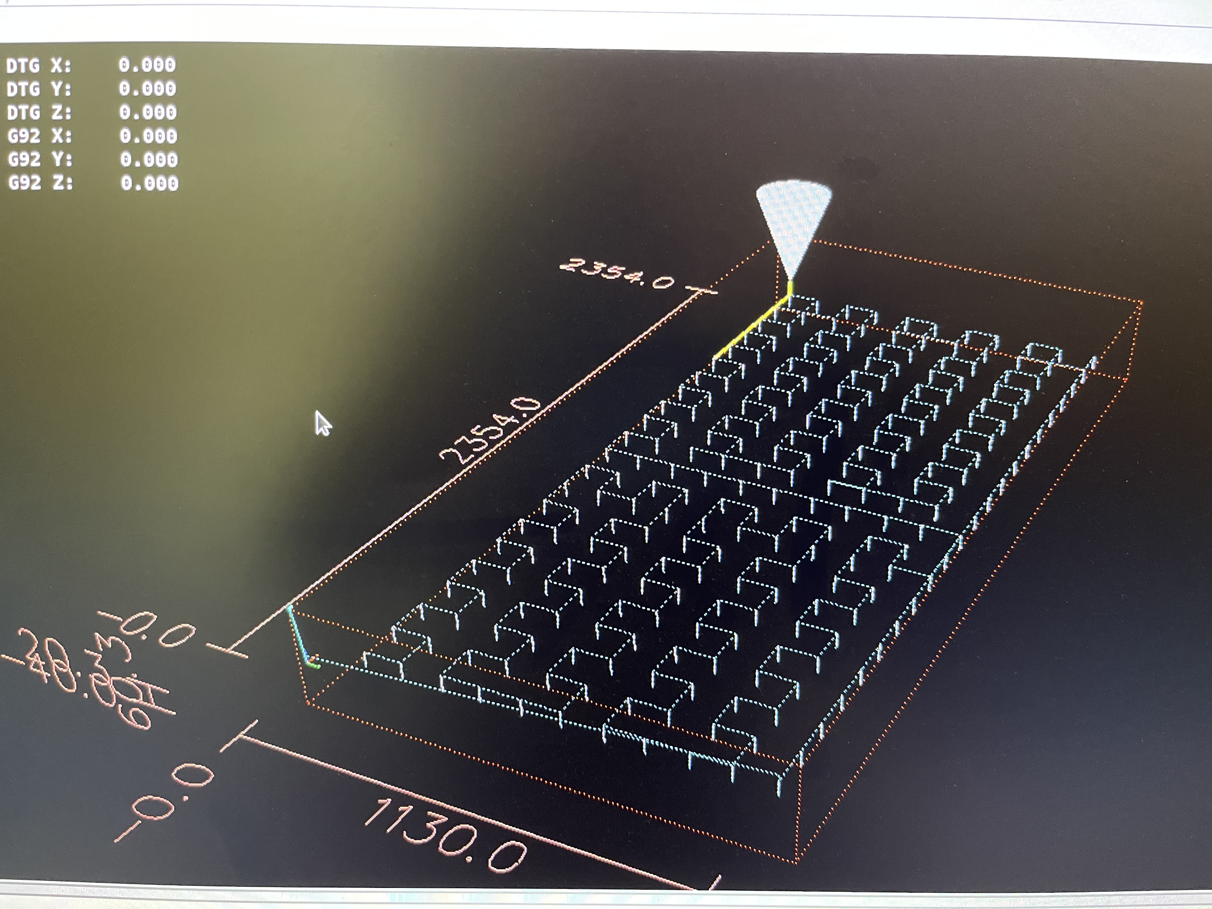

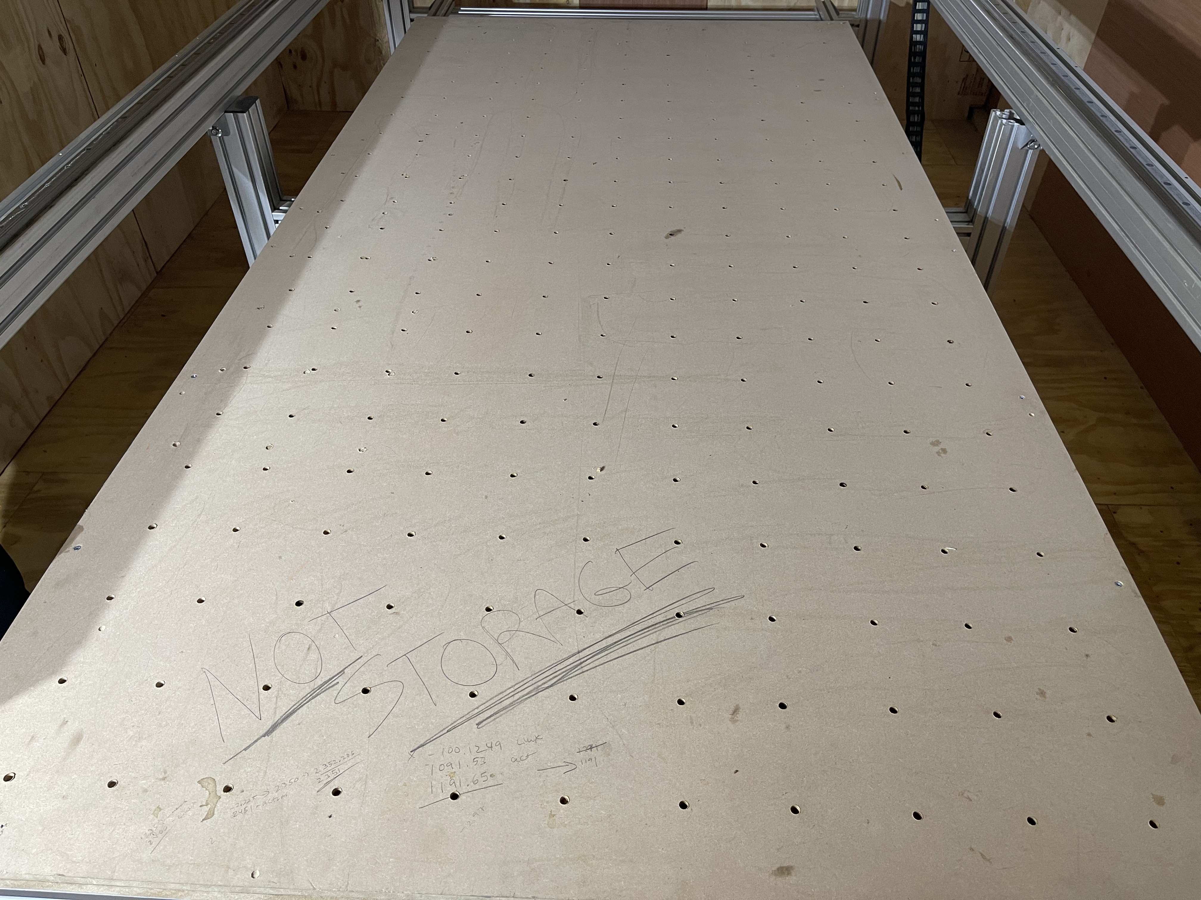

Why not just drill them with CNC? If I understand correctly they’re about 9mm holes (m6 insert?) so should be fast. And it’s repeatable. And easy to keep a drill bit just for this purpose.
Yeah that is the plan! We have some new mills on order to do it…
edit - read too fast - Milling is the plan…

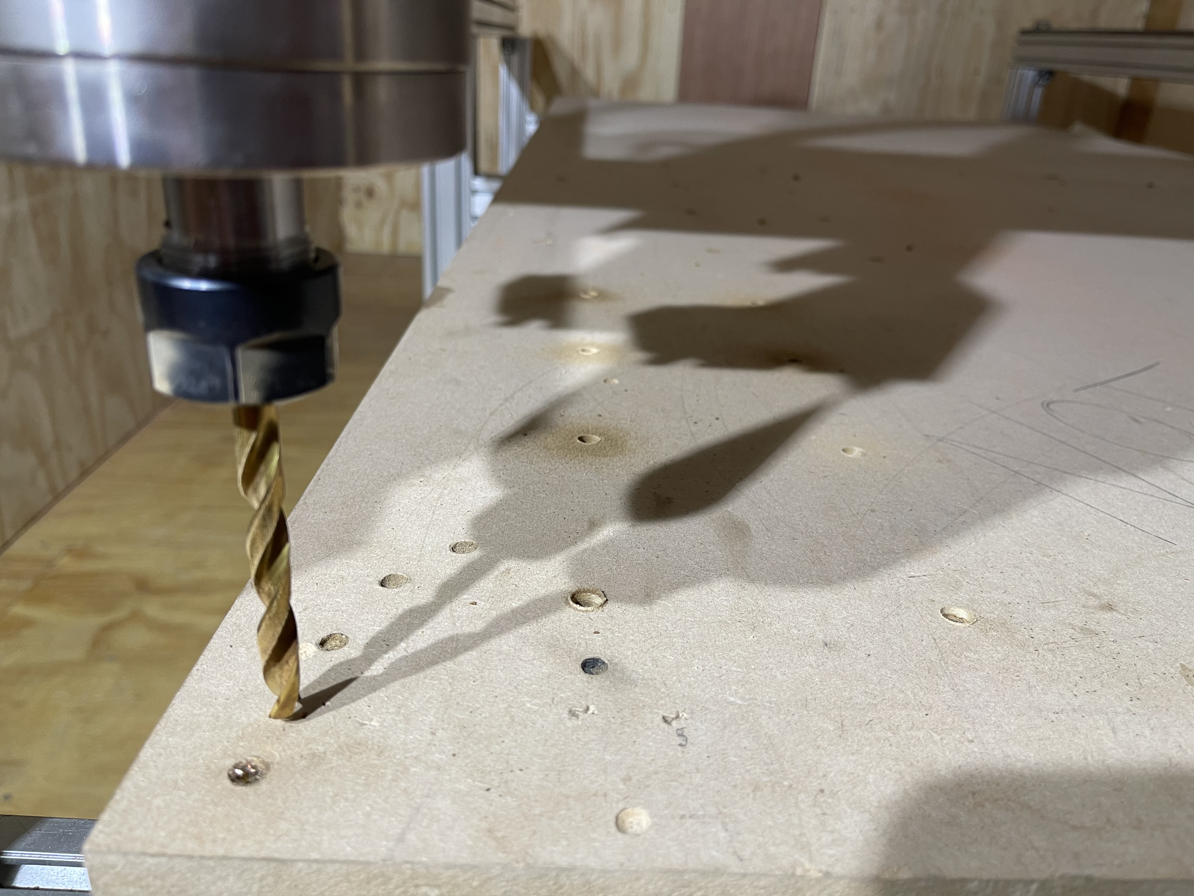

Drill bits need to go slower - the slowest the spindle goes is 7500 RPM… the drill bit gets super hot at this speed…

Ah that’s a pity, no way to reduce spindle speed further?
7k rpm is high for 9mm and will make plenty heat, but some thoughts - did you try high feed rate which would reduce heat? Also peck drilling. Just thinking some ideas as it sounds like an awkward issue!
Yea, we have been testing out faster feed rates, should be close to finalising that, might be worth testing drilling after that…
Ok! Good progress tonight!

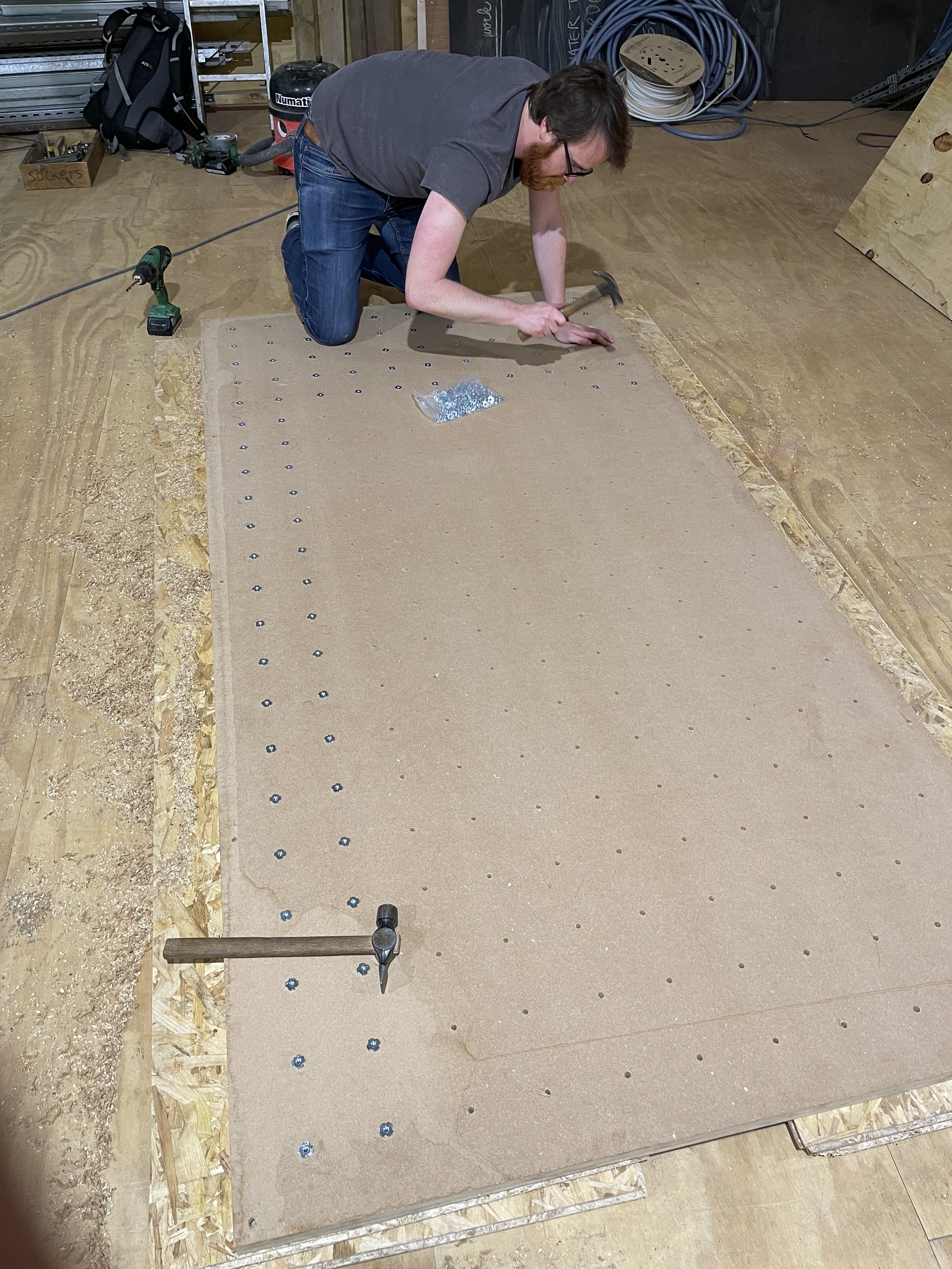

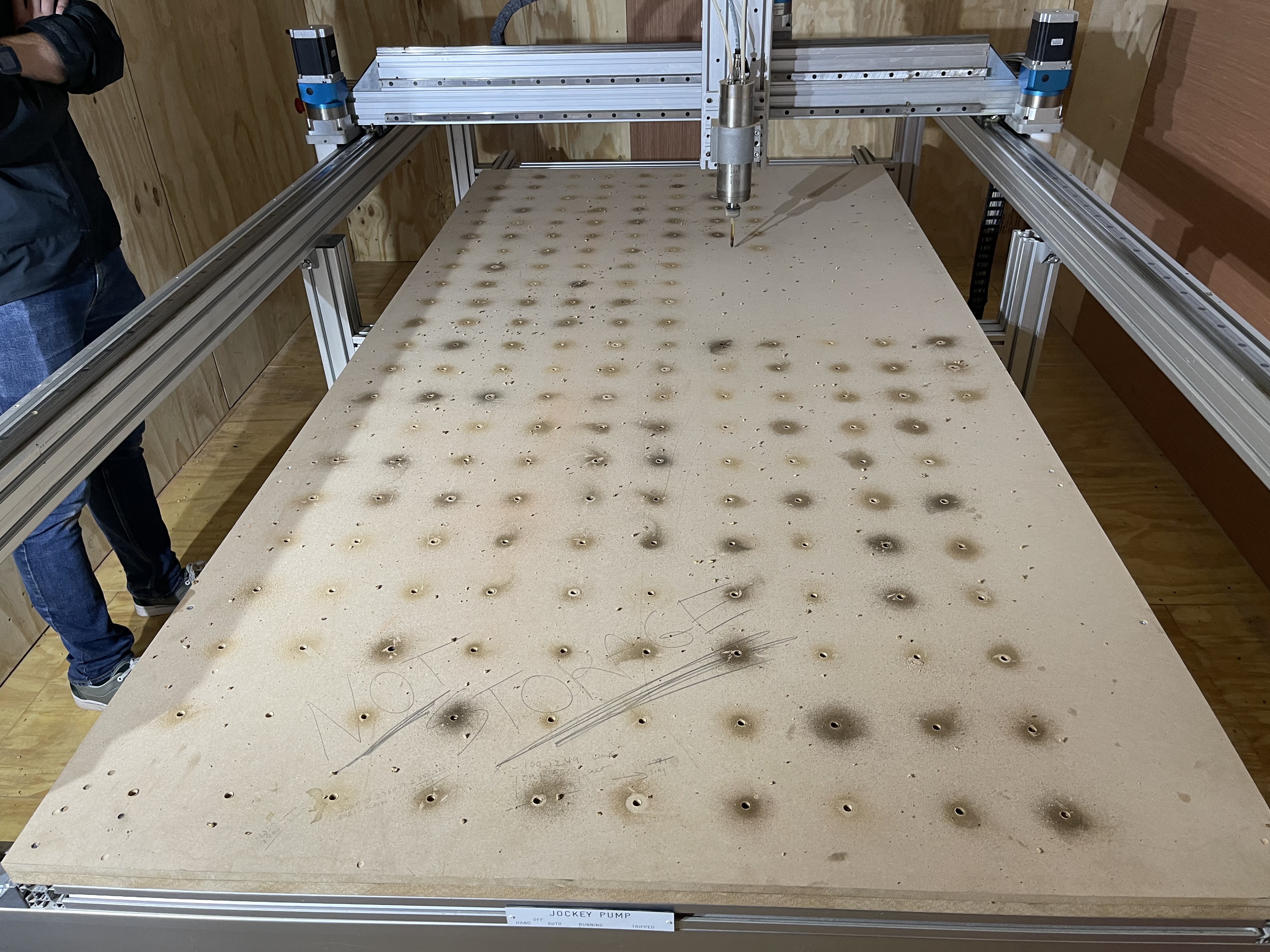

Spoil board has holes! Need to drill them through fully, and mount the nuts in the back, but getting close!
Drilling is not great because the spindle is too fast, but it worked well enough and is easily repeated when we need to change out the top spoil board…

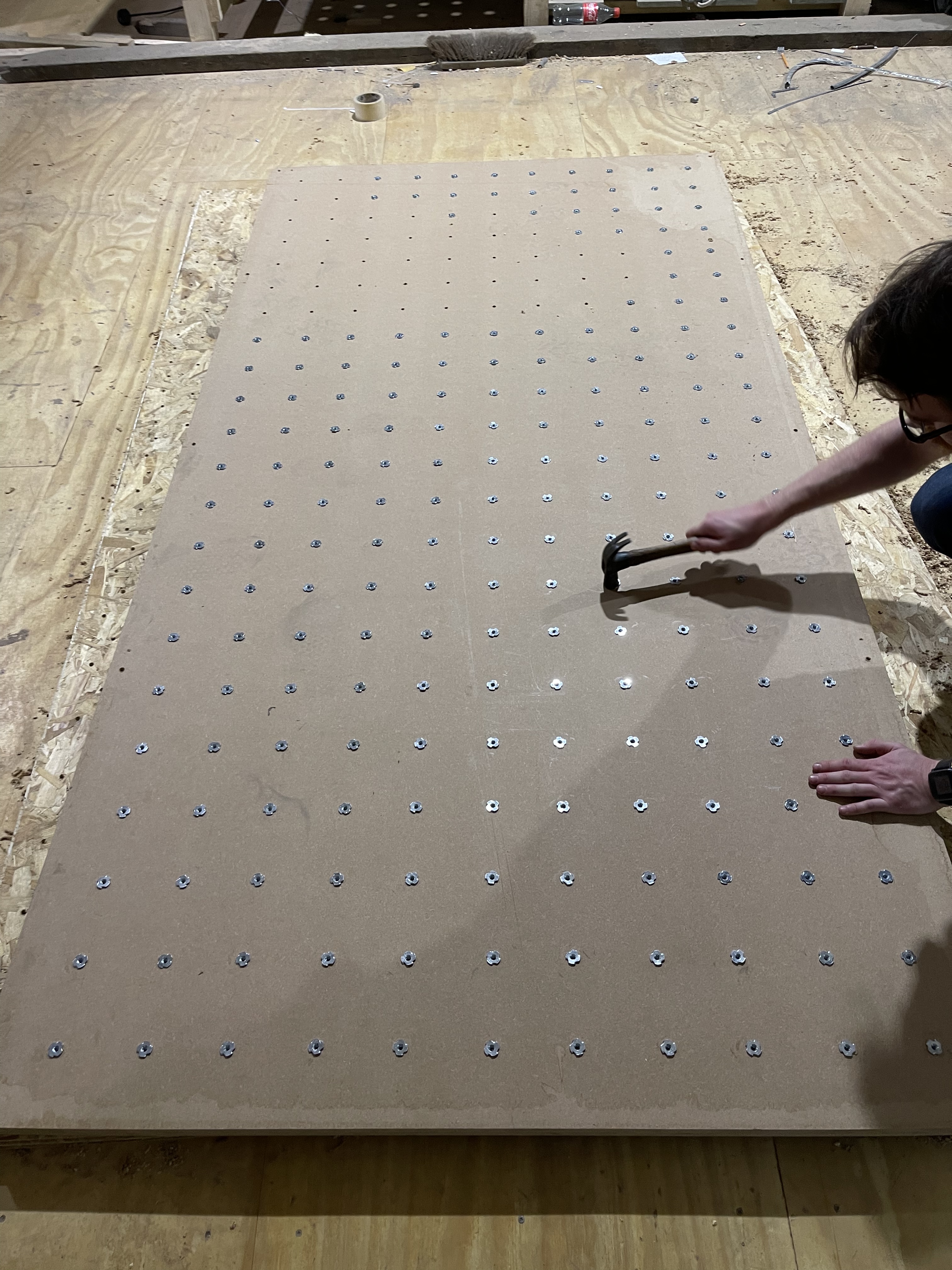

Holes go all the way through! And the hold down nuts are going in!

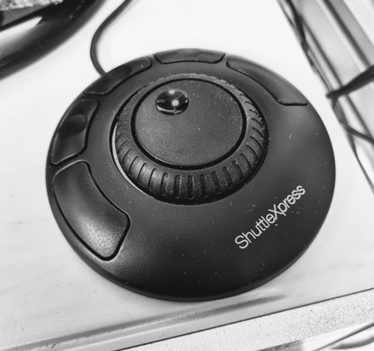

Jog wheel pendant now works:
