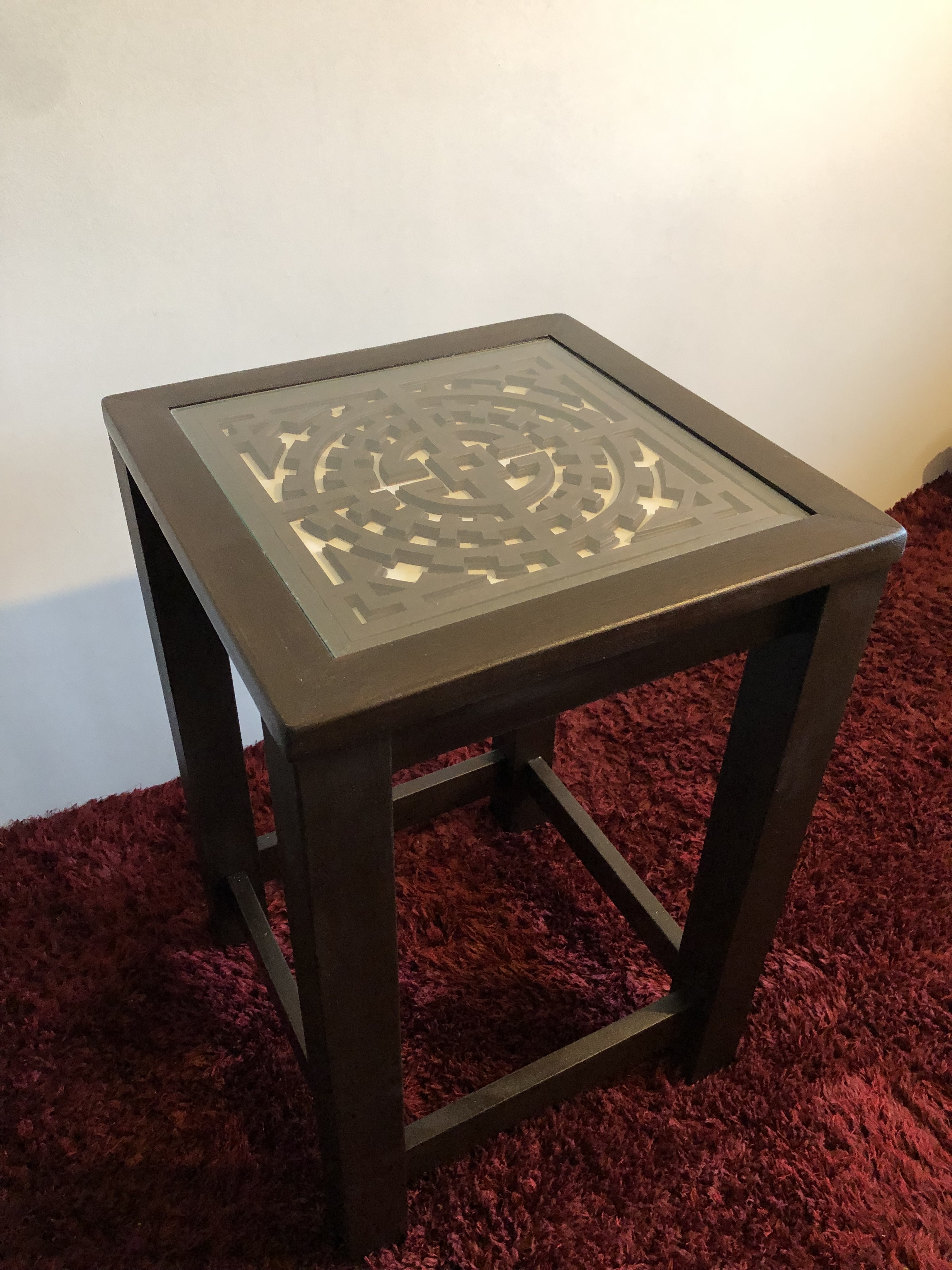

Finally finished those little side tables with the LED lightbox inserts… only took almost a year!
Lessons Learned:
Be more selective with heart/sap wood as I ended up just staining to walnut/dark oak to hide the wood variations, effectively hiding a lot of the grain
Plan the power pack housing in advance and laser cut it to avoid final ‘botch’ to add to underside of the lightbox - rushed the final stages a bit
More practice with the router / router table - plenty of tear out through lack of experience/knowledge
Learn more about setting up of bandsaw to avoid blade movement which created some dodgy tenons
Use better lighting for photos
many more…

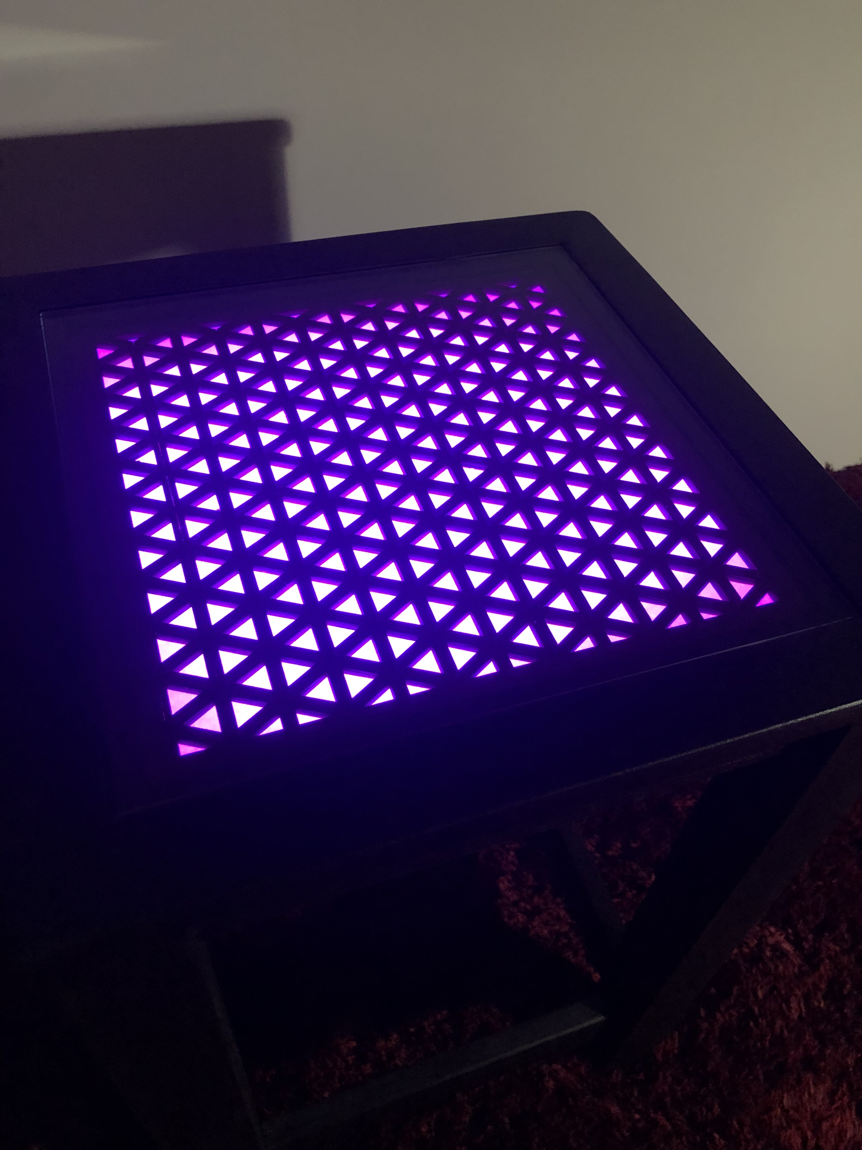

Anyway, here are some photos… (apologies for the lighting and blur on the dark photos, the backlit LED stuff looks much better in person, honest )
Thanks! some of the colours are a bit intense and on the strobe or slow-fade settings they get a bit disco but they look good as ambient light in a room
