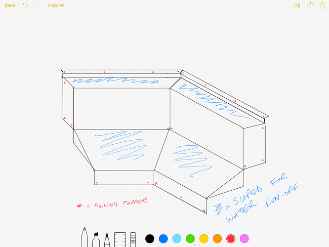

I’m looking for some guidance concerning a waterproof cover I wish to make for my corner bench. I’d like to know what the best material would be and how best to go about achieving my aim.
I’m looking to buy some waterproof material and cut and stitch a bespoke cover for my corner bench. I’d like to sew in some sort of fasteners (poppers, or the like). I’d also like to try and follow the contours of the bench, so the cover fits over it snugly as opposed to fitting over it as a ‘box’ if that makes sense? Best way I can describe what I mean is when you have a car cover that is essentially car shaped with recesses for wing mirrors etc. I want the cover to be ‘L’ shaped and to originate on top of the bench, attaching to the bottom slat of the fence, then come down the seat backs, turning along the bench seat itself and then hanging over the edge of the seat where it’ll be fastened down. I assume each change of direction witll need a seam sewn in order to make this possible?
I’ve posted a pic for reference. I understand this is something that’ll probably be best discussed in person, so if anyone is around over the next week I can pop down if you’ll allow me to pick your brains.
You’re right about the seams and changing direction. Although large, it is probably quite a simple pattern of rectangles and L shapes. Think of it like a net and brake it down into these basic shapes. Take the measurements and add a bit for wiggle room to get it on and a seam allowance. Do you want the poppers going up the side so you can close it around the bench? I think you are saying that you just want it covering the front, the back can get wet.
Precisely - want the awning poppers to fasten the cover up around the sides, along the top and down below the seat (there the backs of your knees are when seated). The back of the bench doesn’t need a cover.

So with regard to the seams you can either stitch them and then tape over the stitching with a special heat seal tape or you can do felled seams. There are good instructions here: https://themakersatelier.com/journal/sewing-waterproof-fabrics
Your pattern looks good. I’ve never seen the sloping thing before, I guess if it all pulled taught with no slack it might work, otherwise that is extra space for the water to pool. To that ends you might need more than the one popper on the side triangles. For what its worth I think it would work just as well without the slope if your seat is level. What kind of fabric were you thinking of using?
And Beth has a good point on minimising the no of seams - personally I’d put the seams vertically wherever possible and use folds for horizontals - to minimise the amount of water flowing down that has to cross a seam.

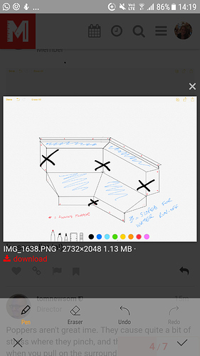

@tomnewsom perfect. Was thinking of eyelets and hooks, but those look ideal.
@Beth If I used the fasteners tom mentioned, then I could pull it taught and have the slope to allow better drainage. I’m looking at using some form of waterproof canvass or pvu. Whatever is most durable for the price. The little triangles at the side are not a necessity. They may be swapped out for a really small lip that sits over the decking of the raised beds.
