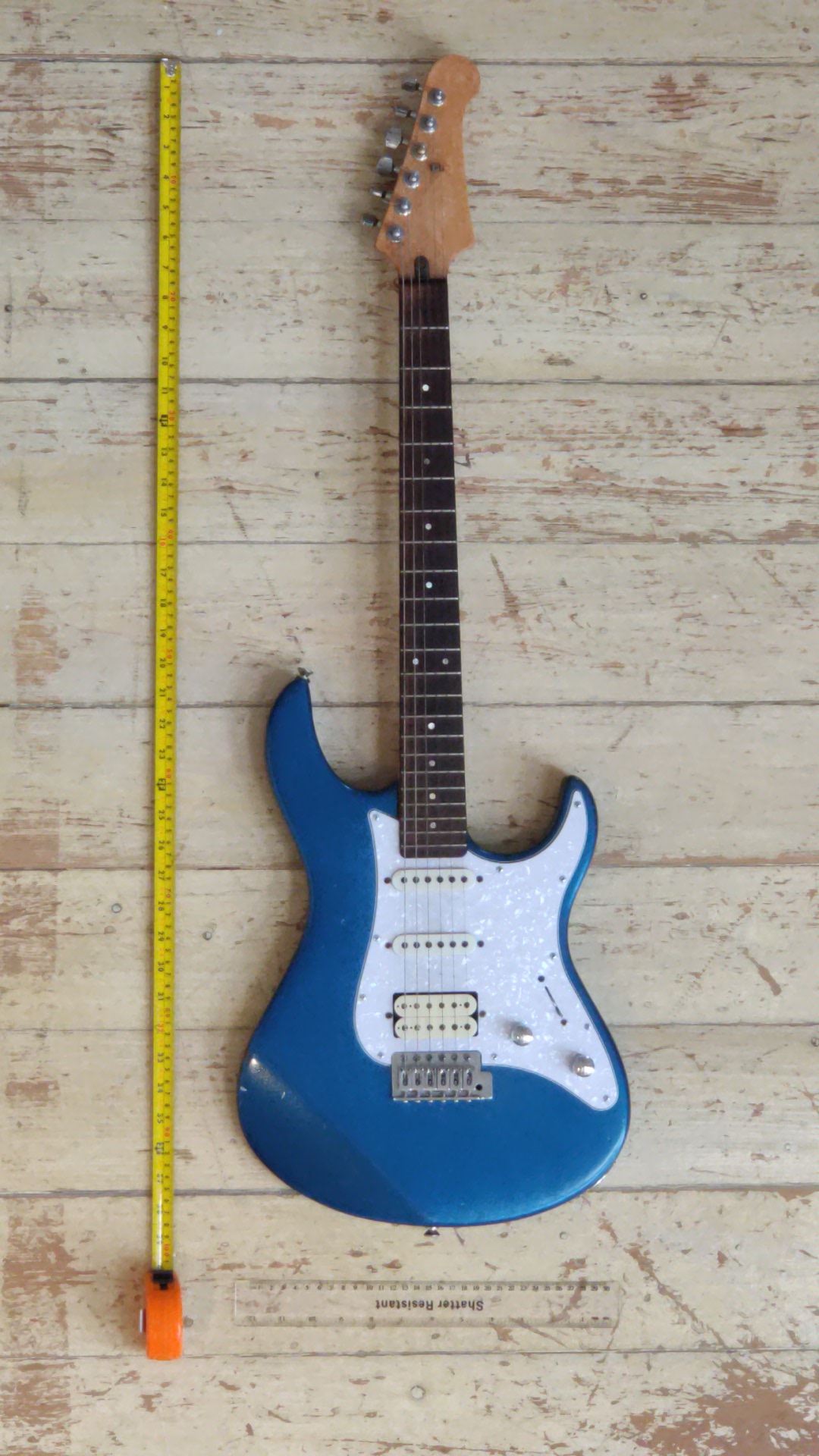

Hi all, I’m doing up an old Yamaha Pacifica that I bought on eBay for about £35. I’ve got another of these and it might be one of my favourite guitars to play.
I’ll use this thread as a project update track where I’ll share my progress and hopefully inspire other people to do the same!
Here’s my start point:
It doesn’t look so bad from far away but it’s in a bit of a rough shape. Paint work shabby, electronics in a state, rusty screws, not particularly playable I’d say.
I don’t have an end goal per se but I’m going to keep making tweaks until I’m happy with it, then it’ll hopefully be my main gig guitar for my tribite band Catfishing the Bottlemen.

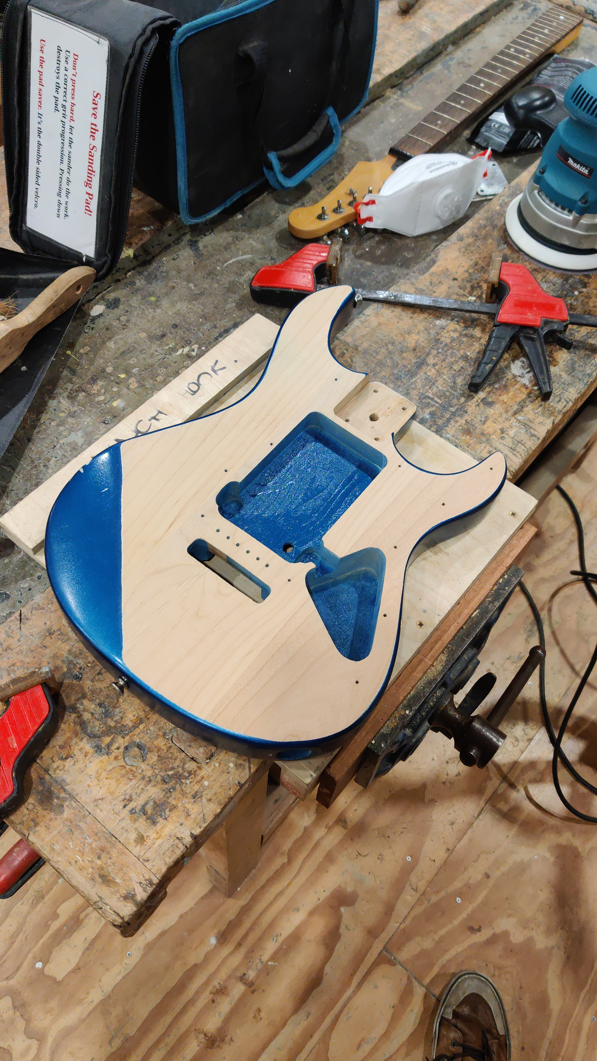

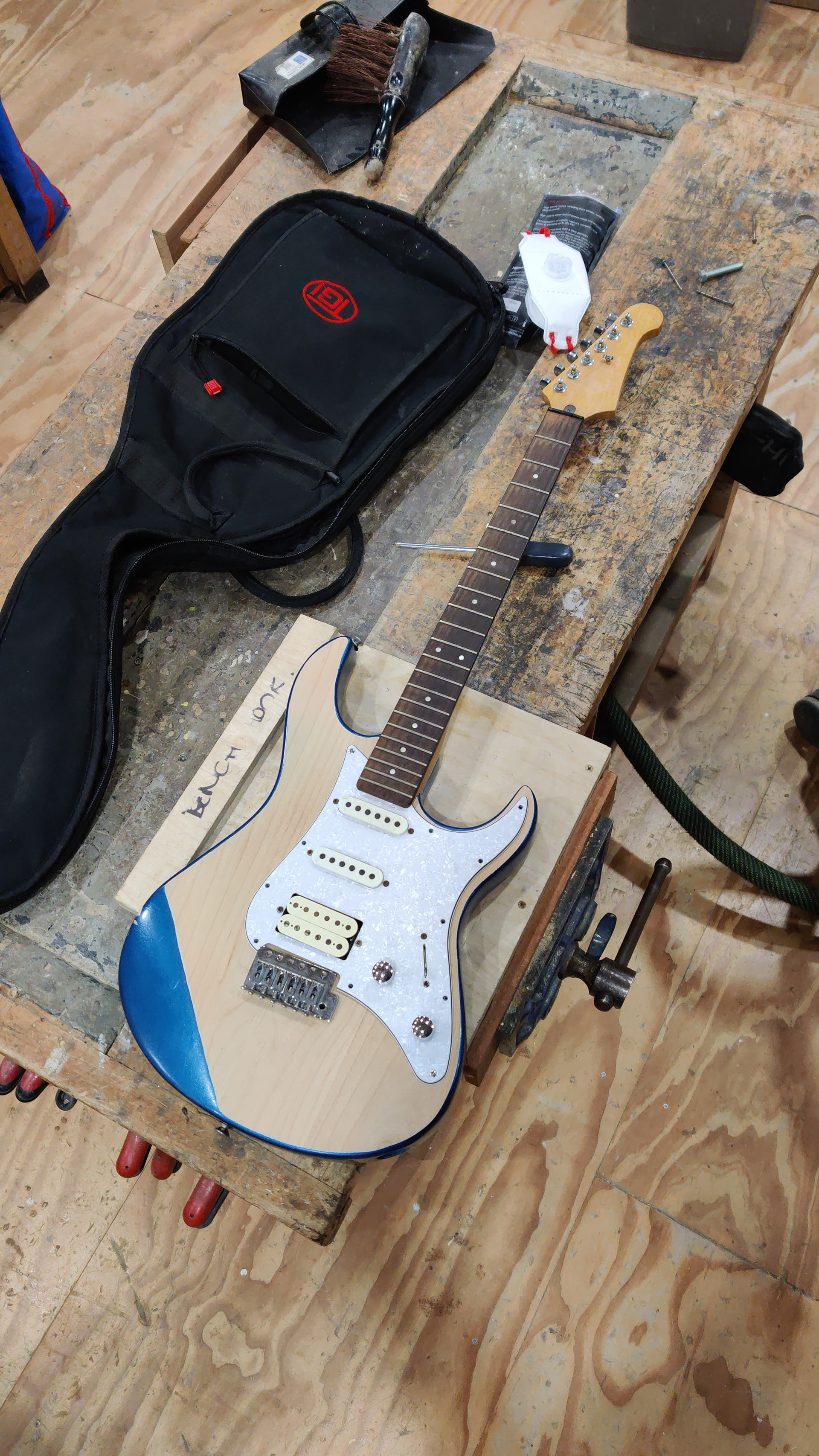

Did my woodshop induction today (thanks @BozTM) and got straight to it sanding down the blue paint with the orbital sander.
On my other guitar I just sanded the flat surfaces and left the sides and curved parts alone. Quite like the way it turned out here so I might keep it the same.
I was thinking all black beforehand but we’ll see. Looks kinda cool with the pickguard back on but I’ve still plenty modifications to go.

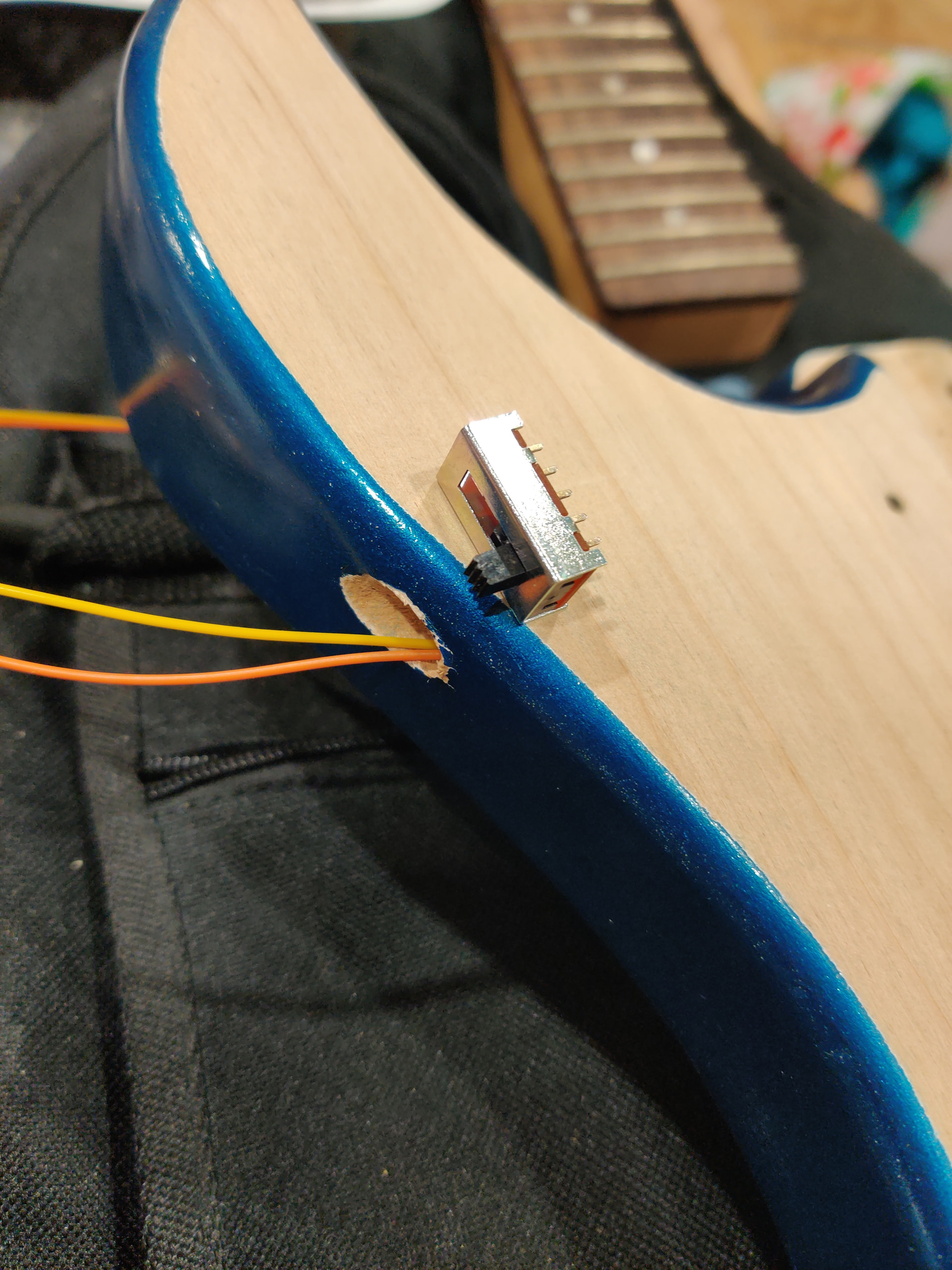

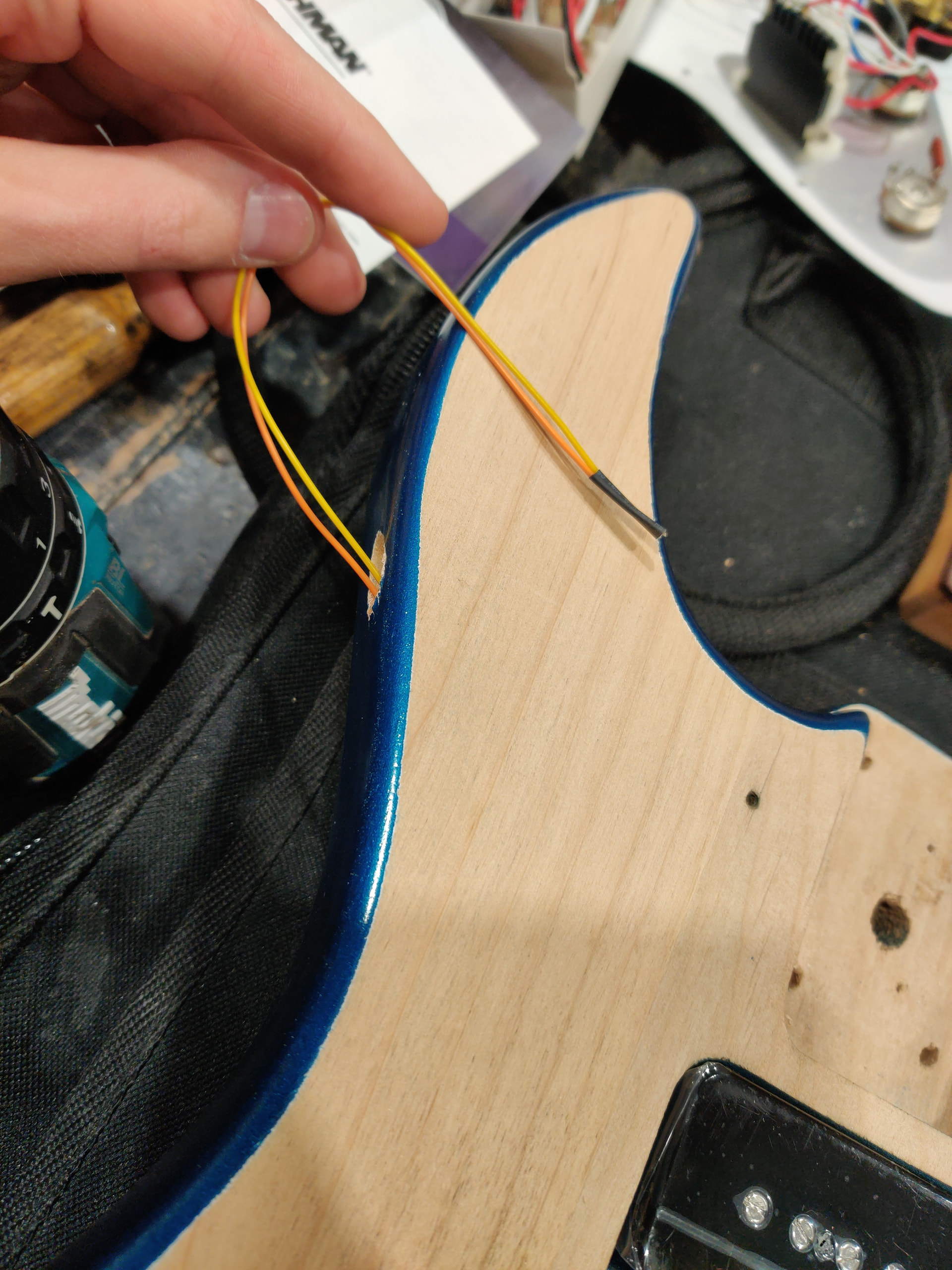

Update! I bought some Fishman Fluence Greg Koch P90s a little while ago for this build and most recently made a little progress on installing them.
They’re active pickups and come with some options for varying the tone settings. I decided I wanted to build my own switching system for them so I went about making the necessary notifications.

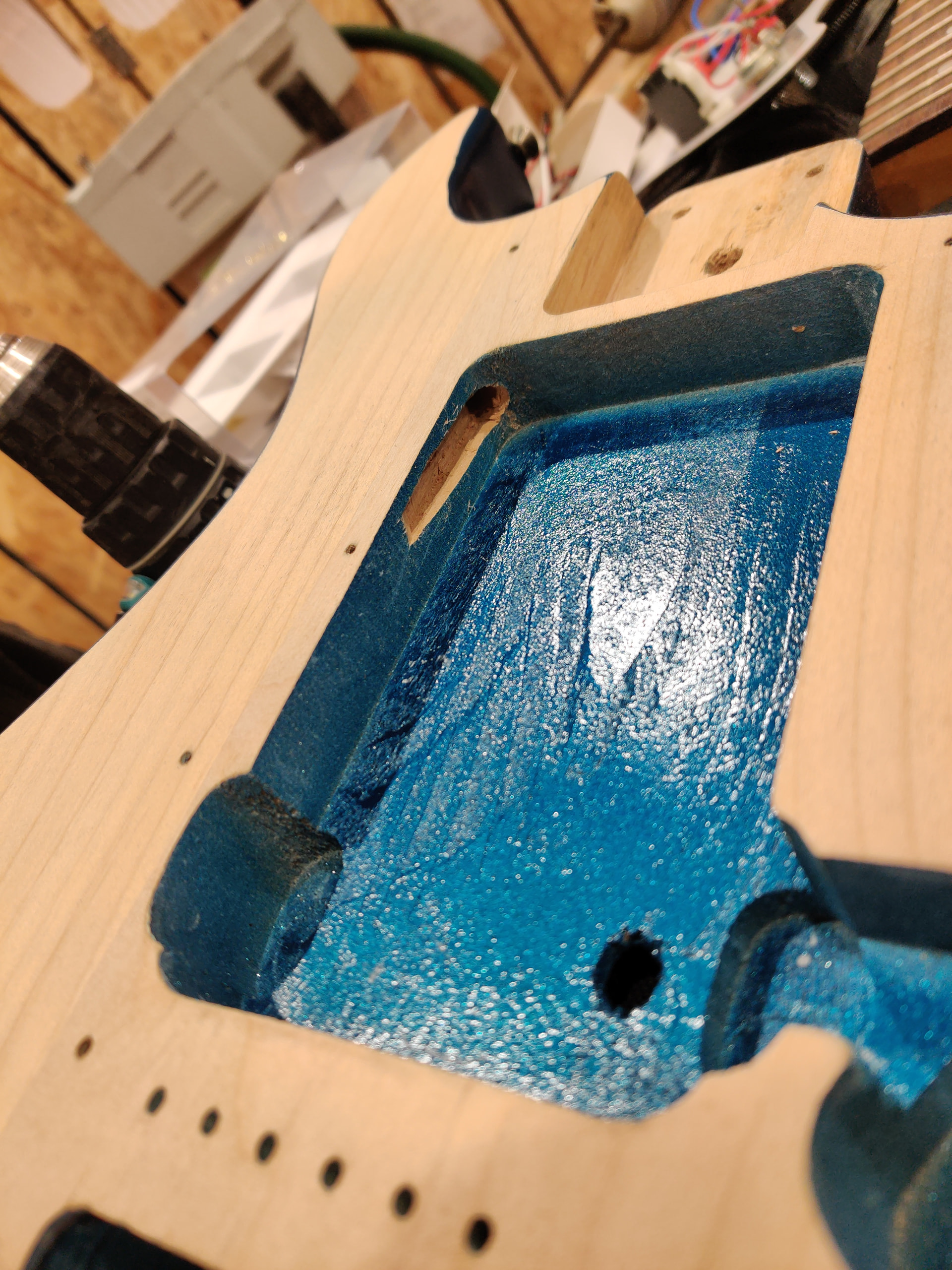

I wanted the switches facing me on the upper horn so I found an auger drill bit that was long enough to get through to the pickup cavity, googled what an auger bit is actually for (had never seen one before) and prepared to make the hole!

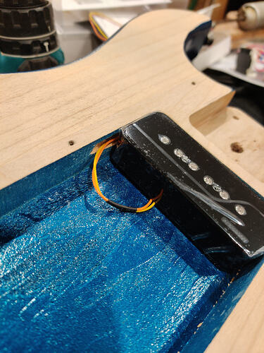

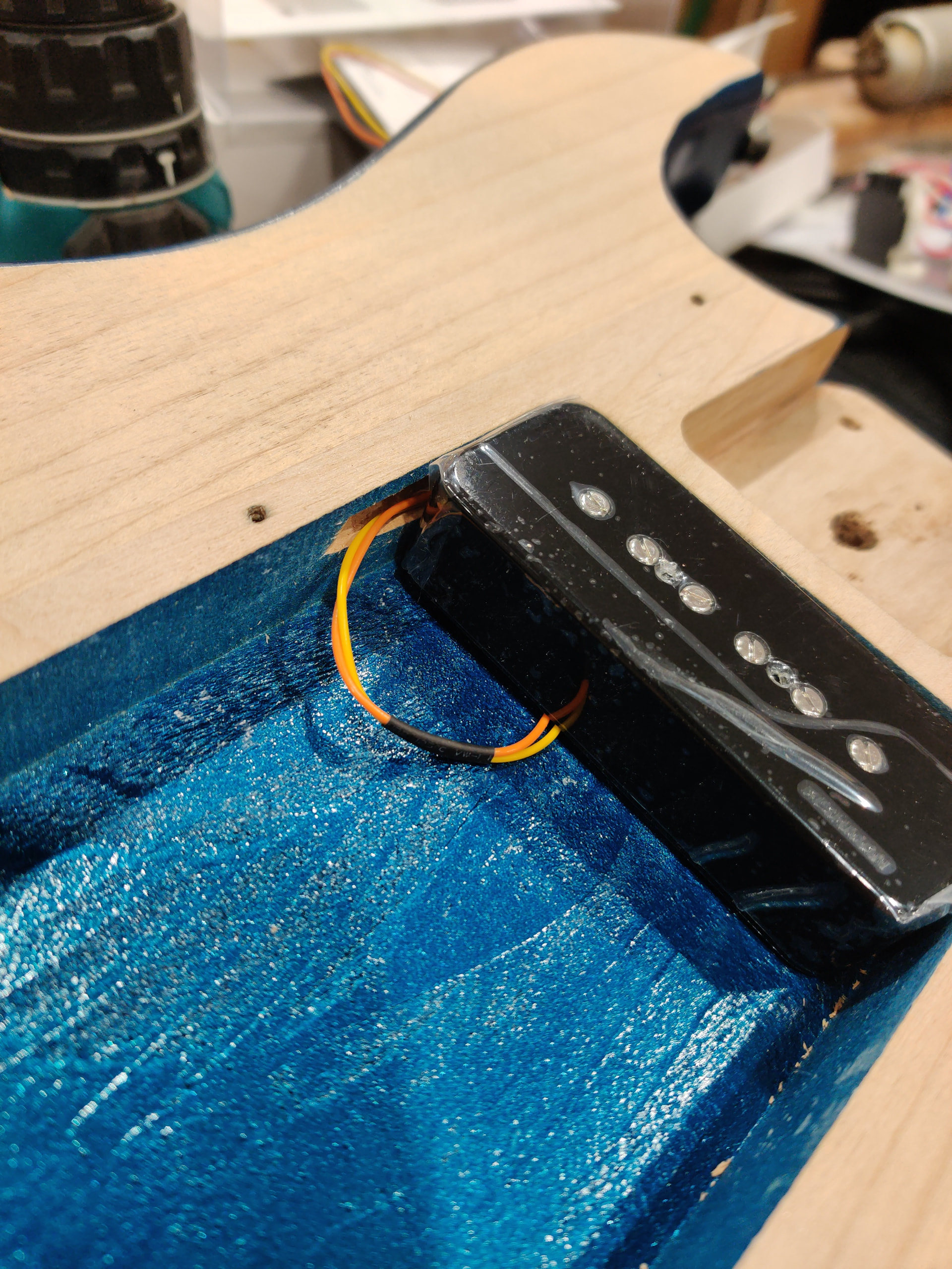

I also chiseled out a small channel for the wires as the P90s take up almost the entire width of the cavity. This way the wires can pass by the pickup without affecting its position.
Next up? Likely committing to screwing the pickups in place
