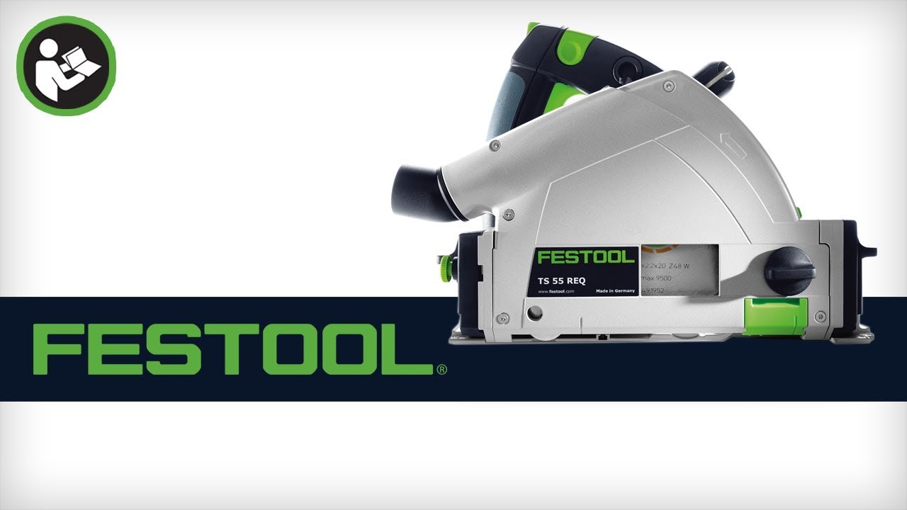

Festool-TS55REQ-Supplemental-Manual.pdf (3.9 MB)

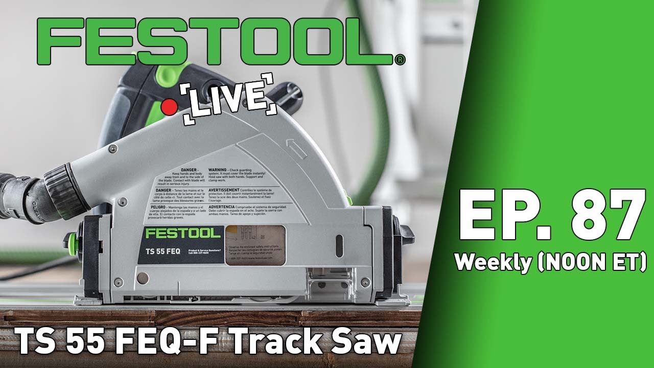

and this video (skip to minute 3:00 and go)
Can we add this video to the assesment
https://www.youtube.com/live/ZwYl3eZg_w8?si=TmdUBcxQDBl_ug_1
