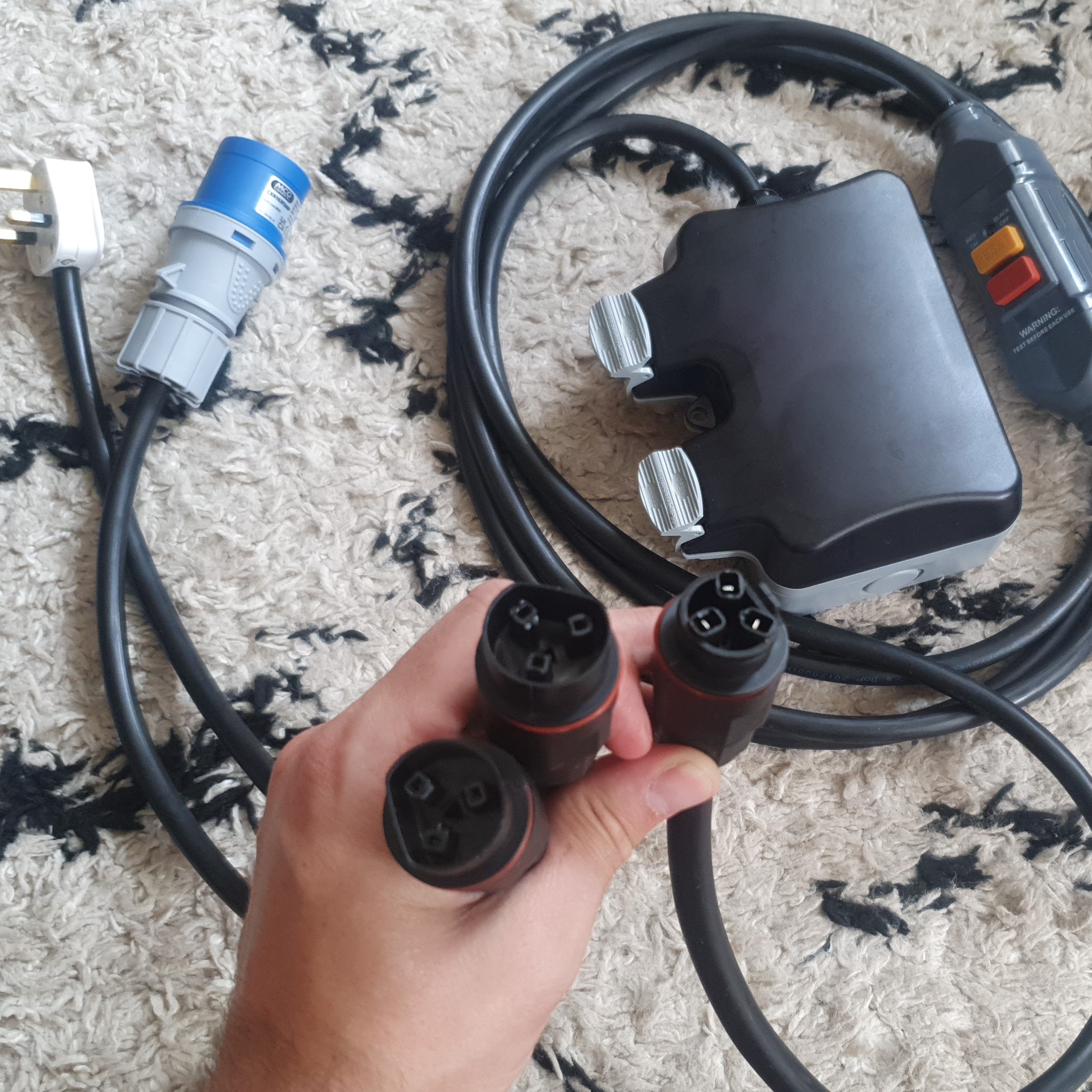

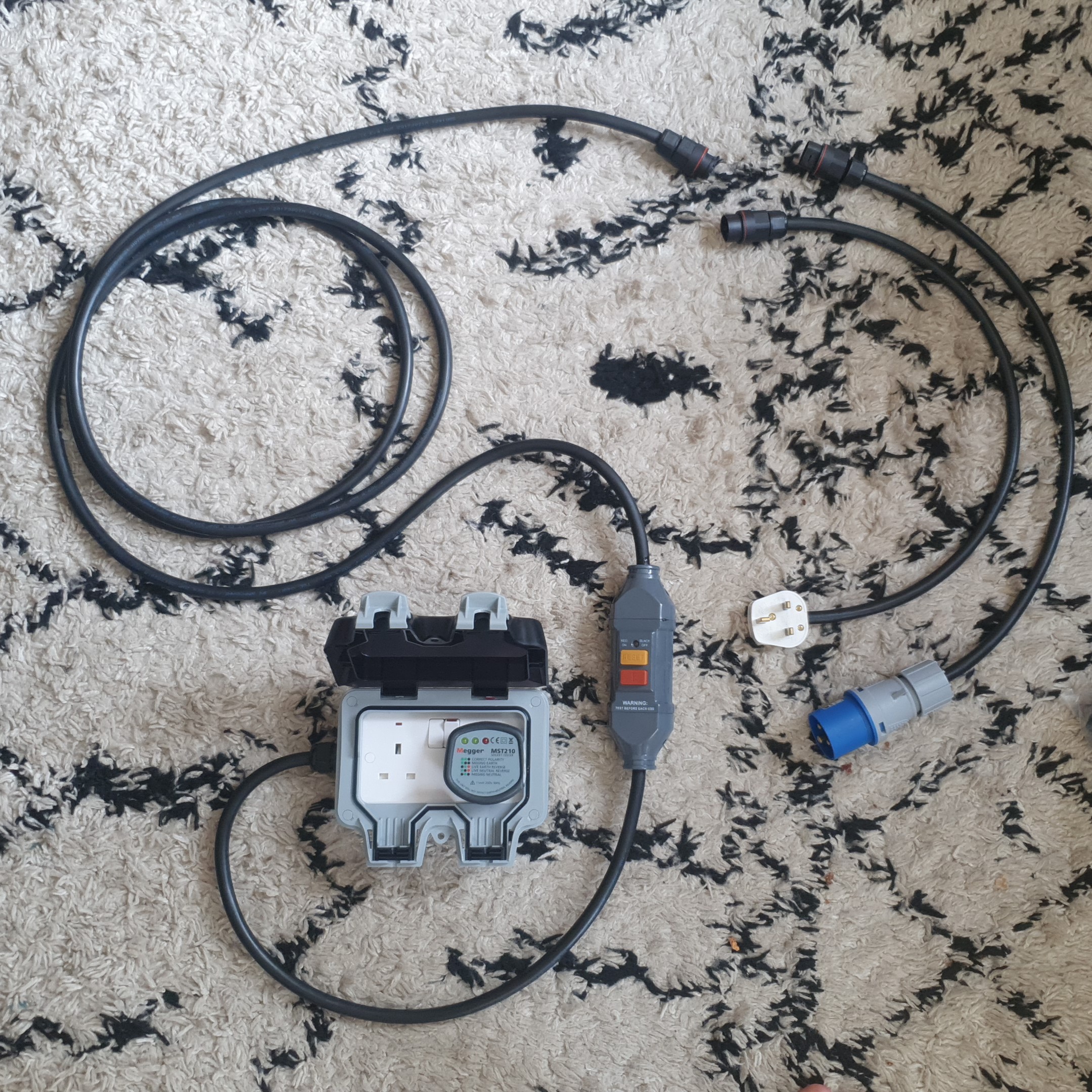

Instead of buying something for camping, and something for charging I decided to make something to do both!
The features I wanted it to have:
- safe sustained 2kW throughput
- RCD protected
- Waterproof
- Swappable plugs
The beauty is also that I can put another 10m cable in between the ends if I need to extend it further, plus if/when we go abroad I can just make up a tail with the correct plug for the countries we visit.
I would love to pat test it, purely out of curiosity rather than requirement so may reach out to some qualified testers to run through it with me at some point.
