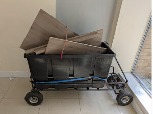

Without my own car, and not wanting to hire a man with a van, I brought the wood on a trailer attached to my bicycle. I certainly burned some calories that day!
