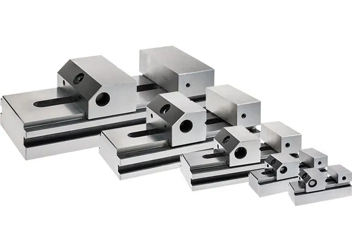

Been learning how to use the desktop CNC lately but I’ve only used flat sheet type material with the very low clamps we have fitted - do we have a two jaw vice anywhere that can be fitted to the t slot table on the mini CNC?
I’m happy to buy a cheap vice and leave it on indefinite loan, I just don’t want to do so if we already have one in a draw somewhere - here’s roughly the sort of thing I mean: Steel Grinding Vice 2" Inches Vise 50 mm For Mini Lathe Vertical Milling Slide | eBay

We don’t have anything iirc. I’d be down to chip in for some tiny little parallels too. Anyone recall how much Z we have with a normal amount of tool stick out?
We don’t have anything as far as I’m aware. Even though the linked vice is tiny, I’d still deffo measure the leftover space with an endmill in before buying. I was surprised how little z there was when I wanted to do something similar.

Damn that’s a good point, I hadn’t particularly thought about the amount of z we’d be losing with that design - will measure next time I’m in

Measured the CNC today and it’s 90mm from the plate to the bottom of the collet when at max height, definitely too tight for anything higher than 20-30mm from the bed.
