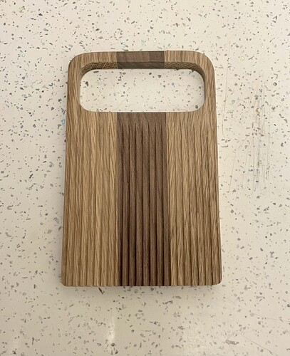

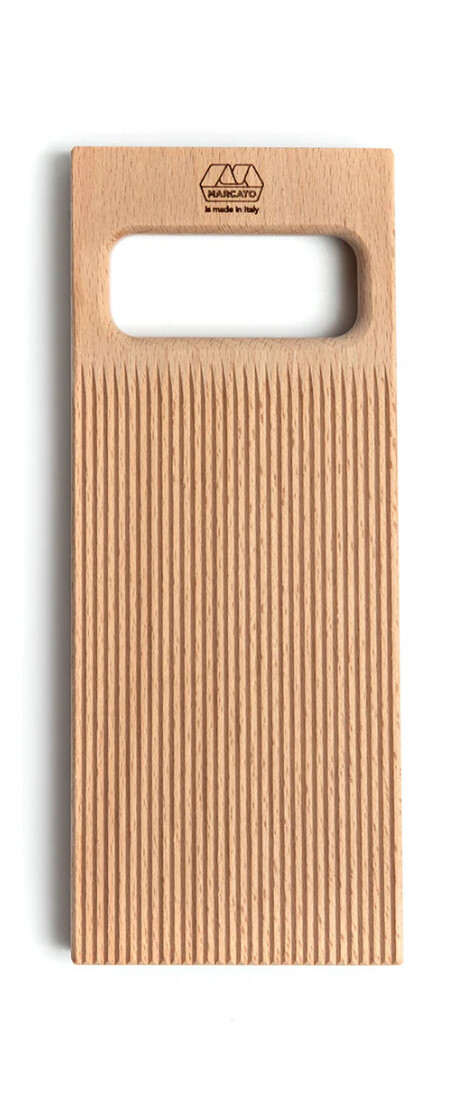

CNC newbie here. As my first project on the desktop CNC, I’d like to make couple of gnocchi boards, something like this one:
I had a look at the design at makerspace and was aiming to use a v bit for the ridges but I could only find end mills and engraving bits. Someone kindly pointed out that I could use an engraving bit for the job but Vcarve calculated about one hour and 20 minutes (for the ridges only) for each board using engraving compared to 15 minutes using a 60 degree V bit. As I don’t own any router bits, I was wondering if it’s possible to borrow a v bit from the big cnc if allowed and there are no comparability issues? Or any other tips by the @CNCtechs or anybody else on how to reduce the cutting time is welcome!

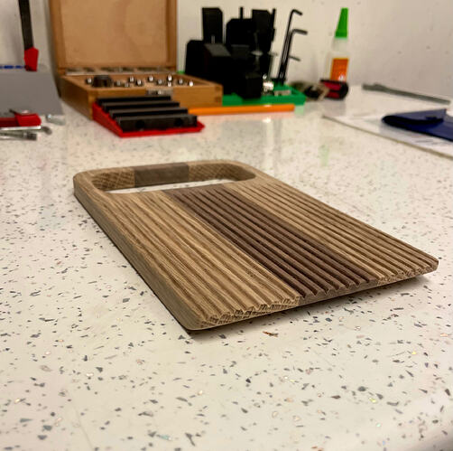

Thanks for the responses! With few tweaks on the design, I managed to do something very close to what I wanted to achieve with a V60 bit. It makes a nice little gift.
