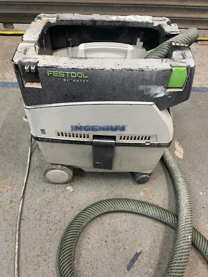

The festool is the only m class vacuum we currently have working in the woodshop.
The Henry IS NOT “M Class” so should not be used for on tool dust extraction.

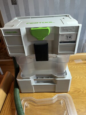

When I found the trend broken, it had very obviously been used without a bag, which i suspect to be the reason it broke. Whatever replacement we get, can we make sure it has a cyclone
If we want the cyclone, the festool is the only option,
Bag change frequency will be in years rather than weeks,
The clear cyclone on top gives an instant visual indication if it is full and needs changing.
It is easy to empty, undo two clips, pour the contents in the bin outside, and replace.
The easier we make the dust extraction emptying the more likely it is going to be done by members.
The new cyclone on the fixed extraction has proved this already
