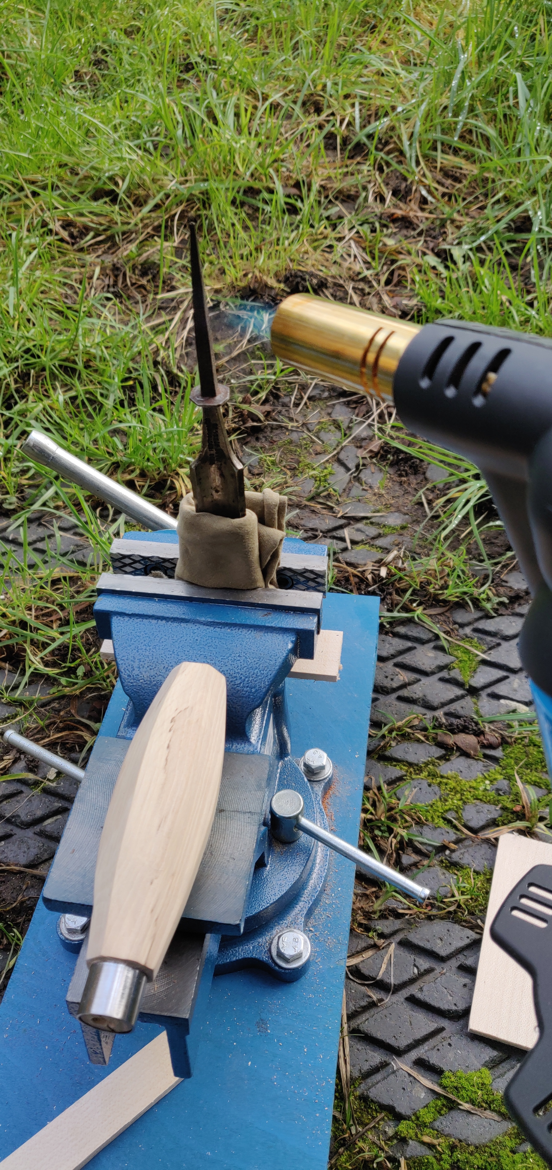

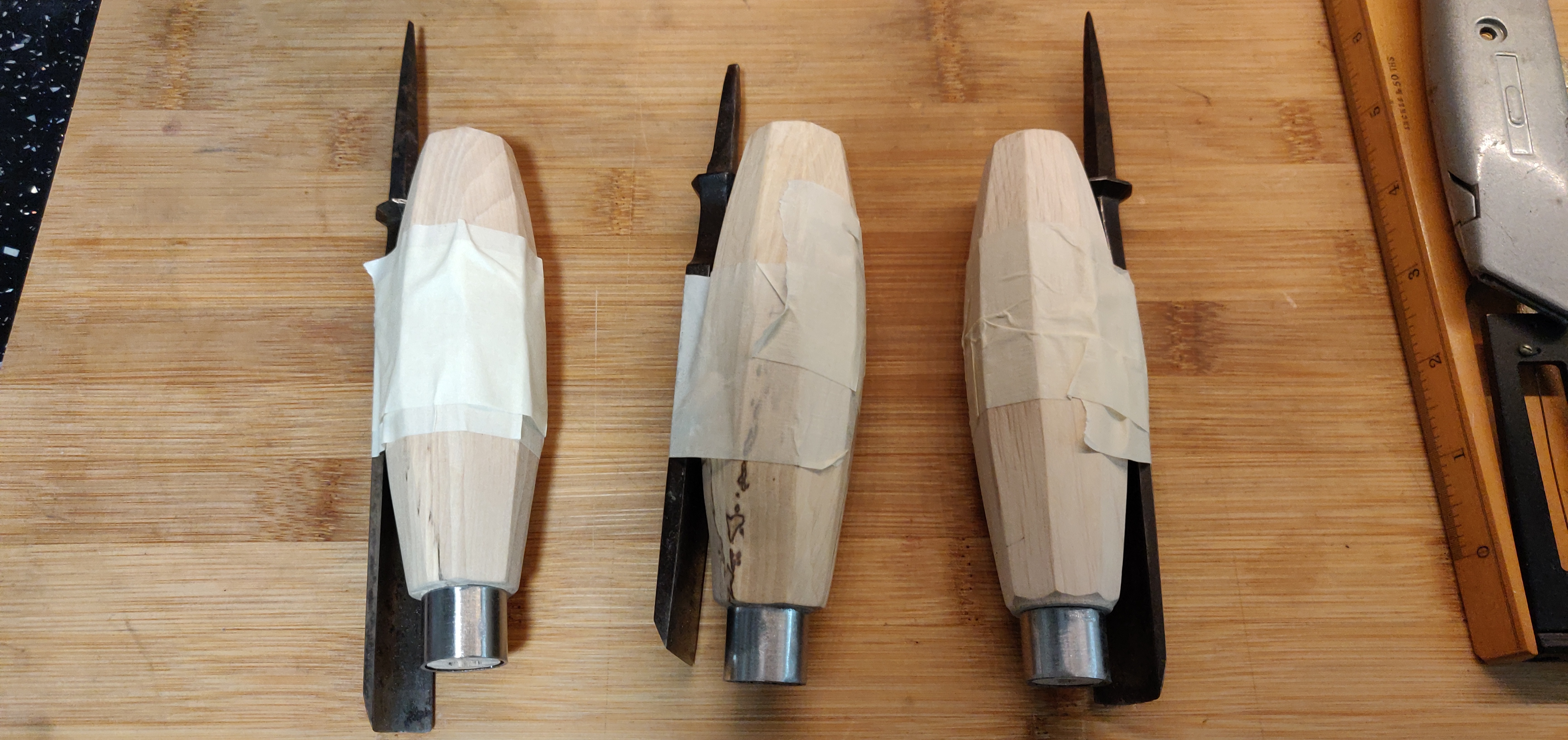

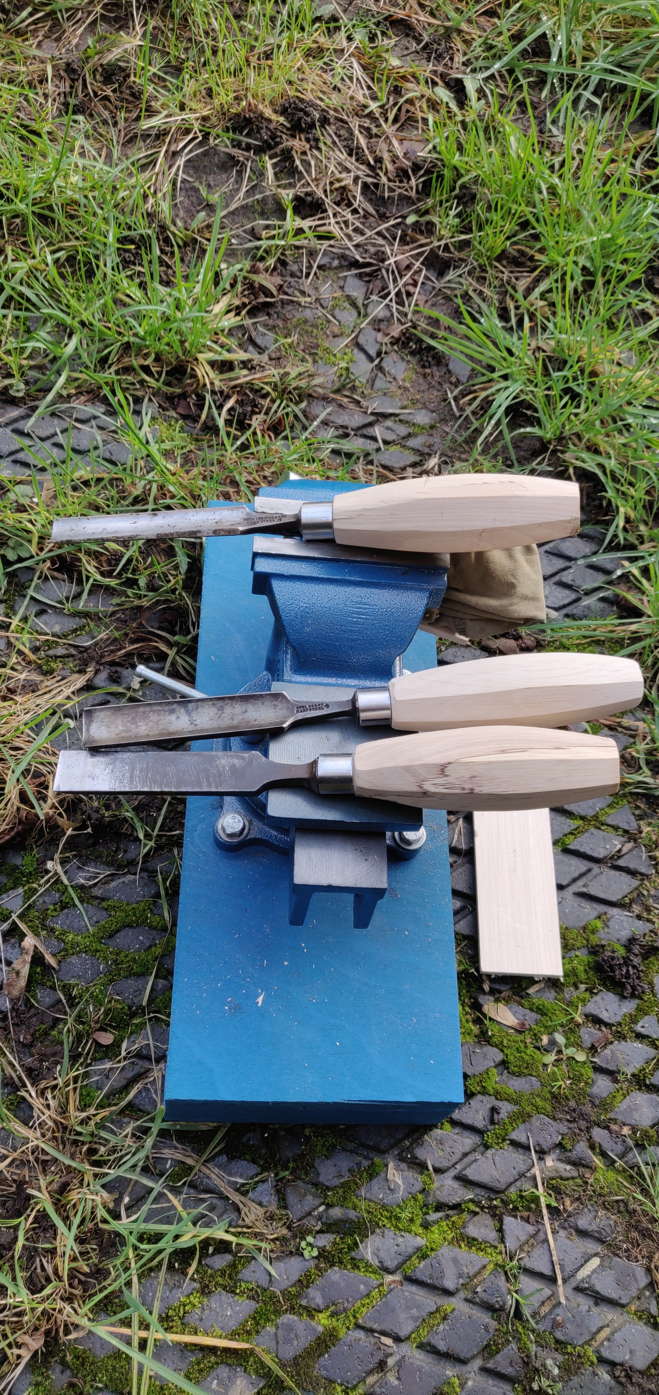

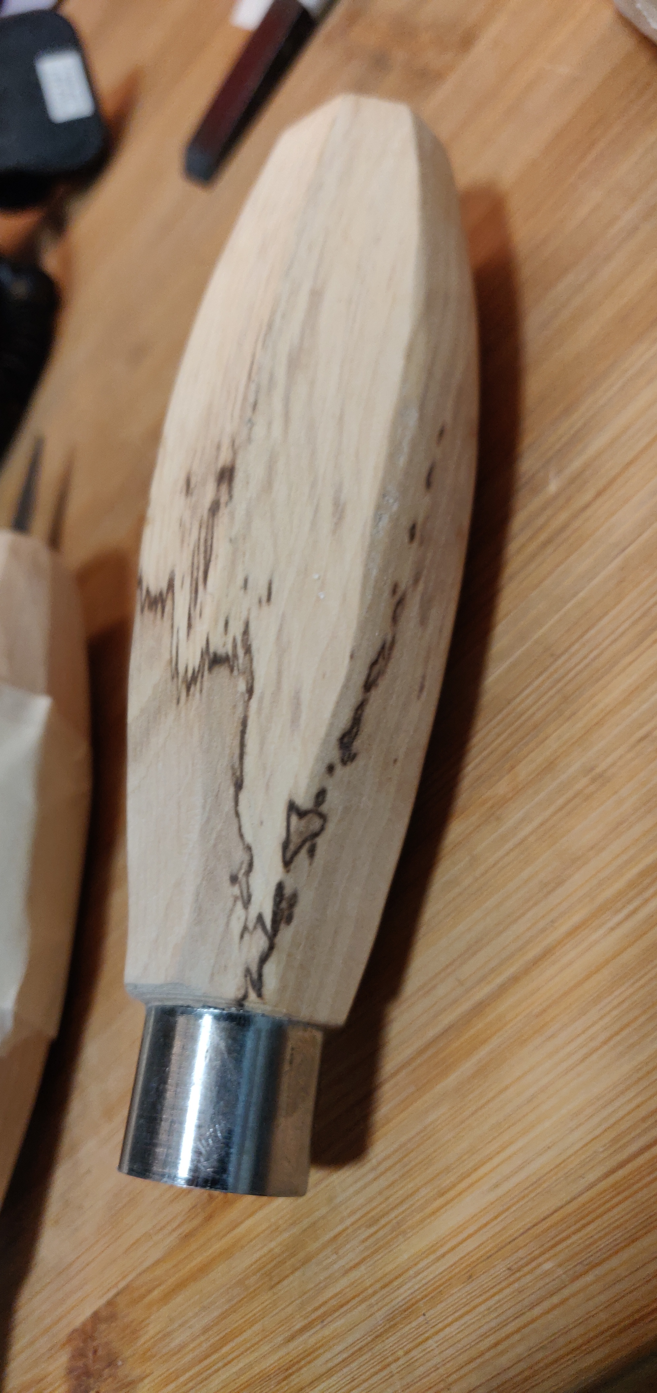

Thought I’d post a mini project I’ve been working on: some new tool handles. Two gouges (one Sorby, one Thos Ibbotsen) and one firmer chisel (Brades Co). I have one more Douglass Manfg. Co. gouge to do but it’s a socket so will require a bit more finesse.
Still debating how to finish these: the hornbeam yellows a bit when treated with BLO and wax, and I love how pale they are at the moment.

They are beautiful, how did you achieve that profile shape?

Bandsaw jig with a good amount of sanding and fiddling, with the section for the ferrules turned on a lathe. I’ll label the jig and leave it in the space.

Lovely job @CriticalTolerance they look great.
