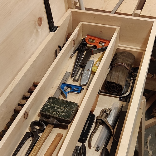

This is a version of the boarded tool chest from the Anarchist’s Design Book by Christopher Schwartz. The original plan was to go to a timberyard and get a decent set of straight-grained pine planks which I could throw through a thicknesser. Another lockdown put paid to that idea so this is made from DIY store pine which I thicknesses by hand. The grain did not make that enjoyable.
The corners are lap joints, with the nails skewed to help dovetail it to the side. I wanted to tongue and groove the floor, but ended up shiplapping it.
Starting to think about tool layout but the next step is tills, lid and skirt. So far my only complaints are difficulty fitting my moulding planes in a useful spot, and difficulty fitting my brace anywhere (but then braces are awkward anyhow).

Lid on, tool rack in, first till made. I like having a tool rack for my chisels and awls - I used one in my last tool chest and appreciated being able to lay my hands on them more quickly than with a drawer or till. I will say that it takes enough off the width that seeing into the bottom of the chest is a little awkward, so if I made them again I might do the tills at five or six inches wide rather than seven.
The bottom of the till is recycled maple, resawn and bookmatched. I’m not going to be looking at it much, but when I do it will be nice to see the pattern.

Second till done - might add an internal tray for it but I’ve got some more tweaking to do until I’m happy with my layout.

General thoughts after a couple of months’ use:
  • The chest lives on top of two saw horses to bring the top to about hip height. I haven’t really used this on the floor, and I don’t really want to. The Dutch tool chest is superior in that aspect I think - storage underneath main compartment is built-in.
  • I like that I open one thing - the lid - and it’s all there. Sure I have to move tills but I don’t have to find a place to keep the fall front while I work like I do on the DTC.
  • It’s not as good as the DTC for storing moulding planes. There isn’t the height for a corral plus tills (I could go with just one till, but you’d lose a lot of storage), and I can’t fit my plough plane in at all. Some of this is because I put a tool rack in which reduces the space at the back, but honestly getting any of them out is a challenge. Maybe I’m storing them wrong. The DTC wins in that regard.
  • I don’t store my saws in there. There’s not the room for my panel saw (again, I need more height under the tills), and I’ve ended up keeping everything in the French cleat on the back of my bench. Not great, and the DTC doesn’t have this problem.
  • The tills really do soak up all the small awkward things which my last tool chest didn’t really have a place for. The tool rack is something it shares with the DTC and is my favourite thing - keeps all the edges on my chisels safe - although you do have to be careful reaching into the bottom back corner for things. That could be solved with a thin panel though which I’ll probably put in at some point.
  • I can’t find a good place for my brace, but braces are awkward, angular things and that would be true of any chest.
Some of these problems could be solved by building a full scale Anarchist’s Tool Chest, which I don’t have the time, room or patience for. Otherwise I think it’s hard to compare this against a DTC and conclude one is better.
The other problem is that it’s already pretty full, and I have ambitions to build more tools. But that’s not something which can be solved by a different design of tool chest.
