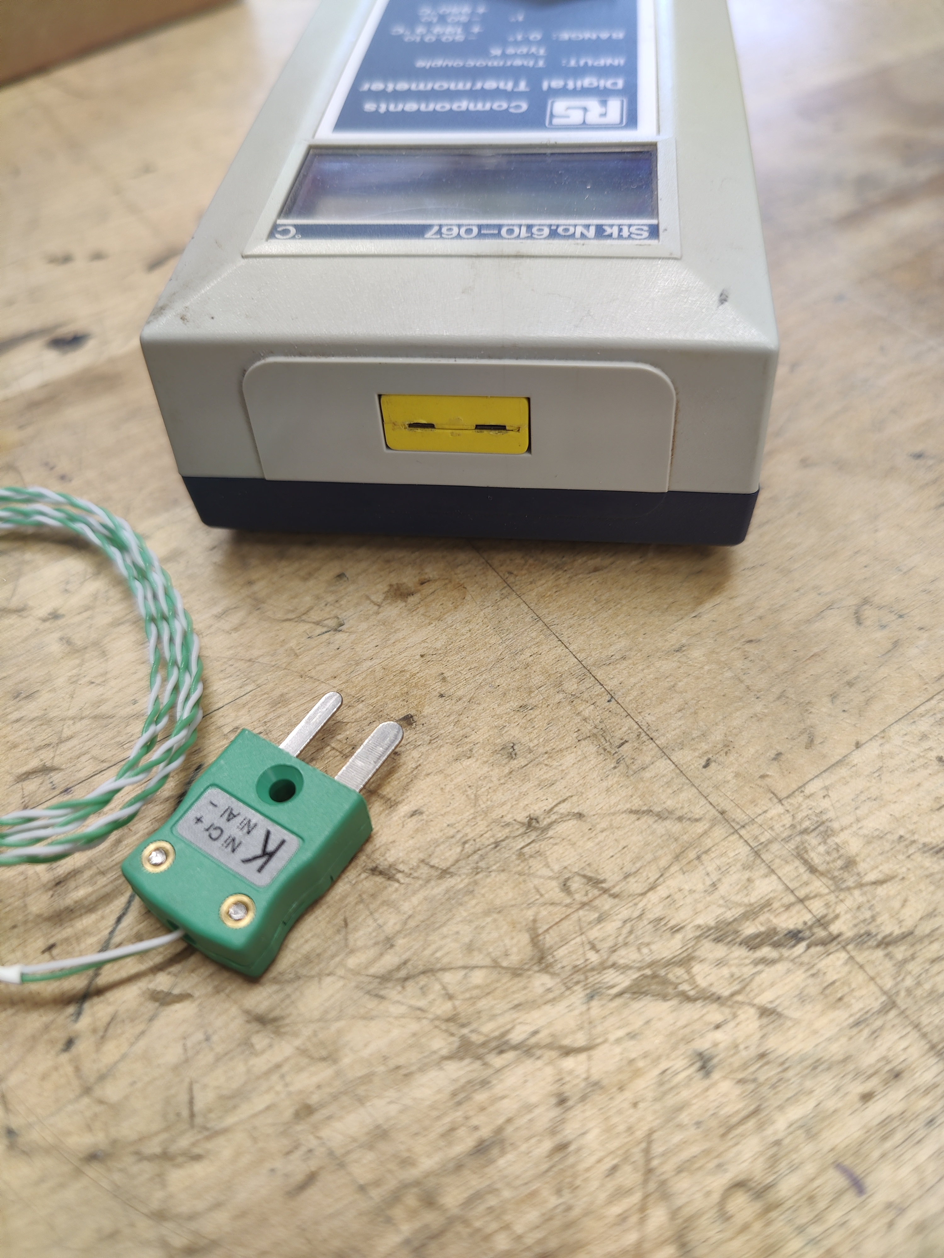

(a) a somewhat aged but perfectly functional RS Digital (thermocouple) Thermometer. No manual for it online. It takes at the top the 2 pins of a Miniature Thermocouple Connector Plug as shown below.
An example of this connector type is here: https://www.labfacility.com/miniature-thermocouple-plug-type-k-iec.html
It explicitly says on the front of the device that it wants Type K thermocouples only. For some reason it stays on if the battery is plugged in, (even if the front switch is in the ‘Off’ state) so removing the 9V battery after use is necessary.
(b) a somewhat distressed but working thermocouple. Type K!
(For a guide on this categorisation of thermocouple types, do check this out, same guide as I linked at the top: https://uk.rs-online.com/web/content/discovery/ideas-and-advice/thermocouples-guide)
It works. It has that compatible plug connector that fits the RS reader. :white_check_mark:
