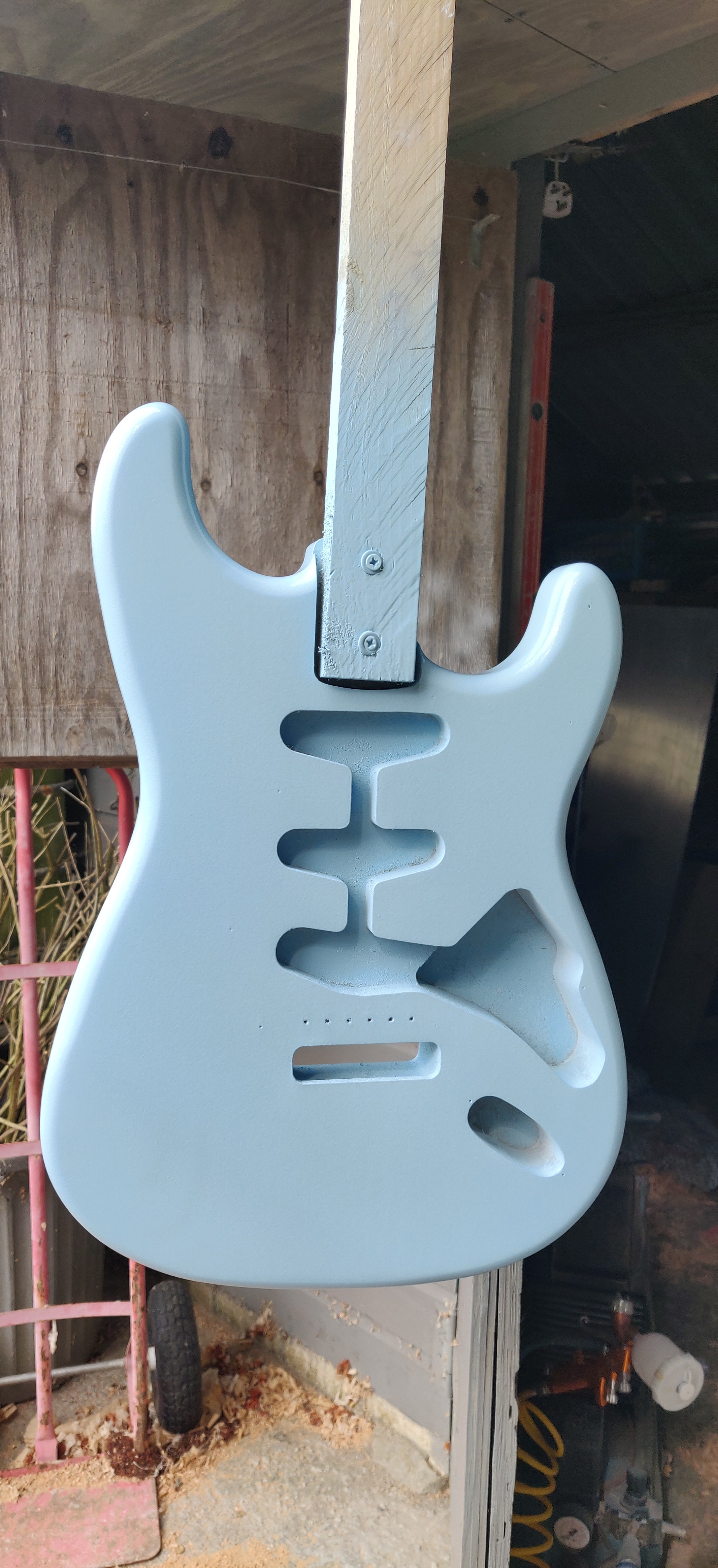

Stratocaster no2

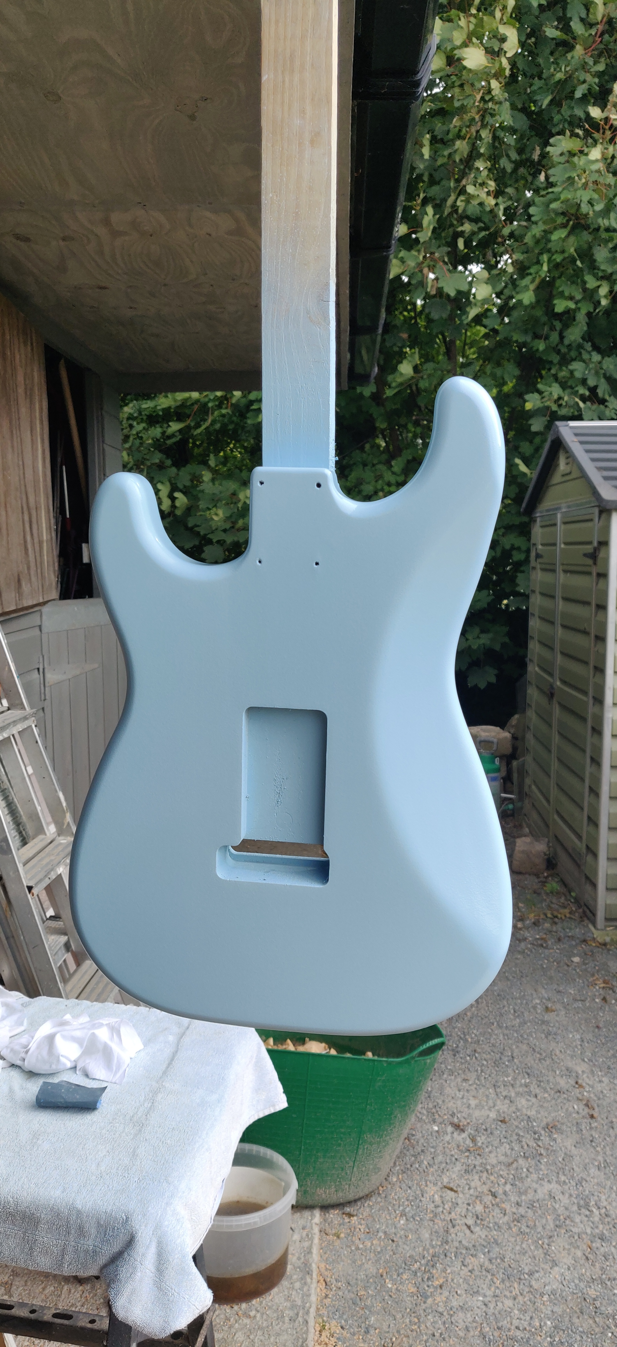

Trying to keep out of trouble so going to make a neck for a body I had already started
The body:

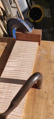

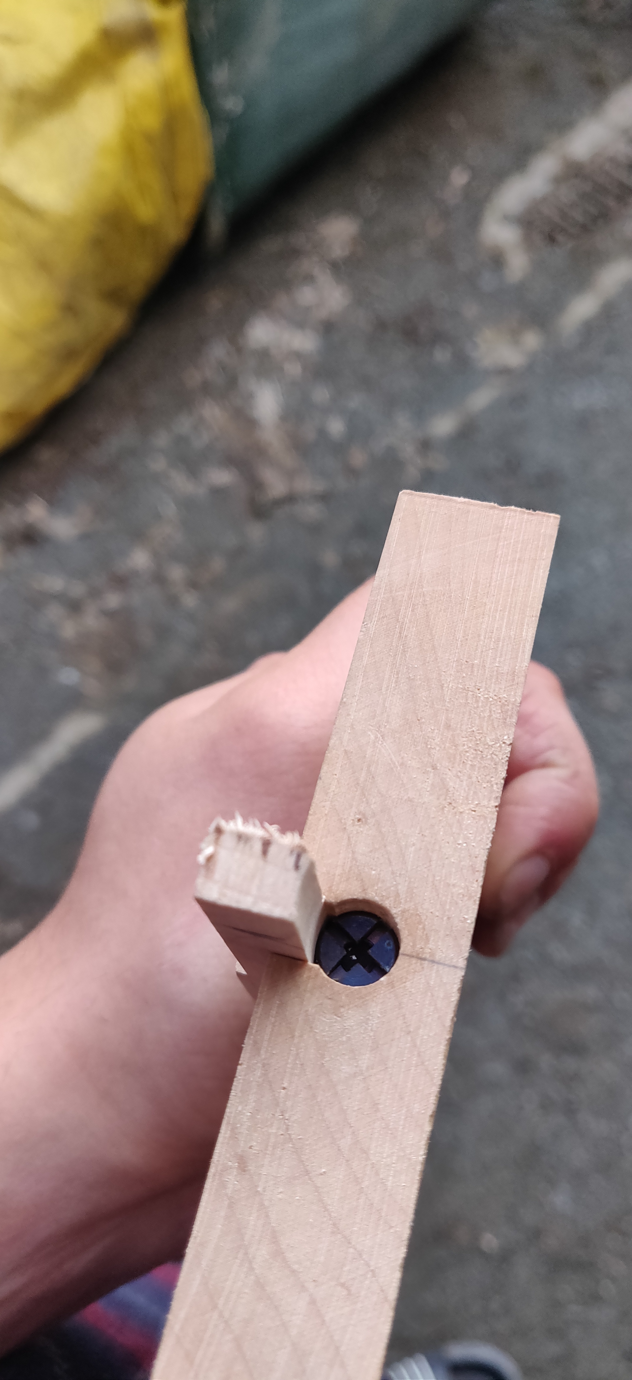

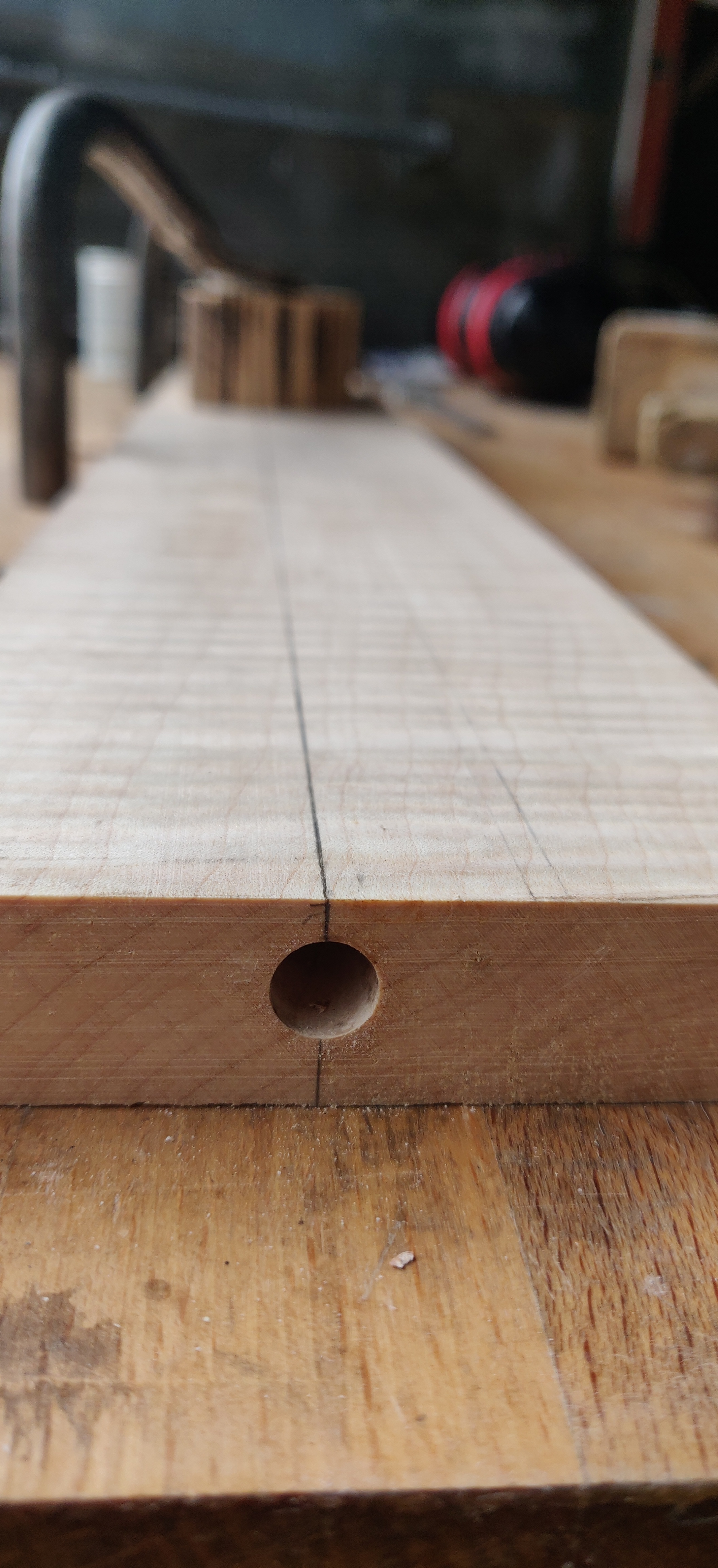

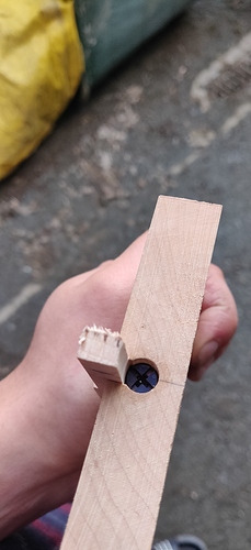

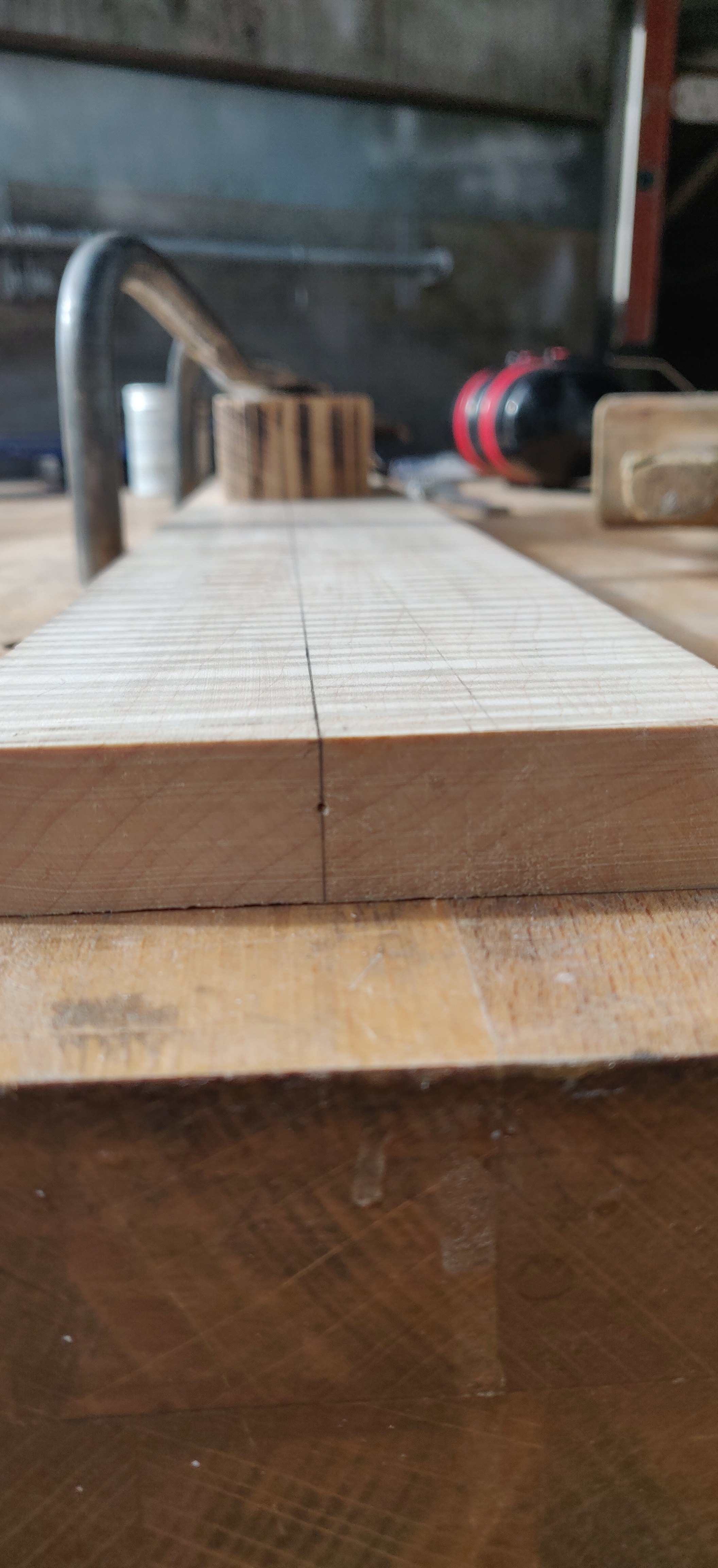

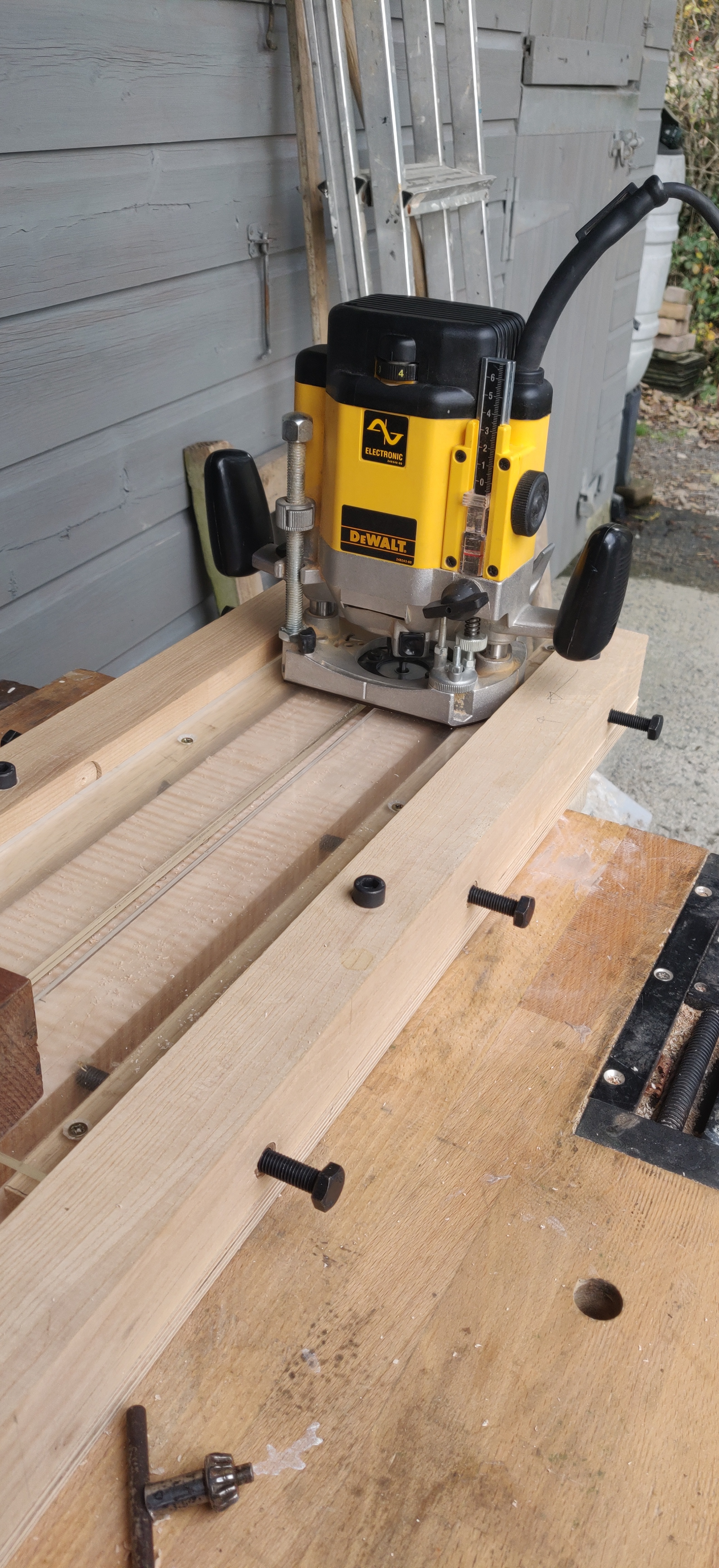

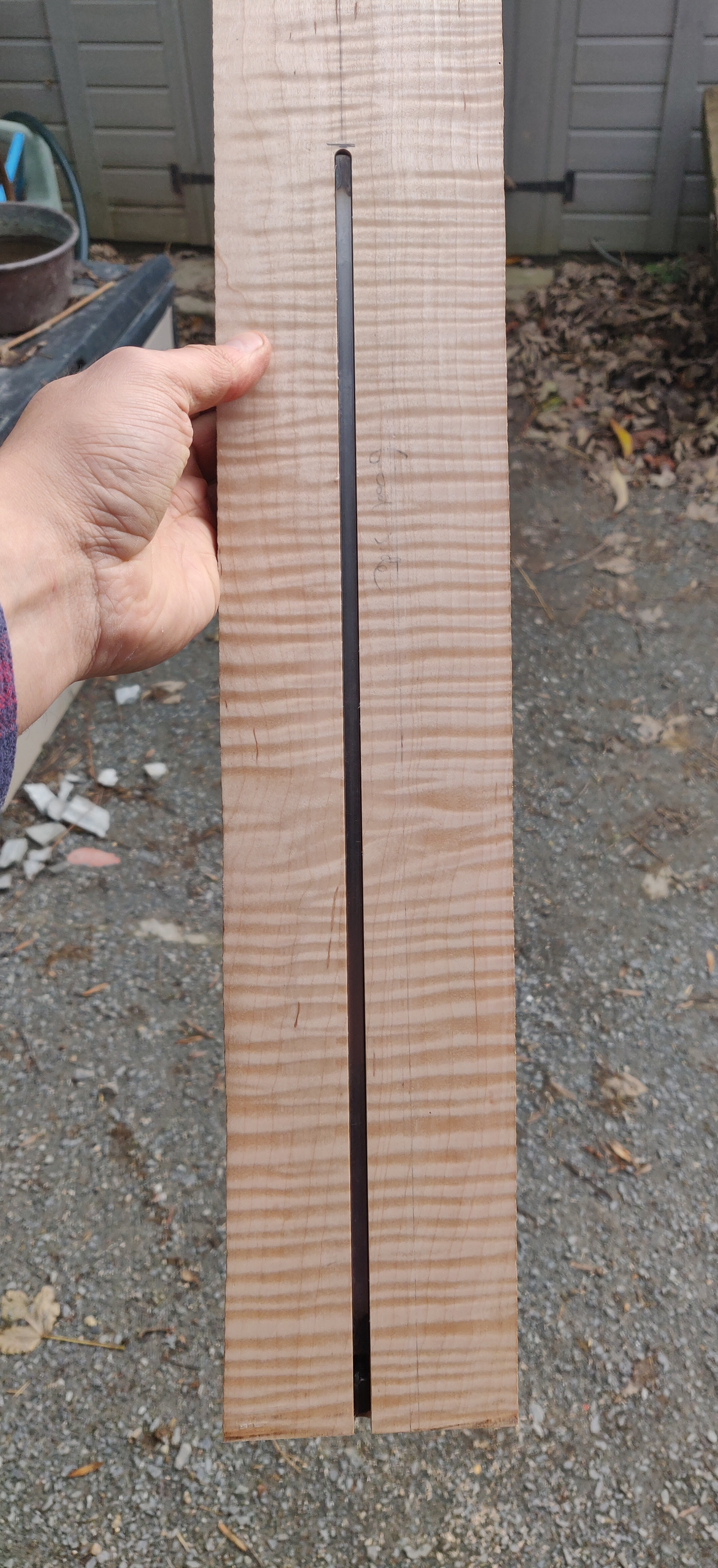

Starting with some thicknessesed stock, for my dual truss rod I first drill a hole for the truss rod but and then use my jig I made a while ago for routing the truss rod slot
I am covering the truss rod slot with a slightly curved filler strip such that I presses it down in the middle to prevent truss rod rattle

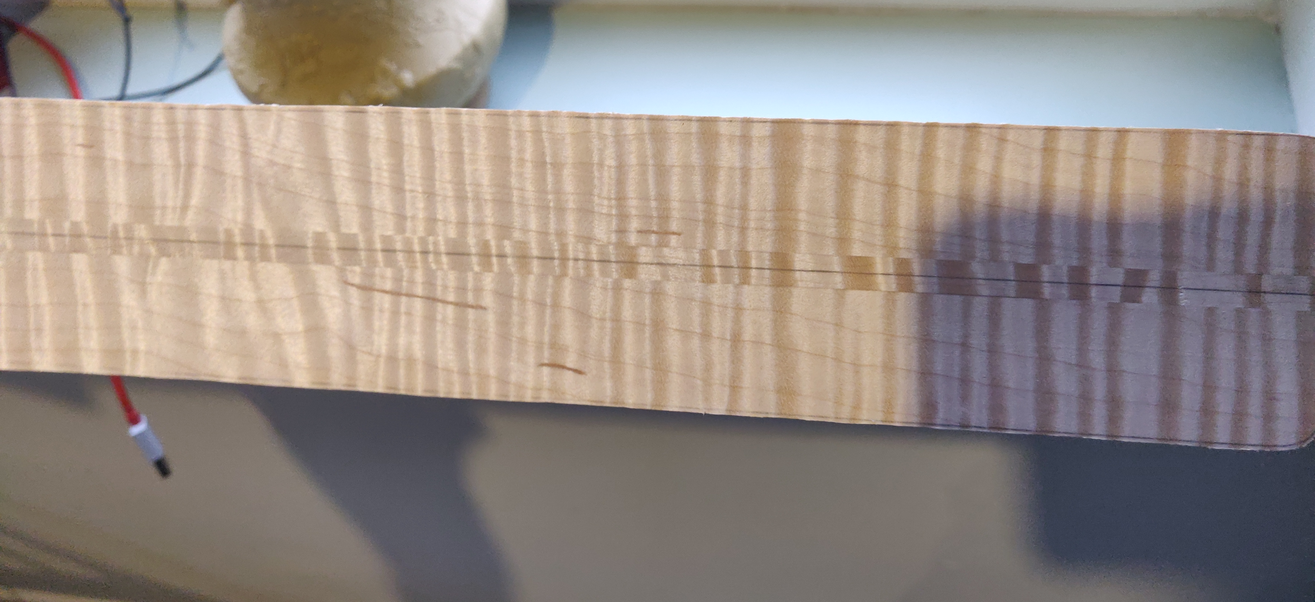

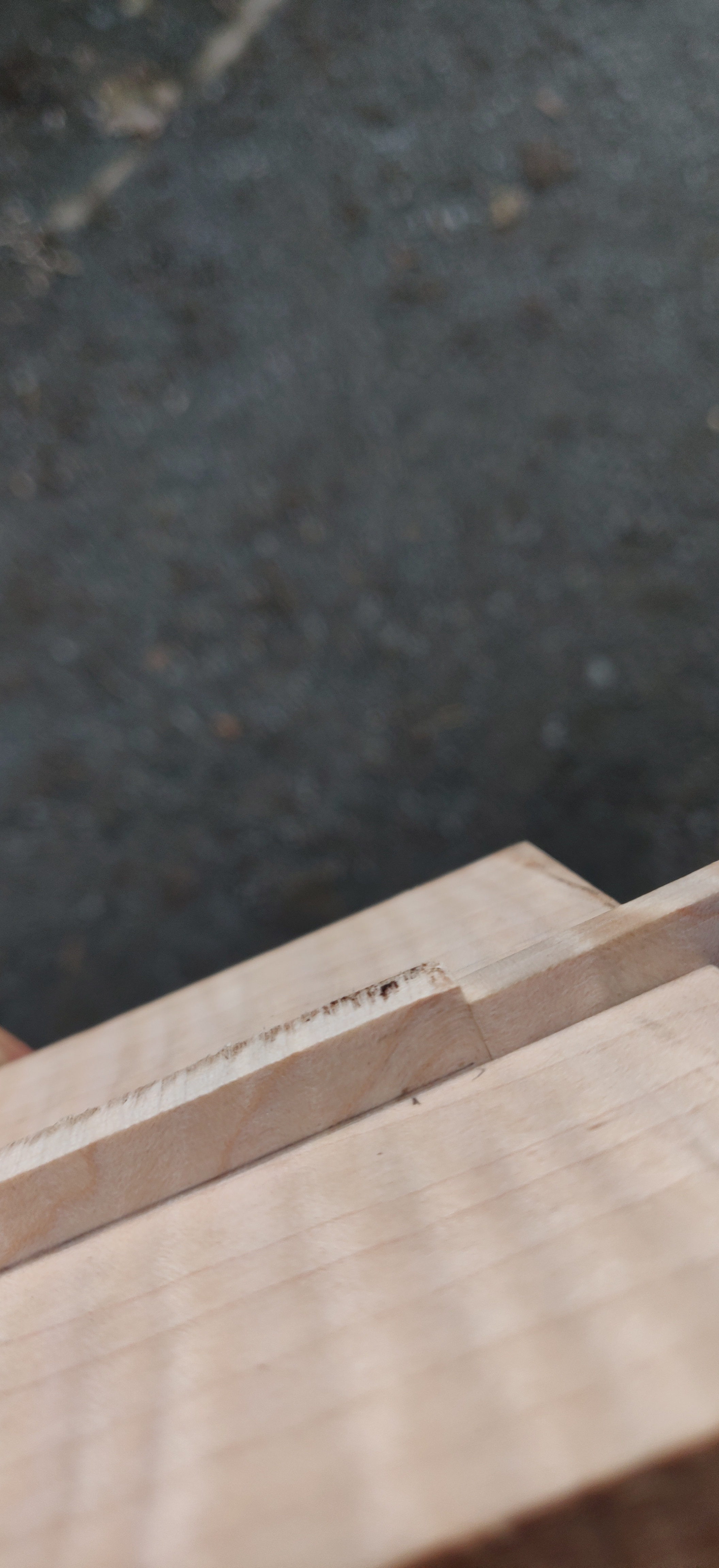

I did the filler strip I’m two parts. I did the end part separately such that I can make the bottom part follow the curve of the nut
It’s currently gluing so will plane the excess filler strip off tomrorow
Now ready for the router table to get the neck to the final shape. Minor chip in the filer strip at the top but not the end of the world since it will be covered. Something always doesn’t go quite to plan :triumph:

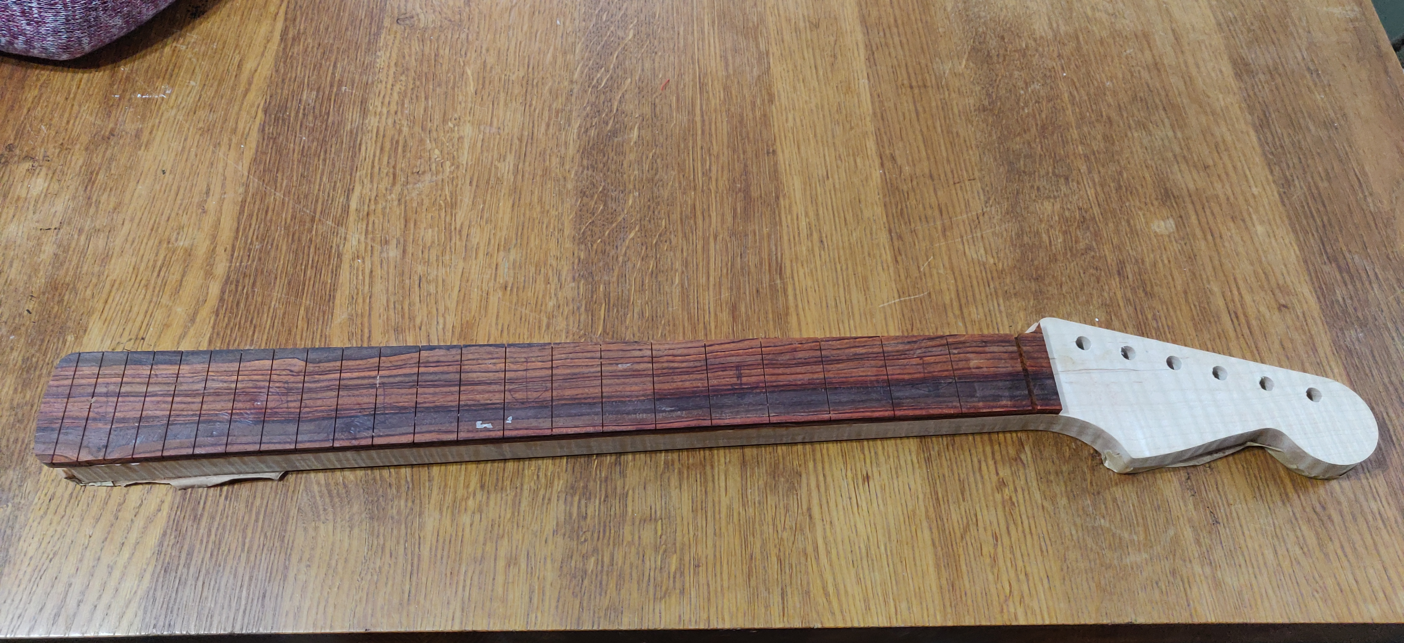

The fretboard will have 22 frets so will put that on later (if it had 21 frets would shape at the same time)

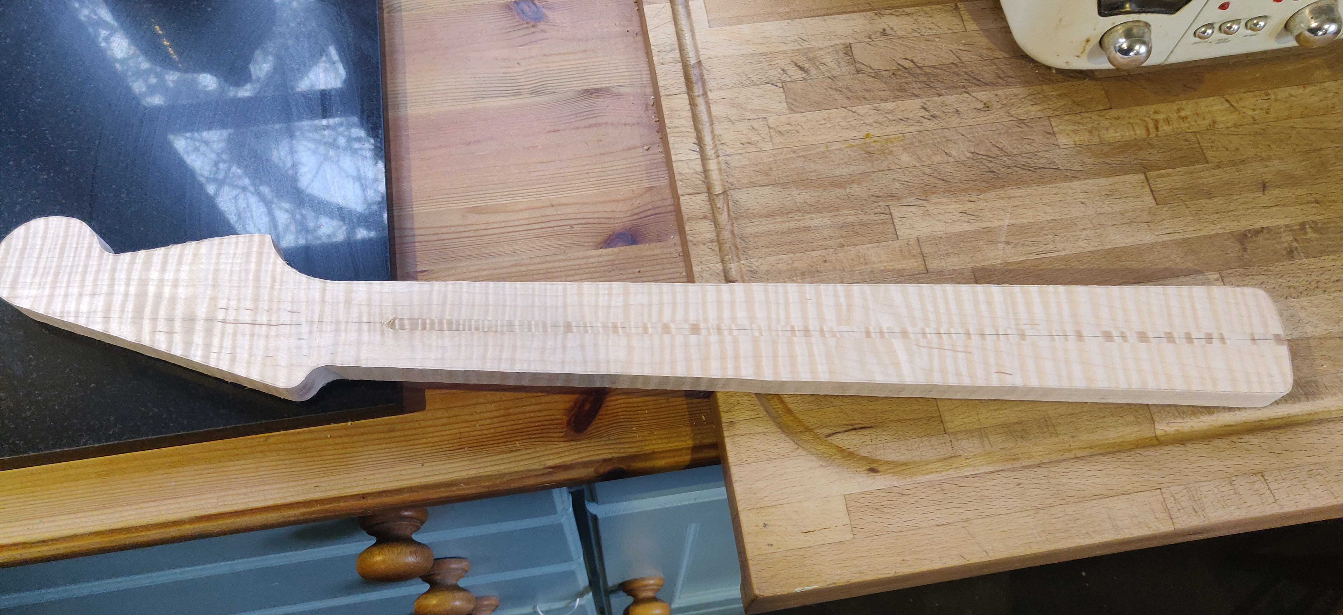

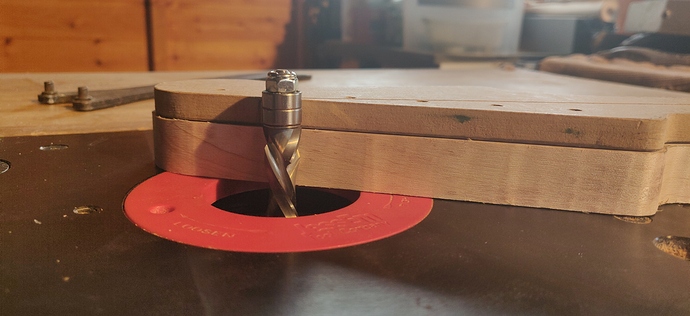

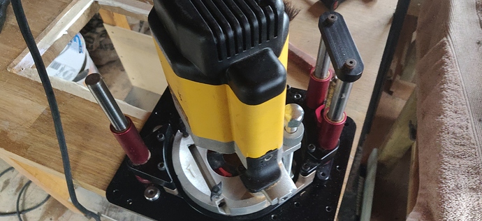

Routed the neck to shape (pushing the neck from the right to left against the router bit )

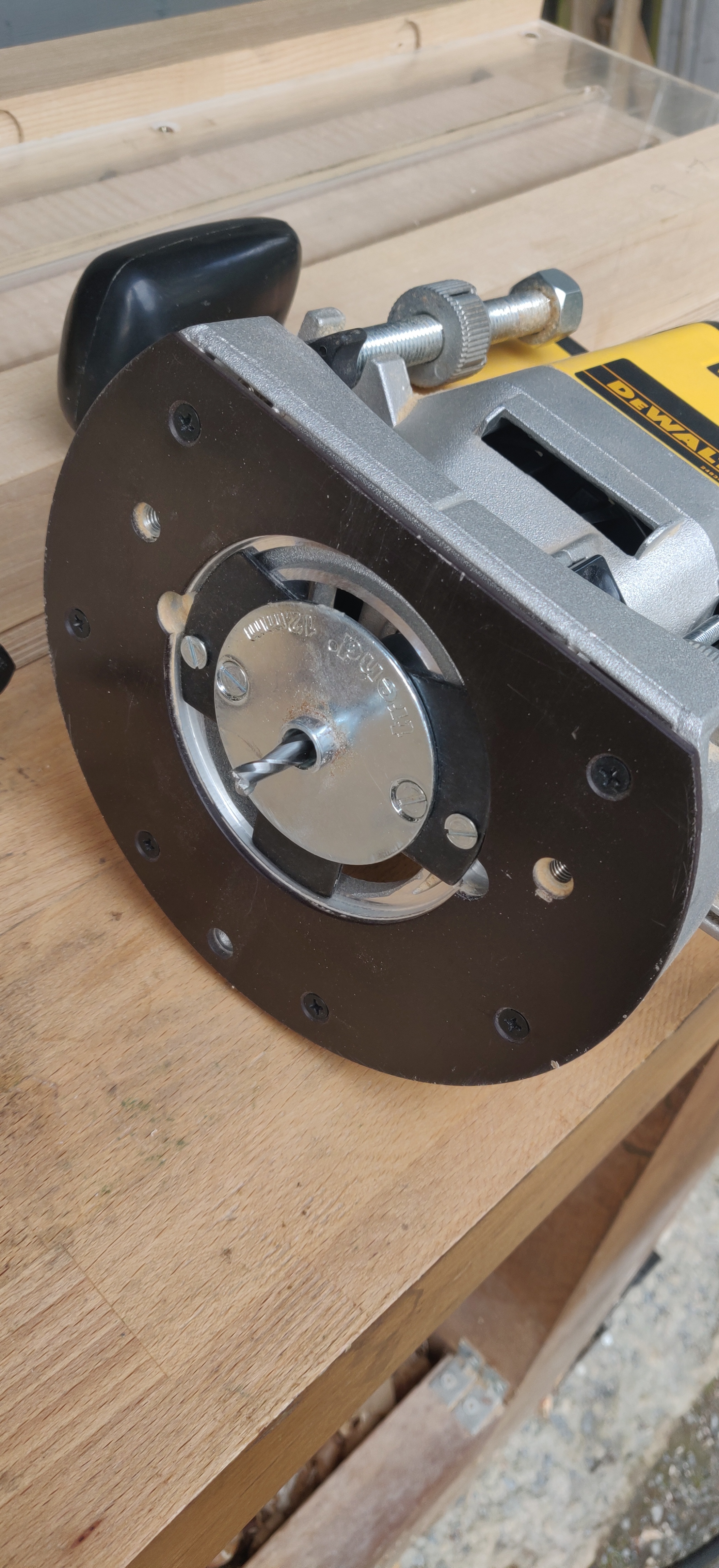

Putting the router in the table insert is a bit of a faff but the neck is a bit narrow to rest the router on top

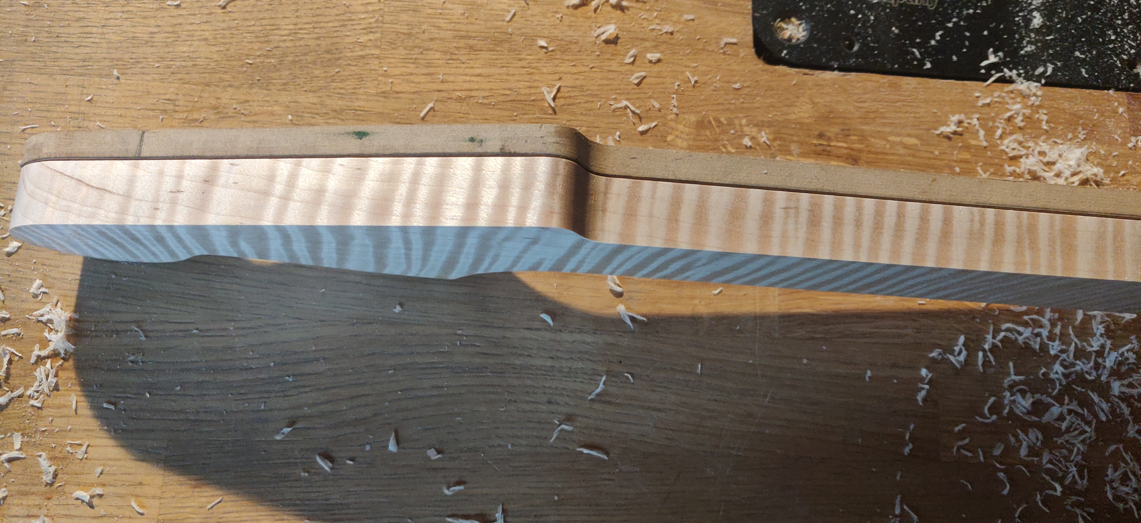

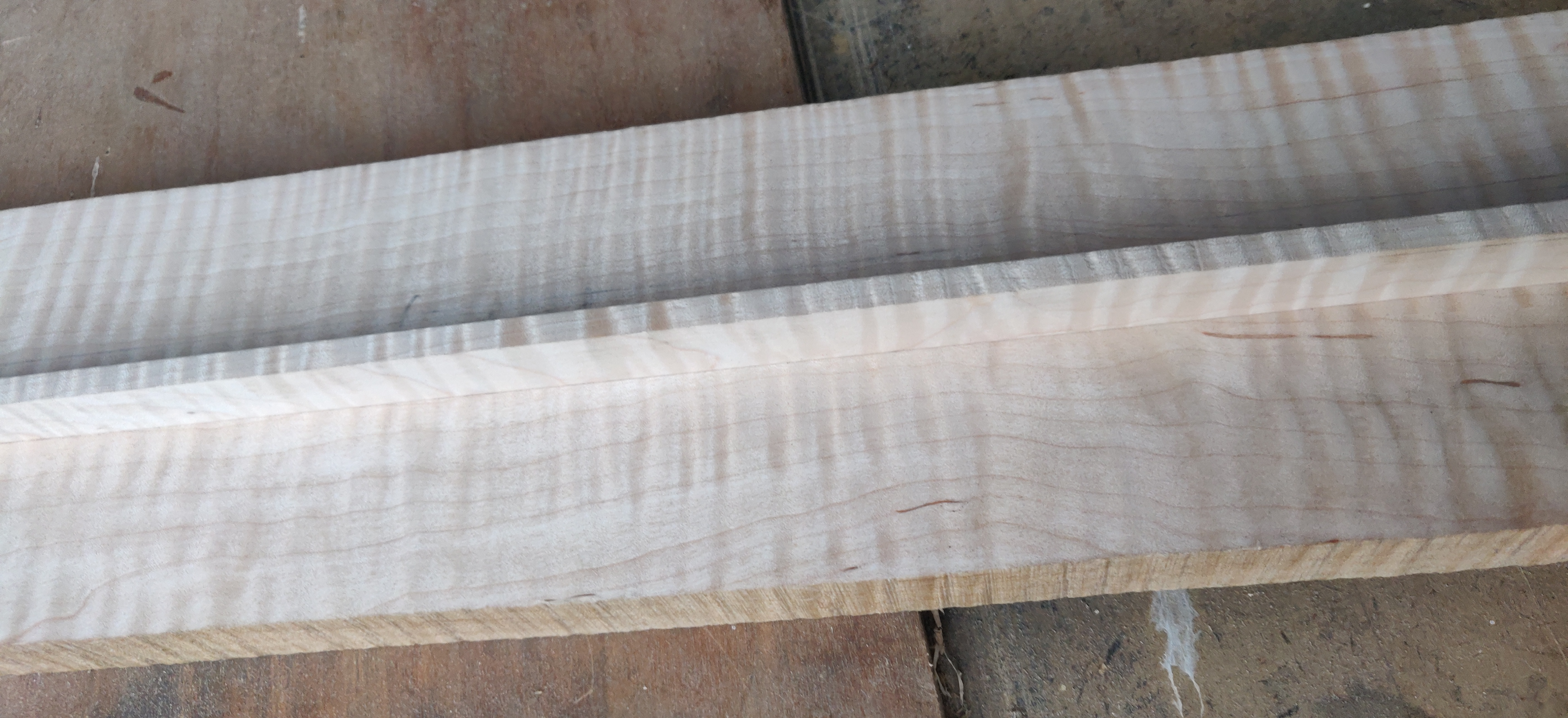

Lovely looking bit of wood that is. What sort is it?
It’s flamed maple.
Basically maple but a little trickier to work with

Fretboard was glued to the shaped neck with fish glue (makes life easier if you mess up). Then used a router to confirm the fretboard shape to the neck for the majority of it with the exception of the end part .
For the end part I created a “template” for the end part by wrapping tape around the 21 fretboard template (to make it a bit wider). I referenced a warmoth neck to work out exactly how the new template should reference to the last fret.
I’ll have to done some final hand shaping as my adjusted template was a tad wider then the actual neck so there is half a mm or so material to blend/remove my hand

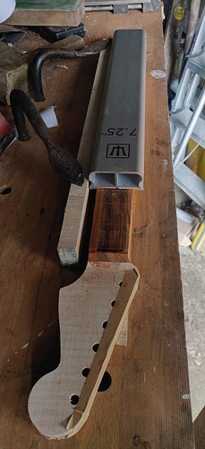

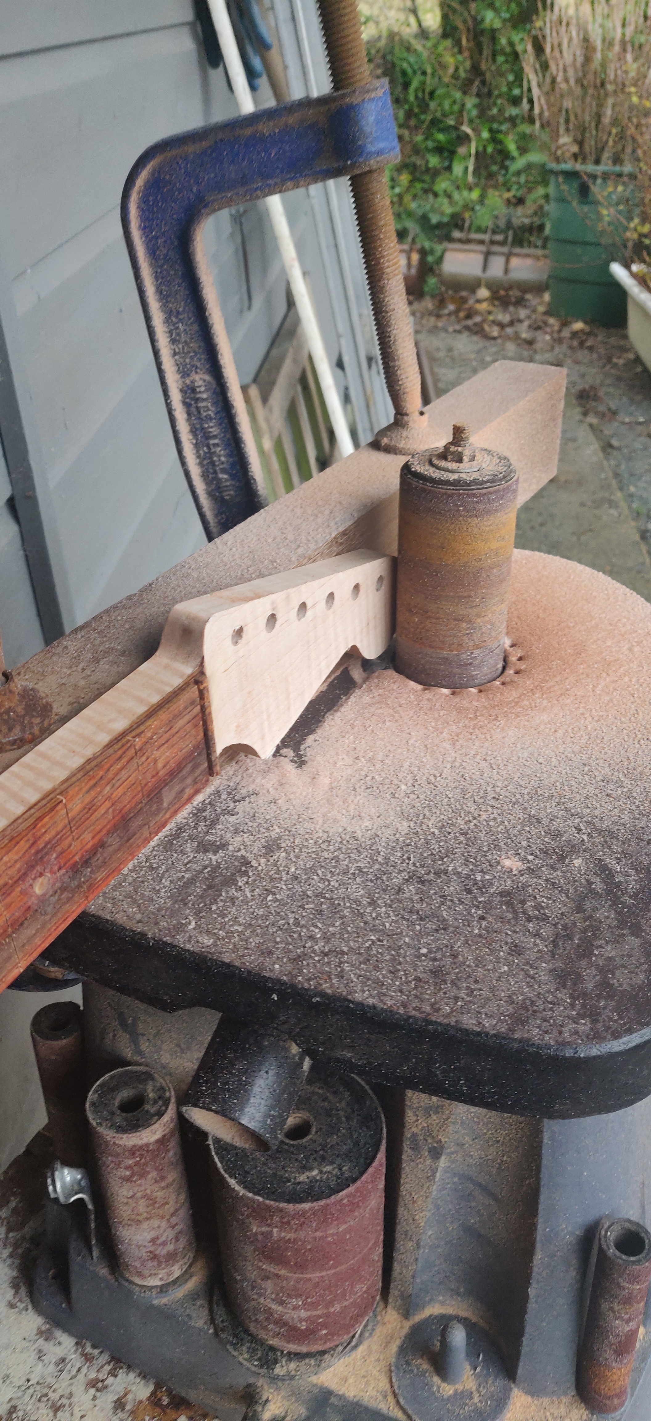

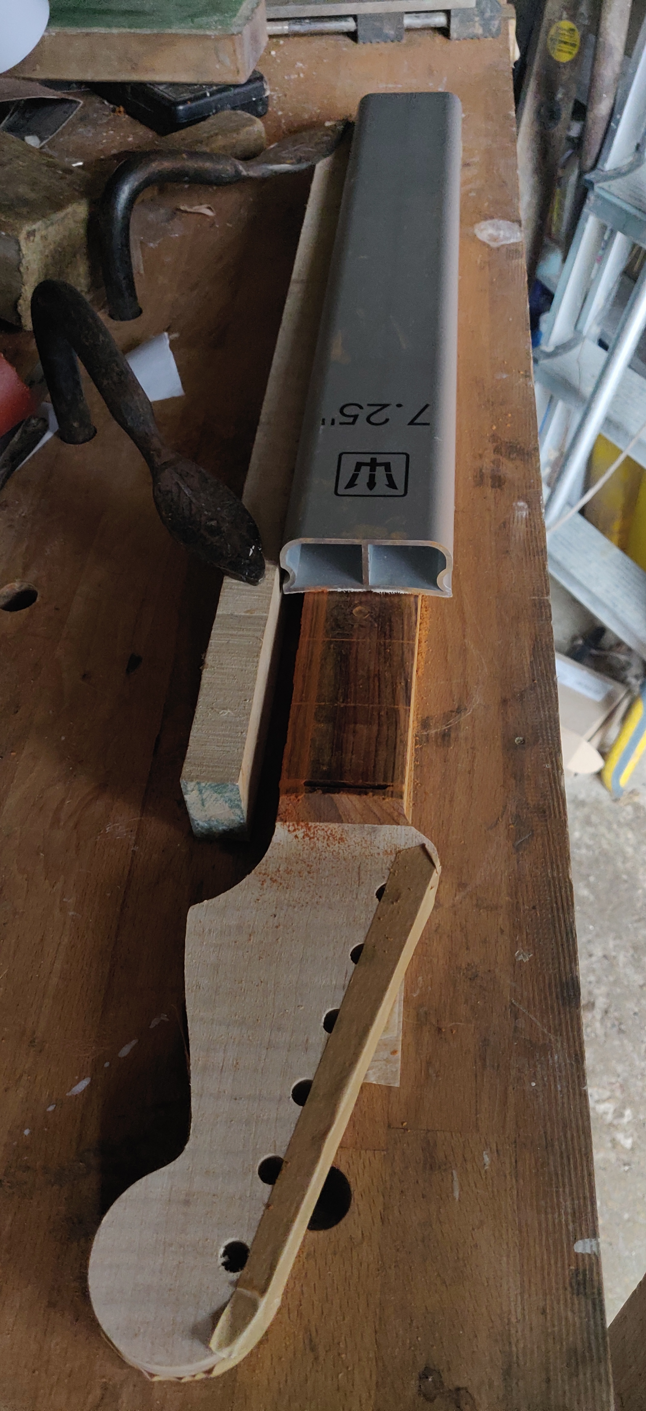

Roughing out the fingerboard to neck transition /headstock thickness
Radiusing the fingerboard
If the wood wasn’t so tear out prone it’s much quicker to rough the radius out with a hand plane. However cocobolo is always a risk. Perhaps can be offset with a high angle frog plane (lie Nielsen has an offering but not quite flash enough for that ATM)

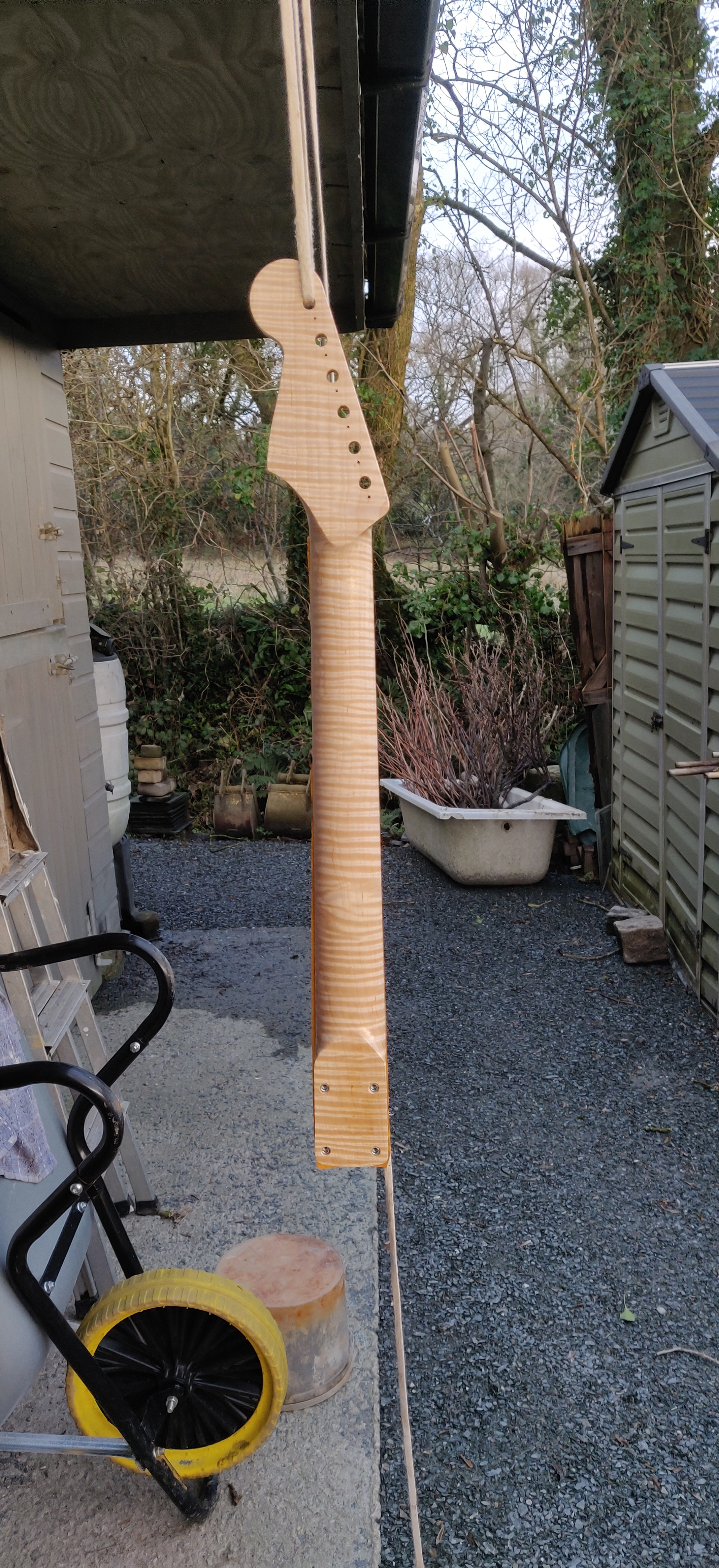

About as far as I can get for now. Will have to wait until Christmas holiday to complete the neck
Looking good!

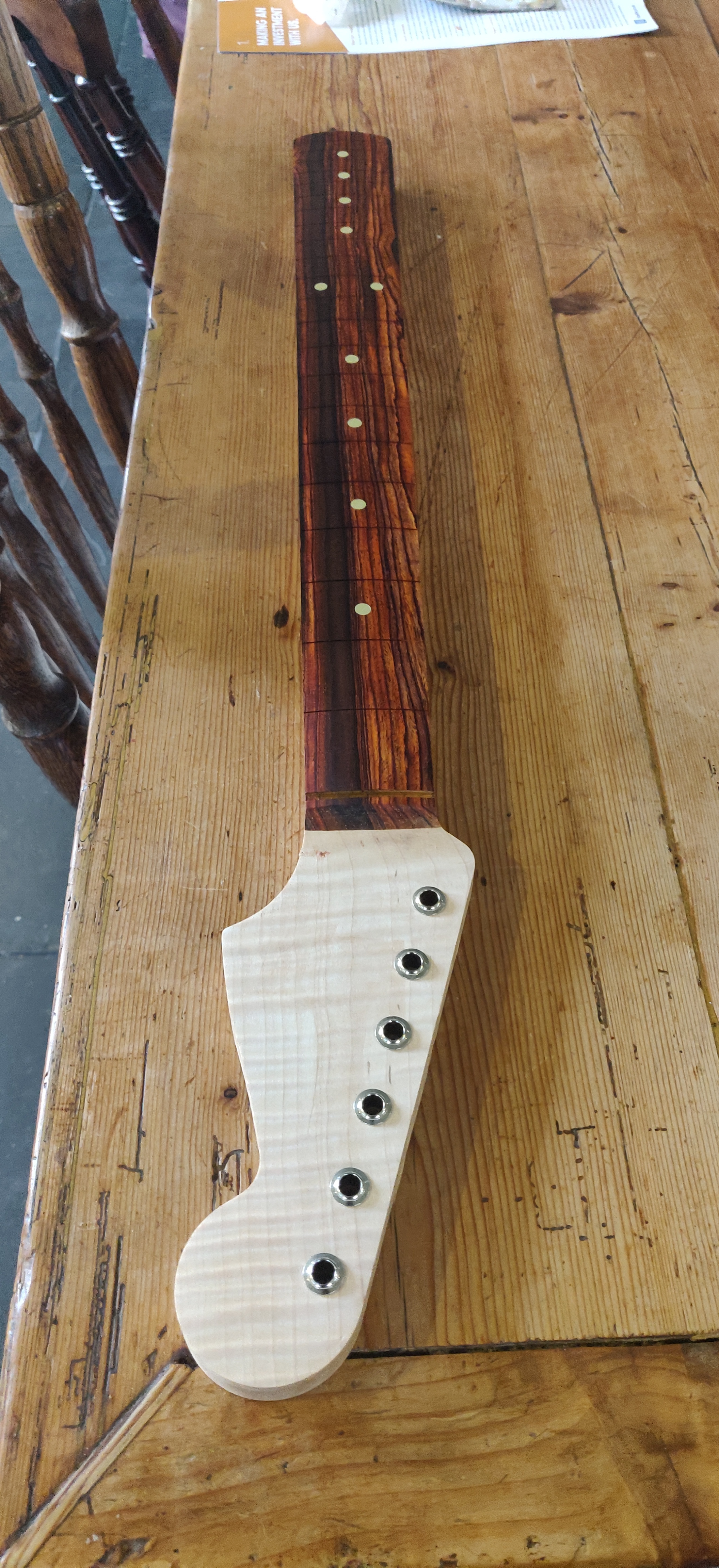

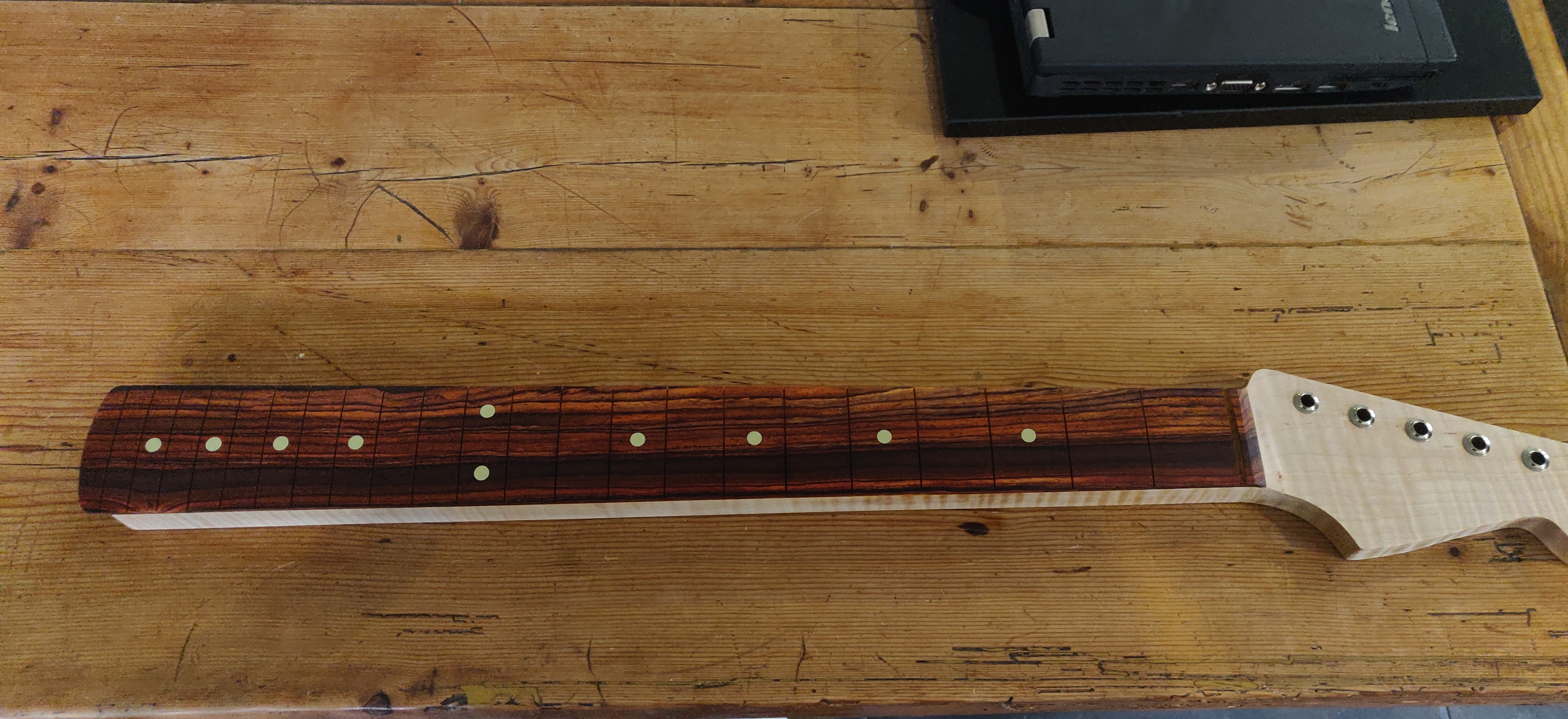

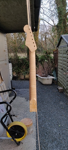

Did some work on it over the holiday.
Just needs some fret levelling, soldering and making a nut
