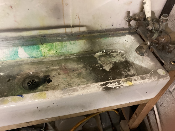

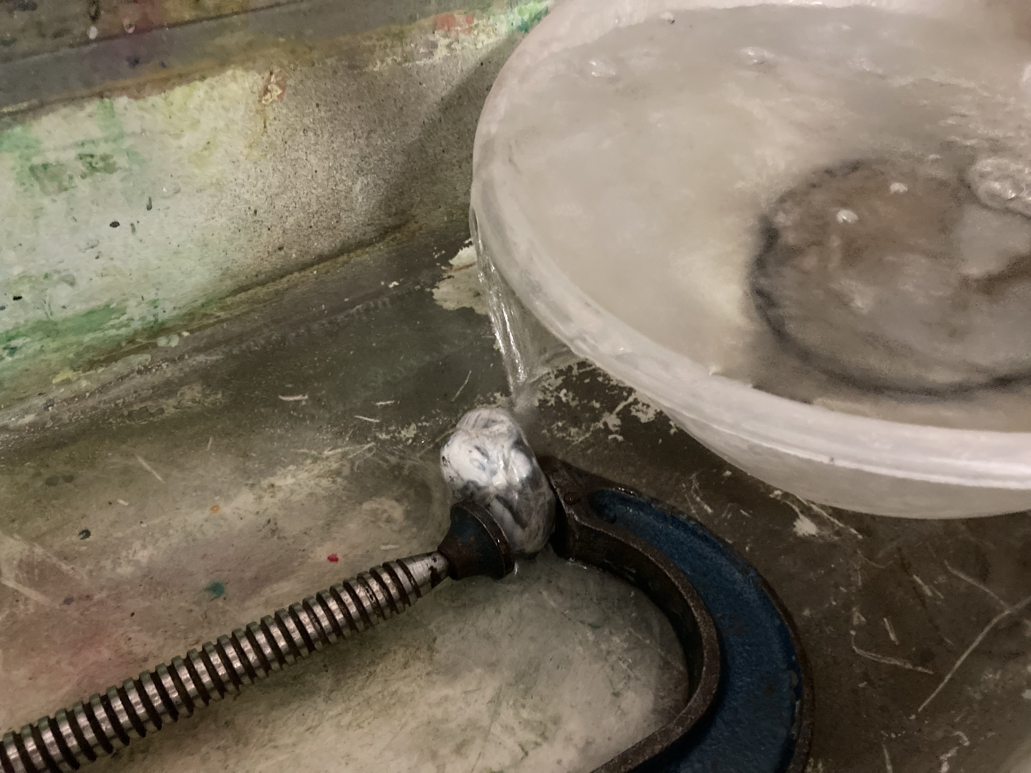

I tried the sink in the mess room, and it does have running water and the plumbing is set up :raised_hands: However, I’m not sure how to get the clamps set up there to keep the stone stable under the faucet.
Bit of a jank setup, but it works :rofl:
Good to know that! That also makes it easier, at least for now while we can use that area. Water pressure from the tap is more than enough. Just need to attach tubing to the tap. It’s very low pressure, so cheap jank way is old rubber glove an No8 wire. If there’s a filter on the outflow of the tray, water can just go down the drain, if @joeatkin2 is ok with that.
