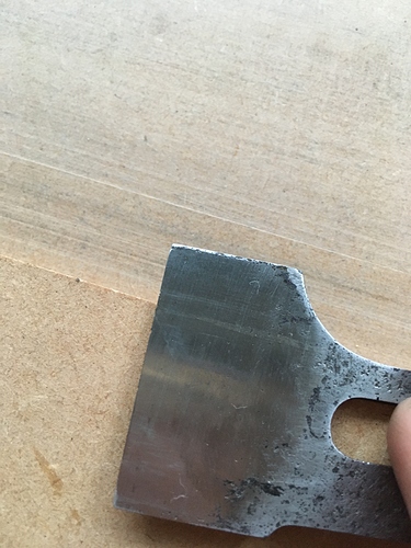

I just a got a new ( second hand) no 78. I was pretty nervous about buying a plane unseen after my experience with three different planes which all had significant issues. Even the workshop heaven plane is not as advertised, it’s definitely not accurately machined. Anyway I have hit the jackpot with this, the sole and the side are really nice and flat, it’s a tool which will be a source of pleasure as opposed to the constant irritation caused by some of my crappy tools which are beyond modification. I can use this for my next project, a six board chest. However I realise I need a bench I can’t do the work I want on a workmate, maybe it’s possible to make a bench at the space. I don’t think it will be easy getting even five foot boards accurately dimensioned at the space though. So, I am building two saw benches, these will give me some ability to work the wood for a bench. There is a concrete table tennis table five minutes walk, I use it as a bench sometimes, it’s solid as a rock and flatter than the benches at the space.
The blade needs a little work, ( on closer inspection it needed a lot of work ) but that’s easy now I have a trend diamond stone; it’s professional quality and truly flat. I backed off a blade with it the other day. Something which I had never dreamed of doing with my cheap diamond plates. Quality tools seem to be more than the sum of their parts, they work accurately and predictably. Can’t believe my luck getting such a good example, the nicker is fully intact too. Result.
I have given this plane a detailed look. I am very happy. I realised this was a marriage when I saw the photos. I couldn’t care less, I am not a collector, I am going to use this, it’s a functional tool not an ornament. IMO cutting rabbets by hand with these planes yields good results most of the time. I don’t feel the same about plough planes cutting grooves, forget it, a router does a much more accurate job. If Paul Sellers smokes, do you think he lights up with a steel and a piece of flint? I digress, I am purchasing a penny washer m5x 15mm; the one included is the wrong size. Cost £1.50 for ten. I am also buying a new blade, ( £10)the included blade is a very old record and it’s not flat right in the corner where it matters. There was a time when I would have spent a few hours lapping the blade flat, I gave it a go. I recently lapped my 3 in 1 blade until perfect so, I can say with confidence the 78 blade is at least an hour or two away from flat, at least ( it doesn’t look like much in the photo). I am just going to buy a new Stanley blade. If it’s a banana behind the edge I will send it back. I really am feeling very lucky, if you got ten of these, how many would have super flat soles? Possibly not even one or two, they can be super sketchy. It’s my number one consideration with most planes, if this was concave it would bite deeper at the start and end of each cut and convex is just a total lottery and incredibly labour intensive to fix.

Well you might like to know that they make two or three spares kits which are available in uk with the exception of the nicker replacement kit. So, you will be able to get any parts you may need. I would be interested to know the state of the sole on your example? I just wasted an hour or so lapping the back of the blade. Unfortunately the edge of the blade is very slightly chamfered and would require another couple of hours lapping. Two of my fingers actually started to bleed, I managed to lap the end of two fingers. That’s a first and I have remedied a lot of banana blades. I am calling it quits and buying a Stanley. It actually seems wrong to me having a record blade in what is a decently made Stanley plane. I think the plane will be more at ease knowing I made the effort to bring it home. It’s at this stage I feel I may need an intervention and psychiatric help…ha ha ha

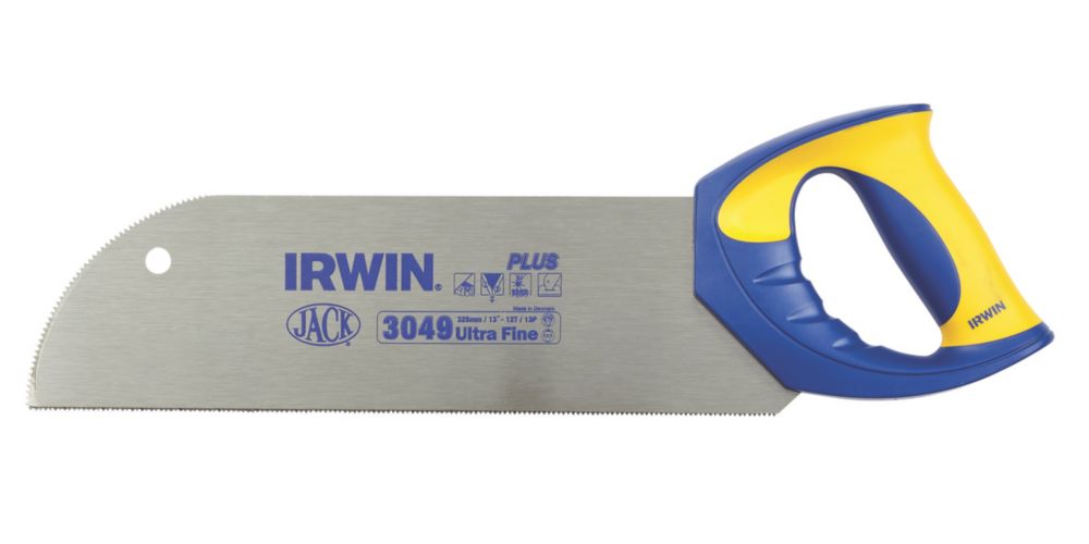

The western saw I recommend for hobby woodworkers on a budget this 13” Irwin saw from screwfix. Small enough to fit in a toolbox. Super sharp , fine kerf, leaves an excellent finish and cheap. My go to saw for site work.
