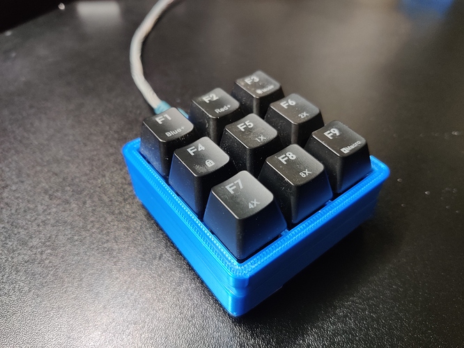

Hey, I recently built a Void 9:
Come to the electronics night and we can chat about it!
@GrahamClemo thanks, will do!
@emuboy very pretty! i’d be very interested to know how you design the case for something like this. see you at the next electronics night!
I didn’t designed it but I have some info I can help you with !
