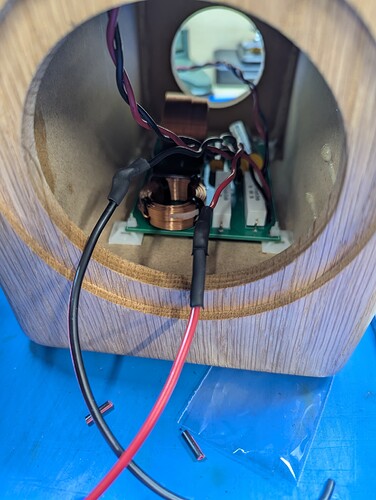

The components came with a board with pre-traced routes and traced out, labelled components, which made crossover assembly very straightforward and I mounted them in the partially assembled boxes.

From that point the woodworking was done, so I mounted in the terminal cup at the back (with smartly labelled wires), and added some polyfill to dampen internal reflections.
Wired up the tweeter and mid bass woofer, and mounted them in as well and then they were done.
