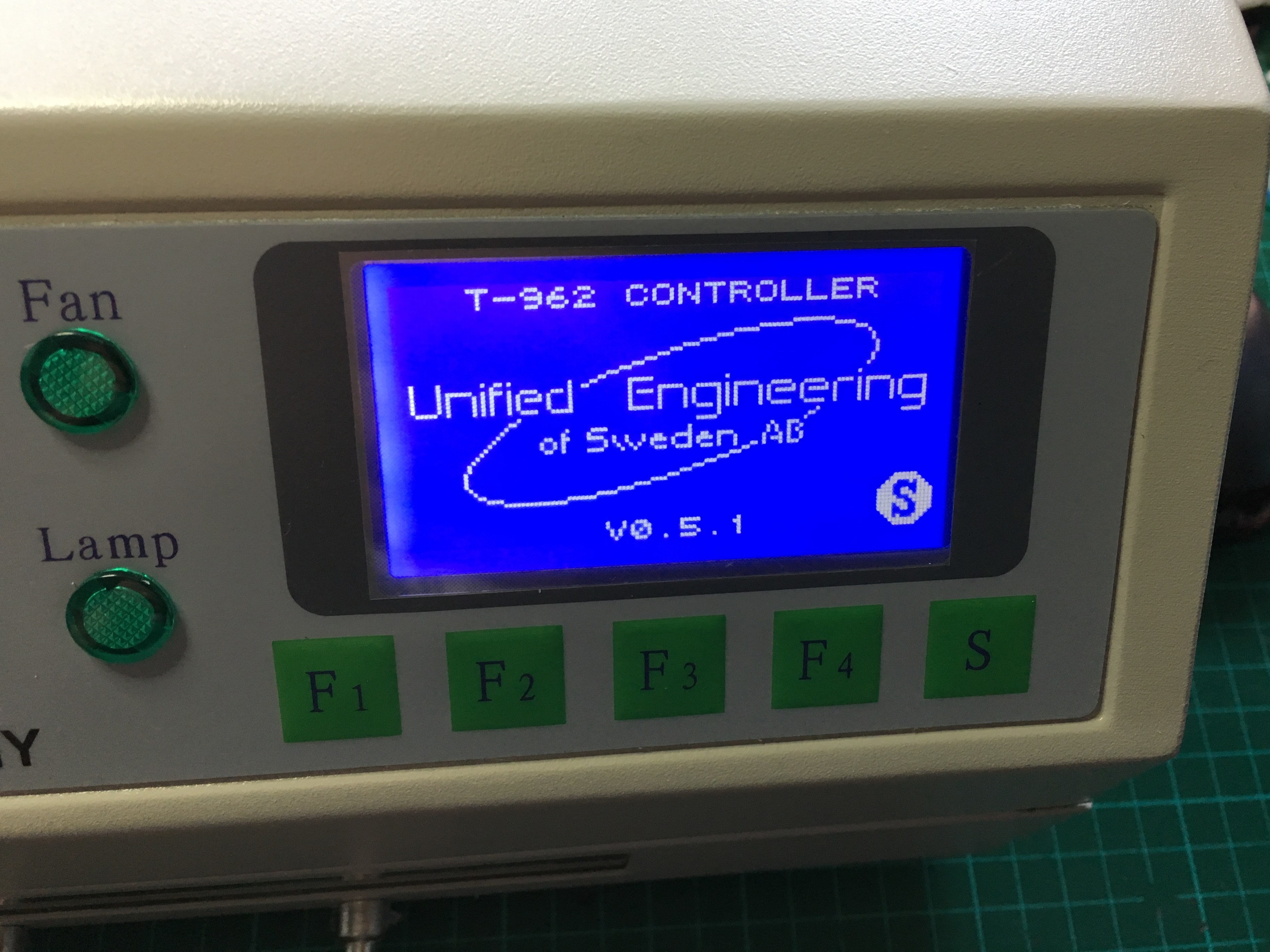

  3. The original Chinese software is unusable - I’ve flashed the controller with the Swedish Unified Engineering version which works really well.

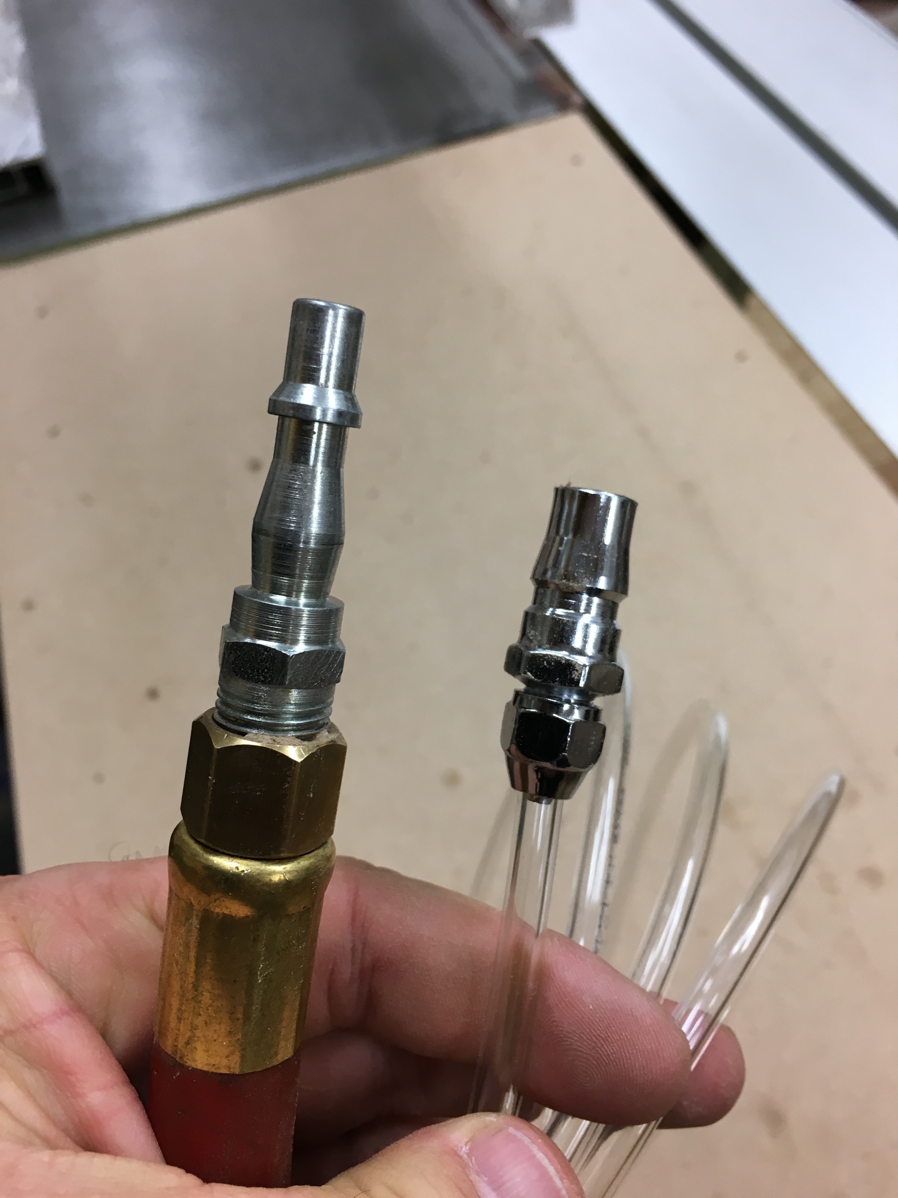

Not quite 100% in service yet, couple of square peg/round hole problems with the air supply and solder dispenser where we have mismatched fittings. Will bring the required parts in on Thursday and commission the units if anyone fancies a play?
