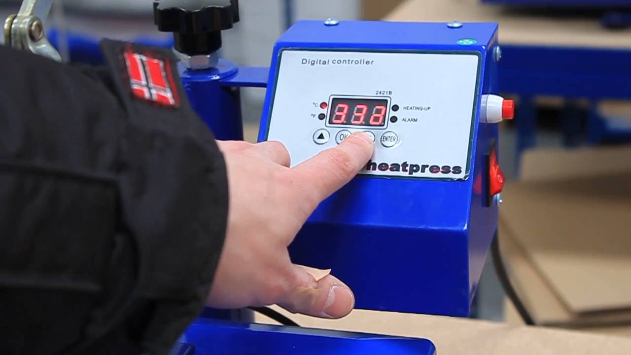

UK Press HP230B Swing Arm Heatpress
30cm by 30cm Swing press
600w
A4 format
For Sublimation and heat transfer vinyl
Max 220 degree
In built timer
Note: NO IDELE MODE (Wont auto switch off!)

Instruction for safe use,
Before Use
Before Use
Stay with it while it heats up and make sure you have allocated yourself enough time to be with the tool from heating to cooldown.
During Use
—Avoid contact with hot plate, do not leave unattended, do not leave switched on, use at the correct temperature and time required for the particular use, avoid the possibility of burns or mechanical injury to non users.
—Always use it with the Teflon sheets and paper so if the ink comes through it wont affect other peoples projects
After Use
Make sure it has cooled down
