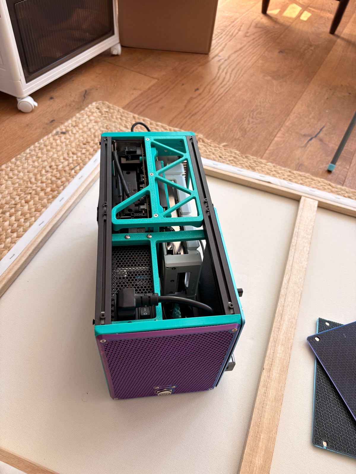

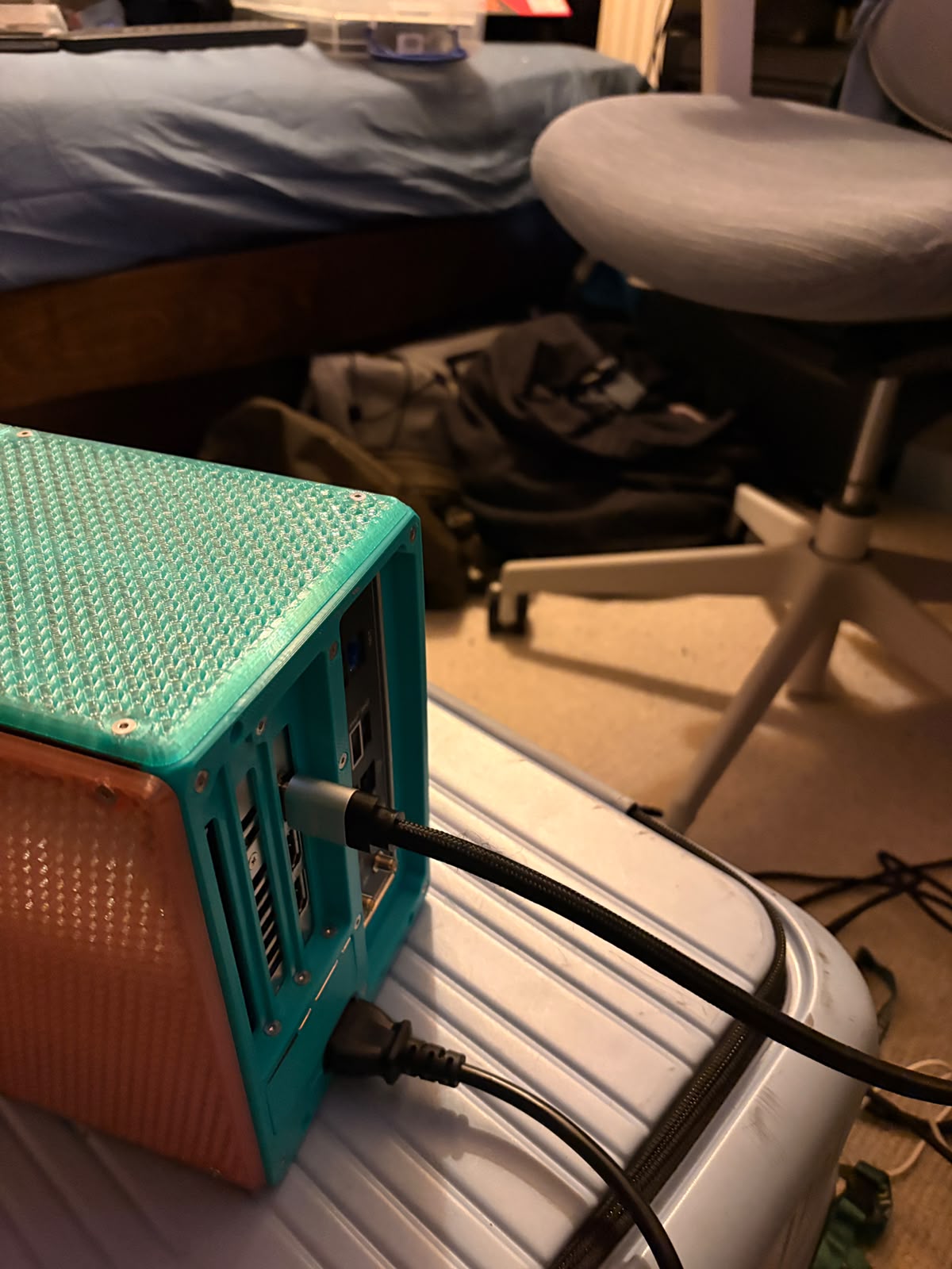

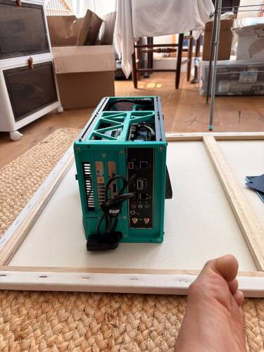

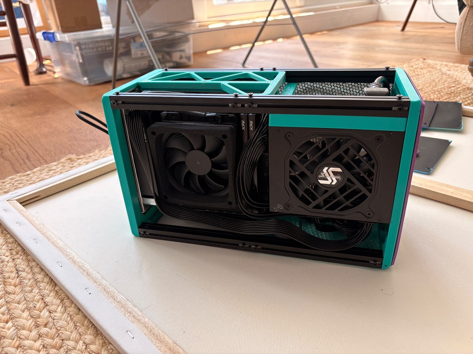

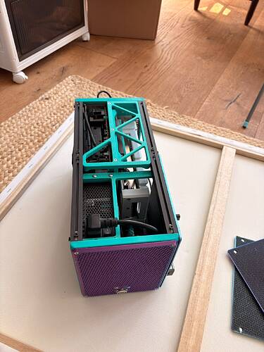

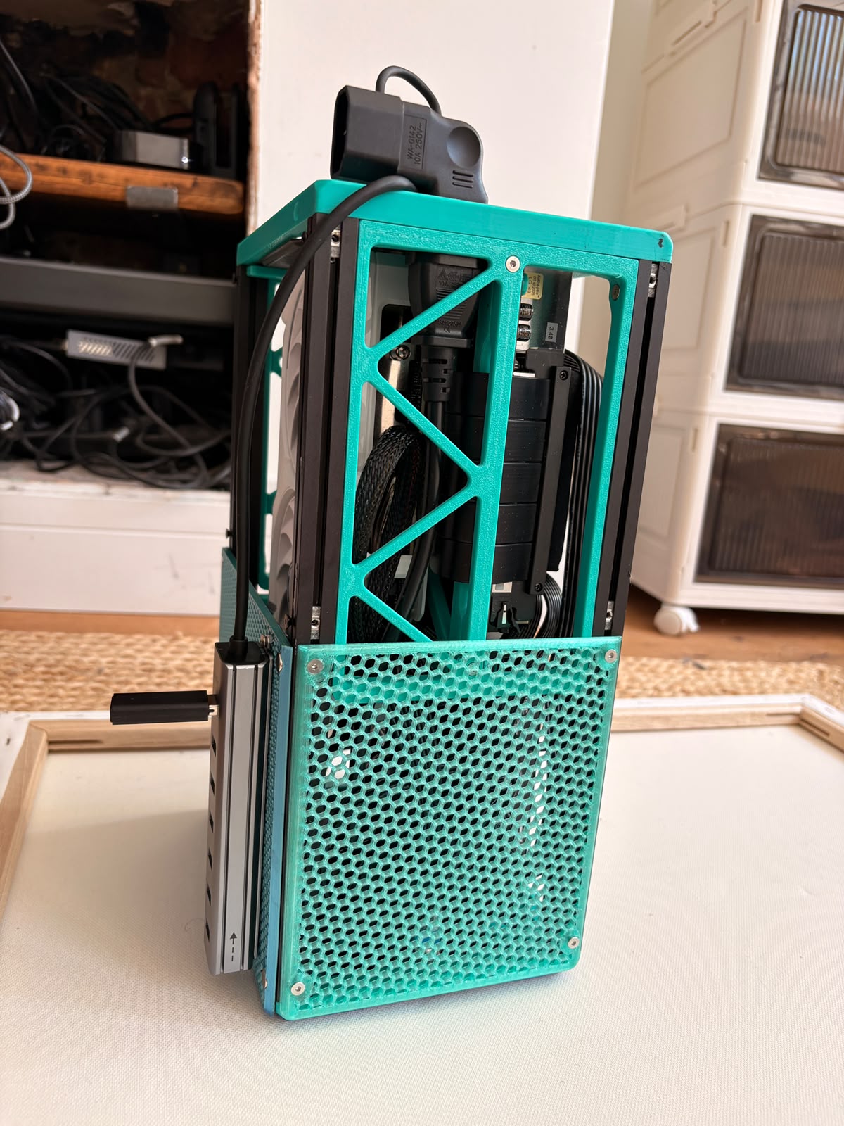

Fair bit of progress here - while I was still deciding whether I was going to join or not, I found a dude to print the parts I needed as a backup, and they arrived around the time I had all the internal structure bits printed myself.

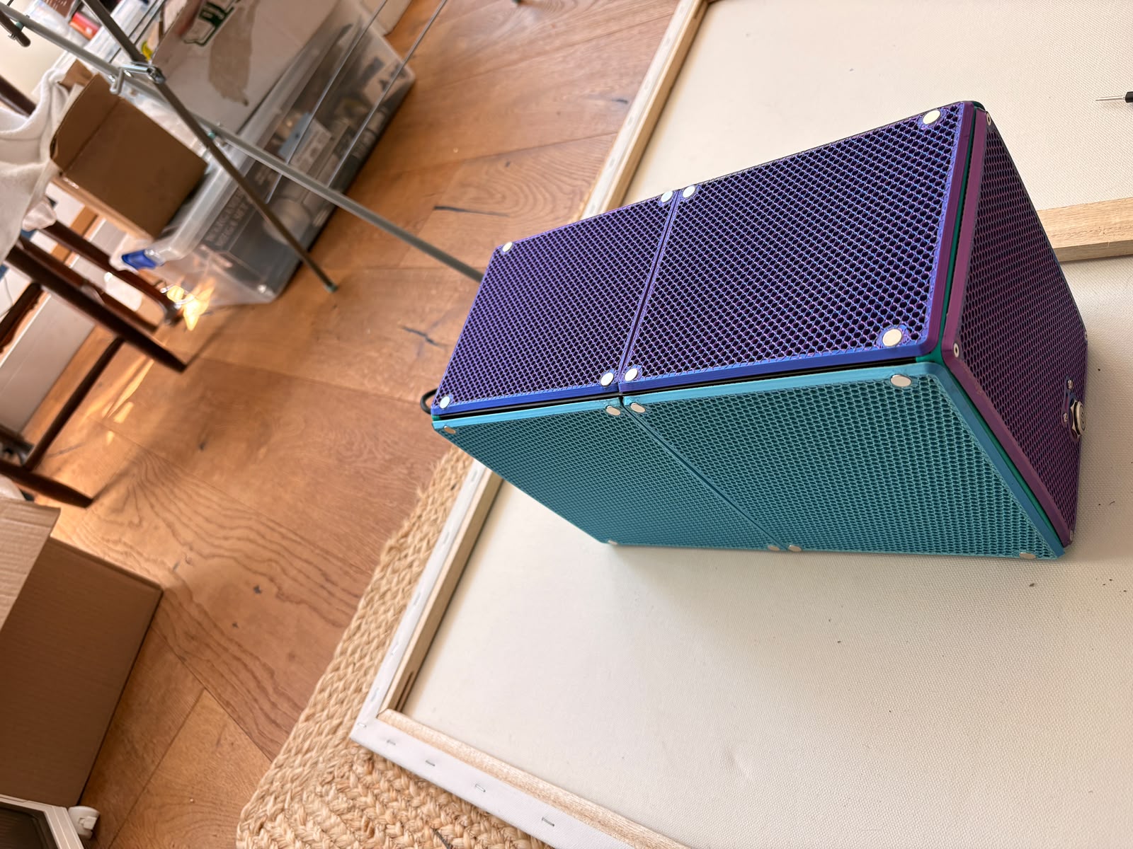

I like the other guy’s colour better (and he printed in ASA rather than PETG), so I rebuilt the whole thing with his. At the same time, though, I’d edited the front panel file to add a space for a front USB-C port, and the side panels to experiment with having those attach magnetically instead of screwing on, and that seems to have worked!
So now I need to print a bunch of the new magnet-ready panels and experiment with putting a PVC mesh (or maybe just printing with a finer mesh?) before I put it to work

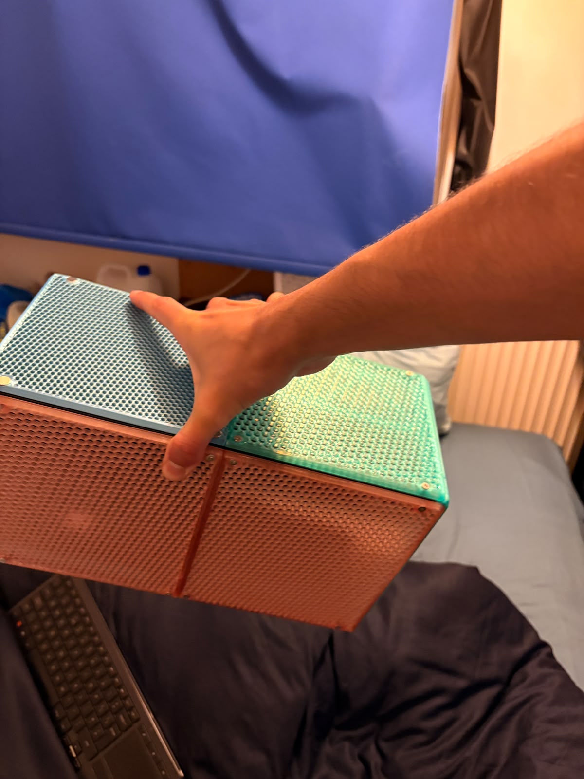

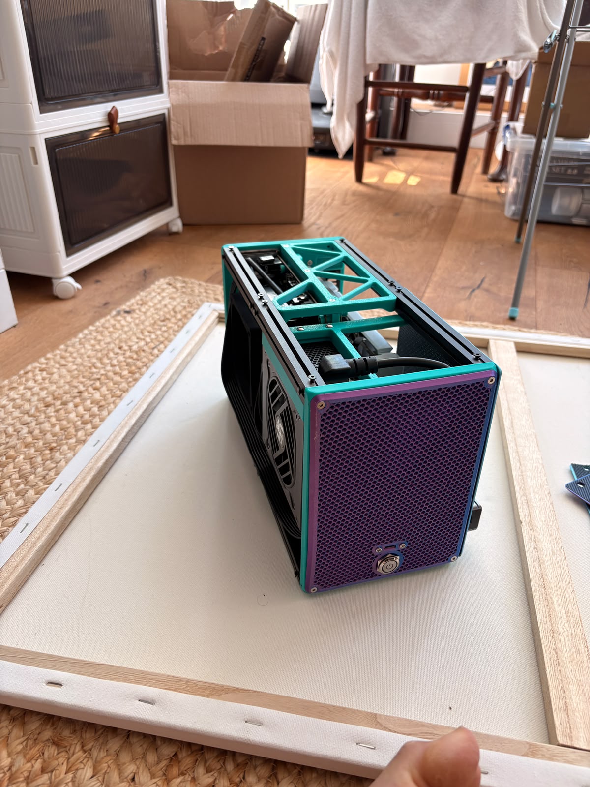

It currently weighs 4.5kg, measures approx 30x15x20cm and I can pick it up by the top in
one hand, which is very pleasing!

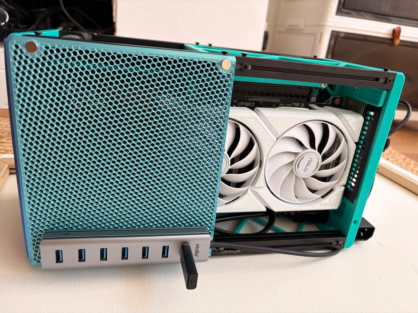

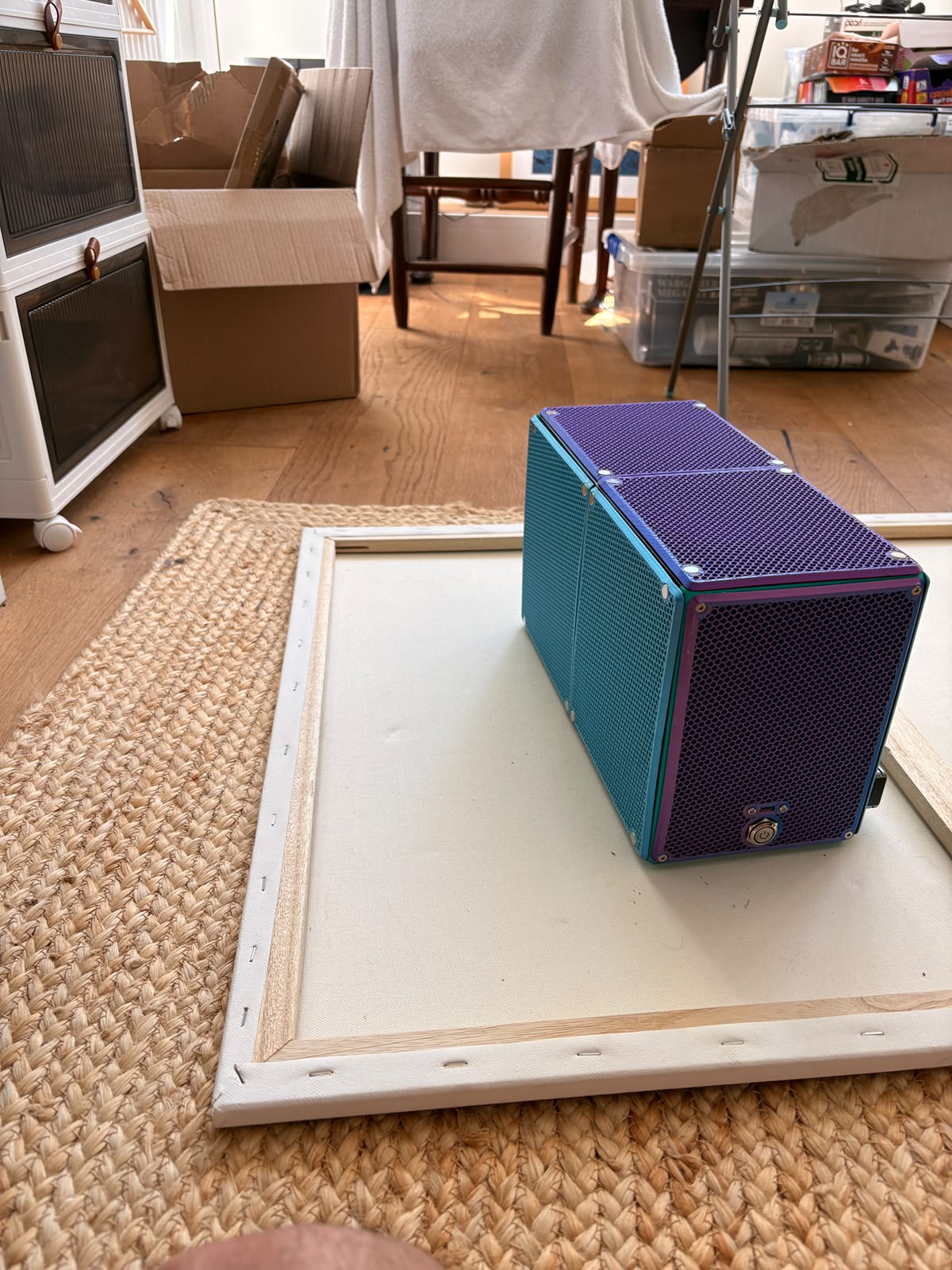

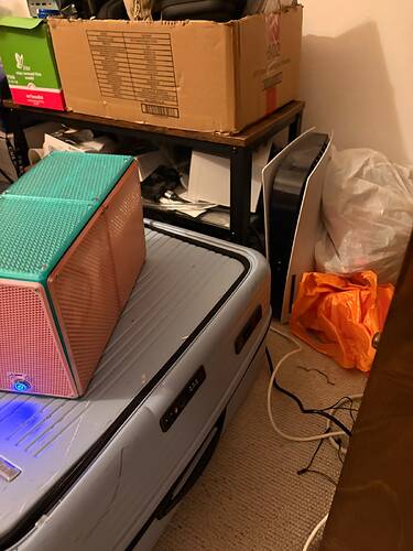

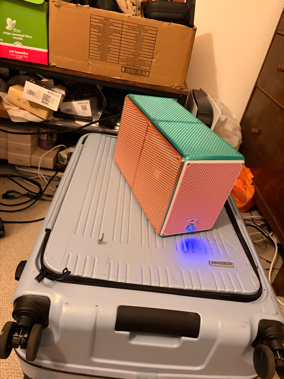

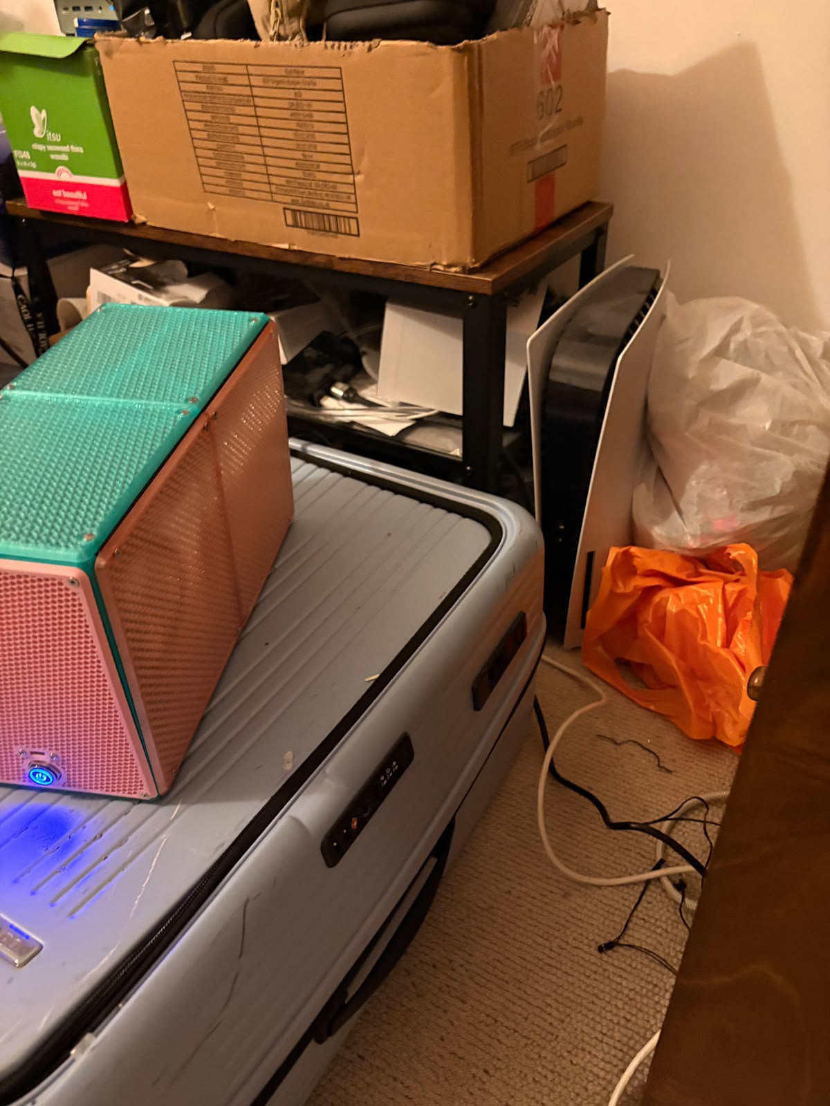

In the first pic here, you can see my new experimental magnet-panel printed at the space in blue Hawaiian PLA (left) vs the printed-for-me one in translucent teal PETG. The front panel is printed at the space in pink PLA, the side pink panels are printed for me in translucent pink PETG. I think I’m going to use the blue hawaiian for the other blue panels, and neon city for the pink panels.

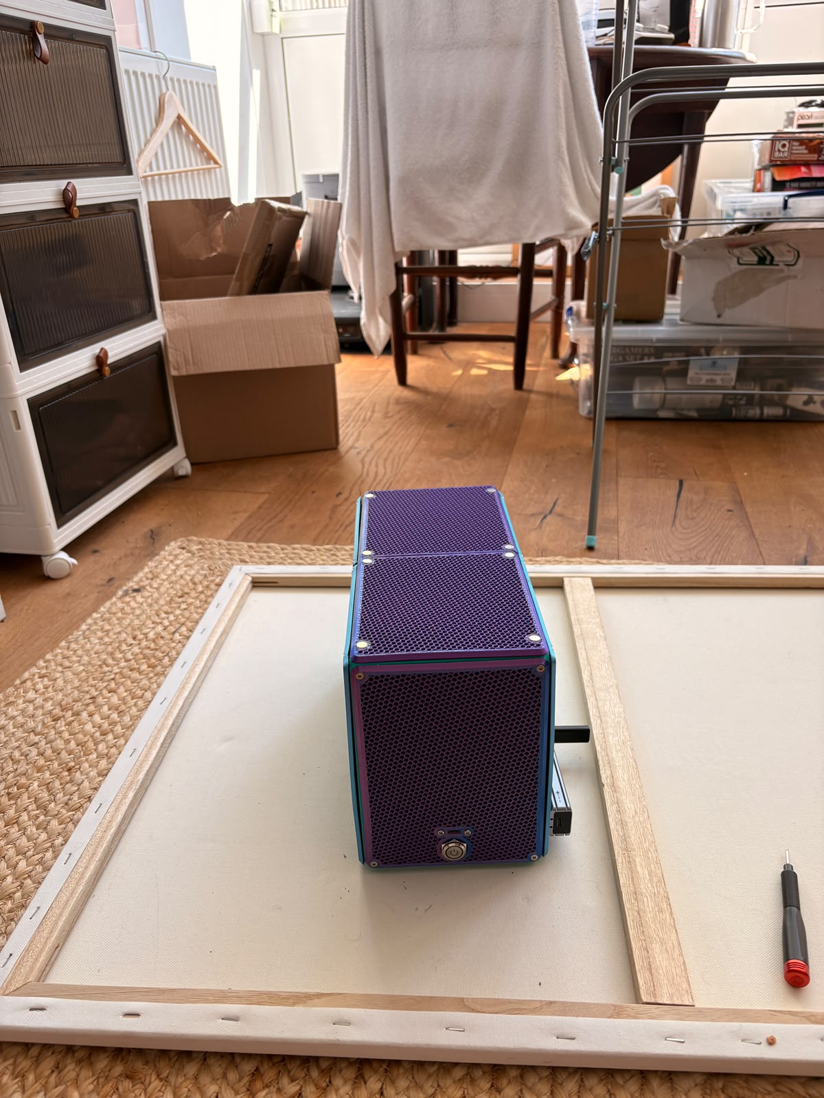

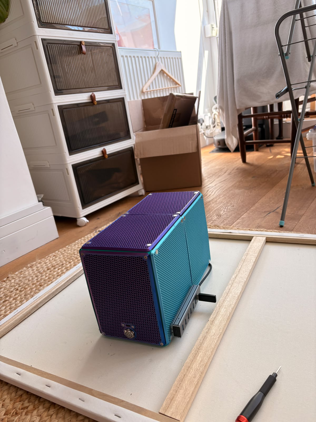

I ended up replacing the core frame with an ABS one I got printed elsewhere (originally printed as a backup, but I liked the colour more), and the panels with Neon City (Blue/Purple) and Blue Hawaii (Green/Blue) modified to (just about) connect magnetically, aligned to be more Purple+Blue from the front and Blue+Green from the back.
…And now it lives hidden in a hole in the wall under my TV behind the canvas it’s sitting on in the picture
