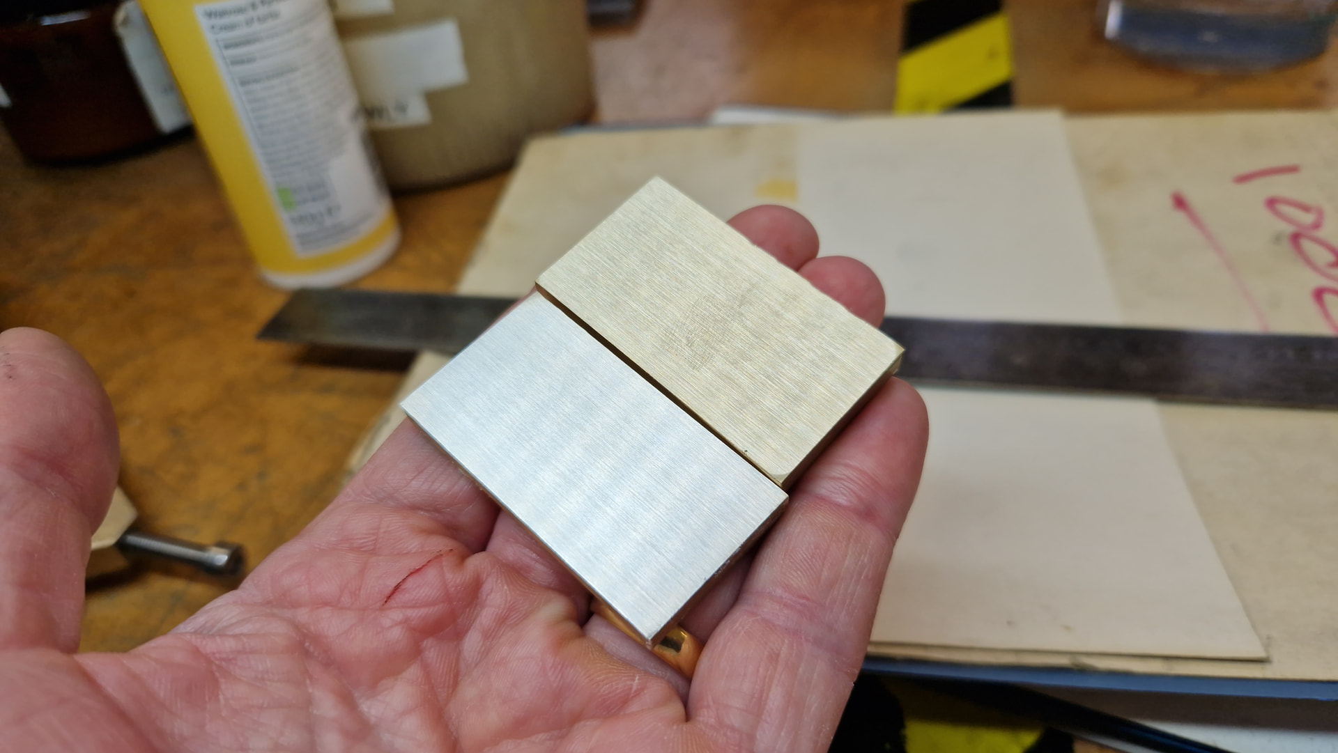

This doesn’t need to involve electroplating. You can also do purely chemical silver plating, as is done on old brass clock dials. It’s a silver paste that you literally just rub on with your fingers. If you think this might work for your jewellery, I’d be quite keen to try it out with you. I’ve got a “secret recipe” to make the plating solution youself so you don’t need to buy the expensive commercial stuff and I’d be keen to try to make some.
