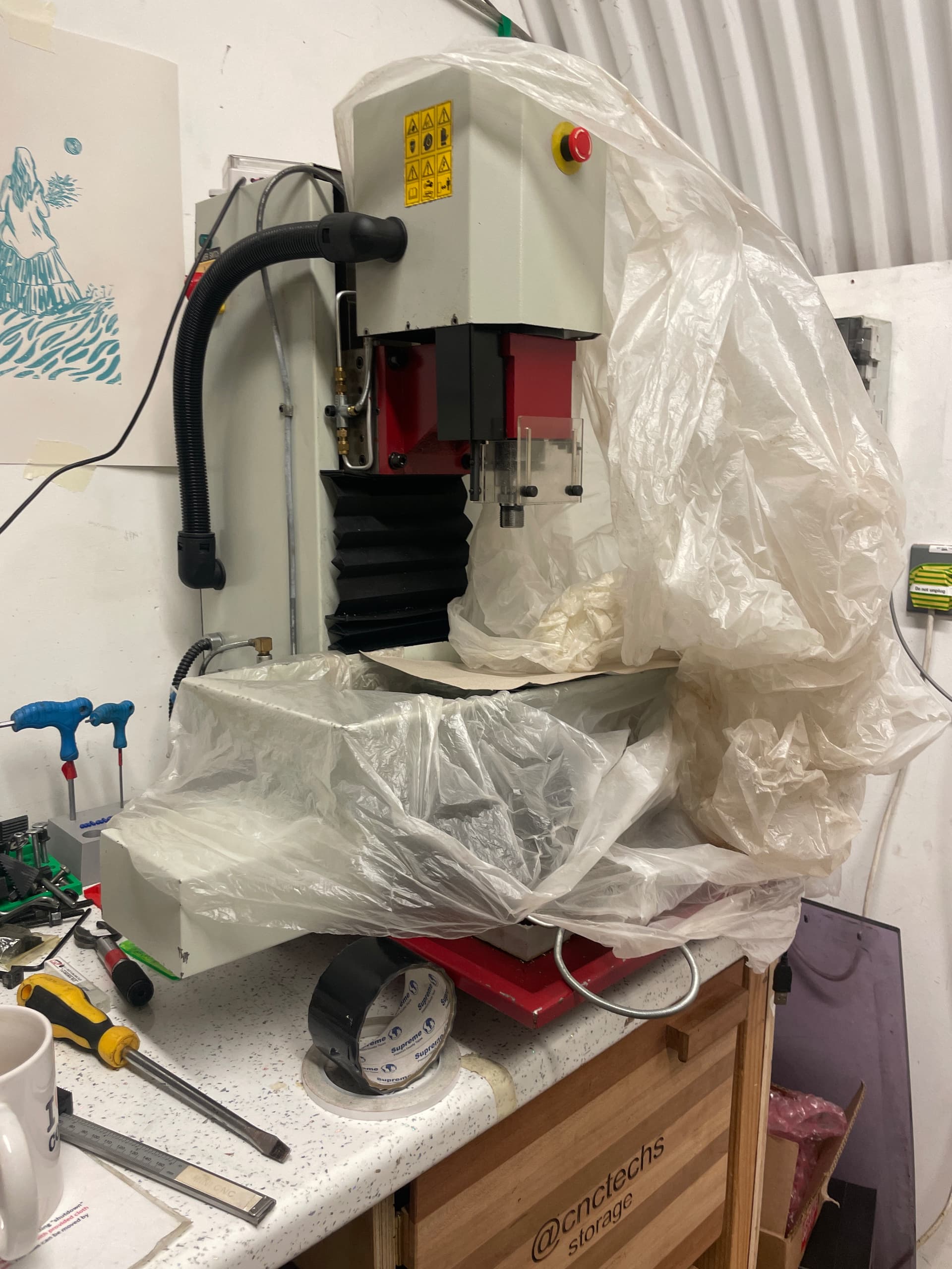

  1. It gets dirty with coolant, which isn’t great for the messy room (which doesn’t like anything oliy for the lasers, screen printing and other CnC. So it needs and enclosure or we need to move it to Metal Shop @metaltechs. We’ve been talking about an enclosure, but atm priority is on inductions all over the space as we’re SO behind on CnC, Screen printing, etc waiting lists.

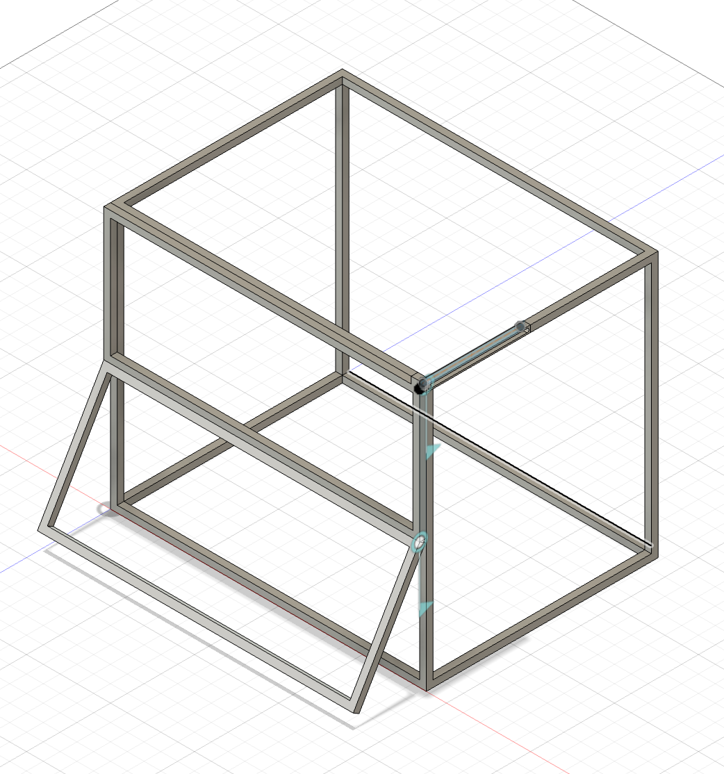

@Kyle and I designed an enclosure, but we weren’t completely convinced of the solution to all the constraints. I think thats why we never pulled the trigger on the £££ of materials. Happy to provide the model if it’s of any help and can be around this weekend. The L shape sounds like a good option.

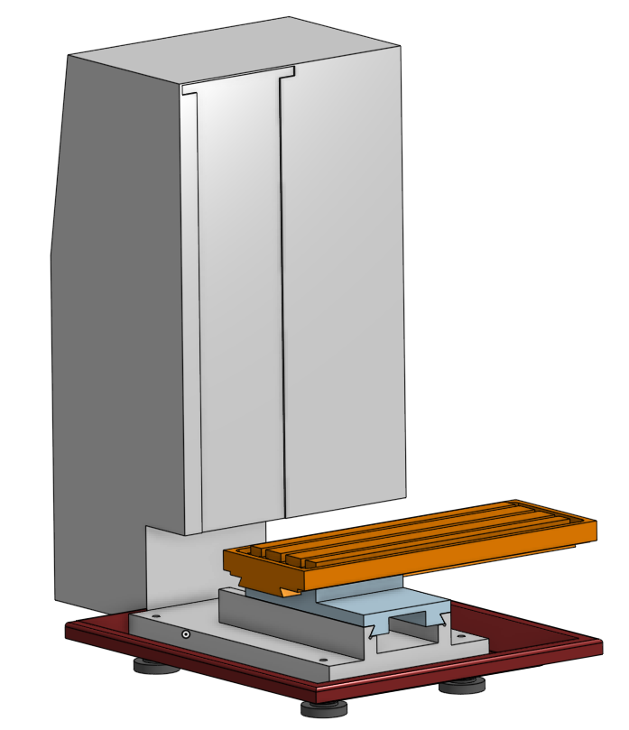

Small update - I’m making a simplified model of the CNC in CAD to support the enclosure design work. I’ll link the file when it’s done, and will then sketch up some enclosure proposals.

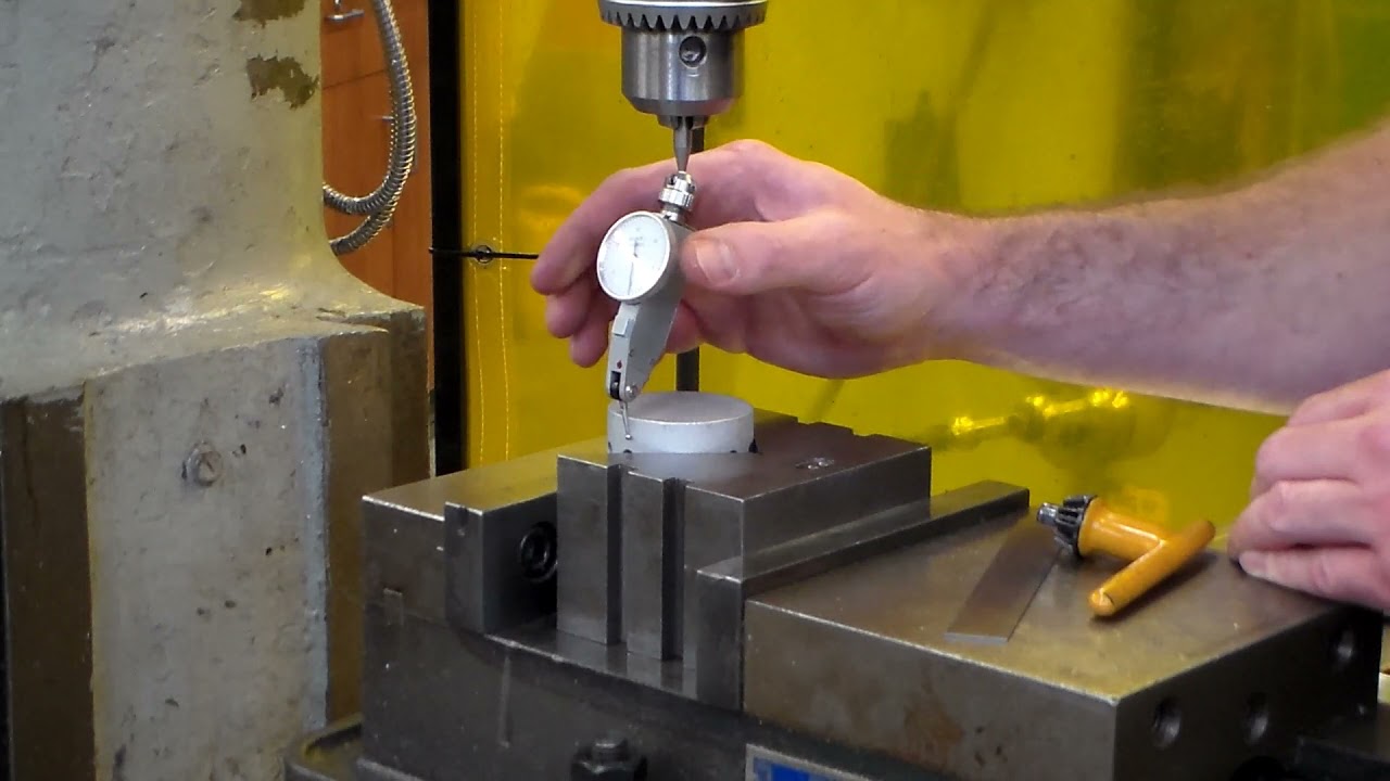

Just a design/HS thought. If the enclosure ends up with a safety switch it would be good to have it possible to override that? Else as the mini-cnc it is really not possible to set up centering on round pieces with any accuracy with a wobbler or a dial micrometer mounted in the spindle if you can’t hand twist them around while adjusting X and Y.
Good point - do you have any pics of any previous parts you’ve machined with this setup? Just to help picture how it might work with the sieg
The sort of centreing I generally need to do is demonstrated here:

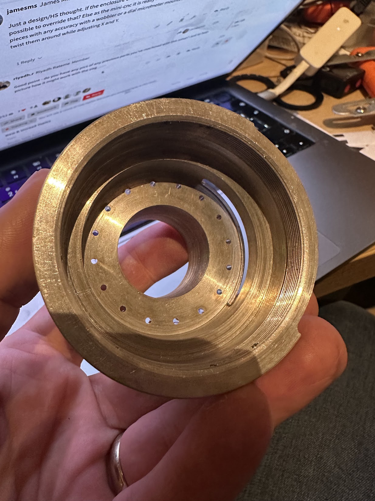

I make parts like this lens cell: the main part and threading was done on the lathe so on moving to the mill to make those iris pin holes have to have an ability to accurately centre to within a few microns.
