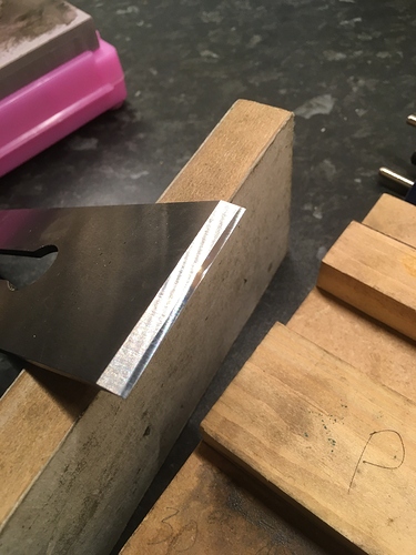

I am going out. I just jumped on the stone. This is the aftermath of about 20 seconds of use. I raised a burr across the entire width of my block plane blade in that time. I have tried this out on another blade and it is really good. I have had some more use of this stone and I realise it was ultra quick on my block plane due to the blade being softer than my most modern blades. So bearing that in mind it has met my expectations and the claims made by various sources are correct. This is a very good stone with improved characteristics, compared to alternatives. It requires a little flattening but nothing drastic or greatly time consuming. This would have to be one of the stand out additions to my tools over three and a half years of woodwork .This stone is still very good, it’s fast and it’s hard and it’s a true splash and go, success at every level.

Ha ha , still getting the hang of the interweb computer thingy…der… I have never had any issues sharpening knives freehand I have always done knives freehand with good results. Curved blades, I move the stone not the tool and find I get no issues, straight woodwork blades I use a jig because I like the way it looks and I don’t have to think about the angle. I do sharpen some straight blades freehand. I think finding the angle is possibly less of an issue than I think because I never noticed any difference between my freehand efforts. I like jigs, I like freehand. The picture shows that the surface created is a uniform hazy surface with some very slight directional striating. The 5k won’t have any issues refining the surface. It’s sharp enough to use at 1k and a quick strop on some cardboard, you may be glad to hear that I have cleaned my tangle wood guitar tuner after seeing this picture. Apologies for the random sprawling nature of this post . I like sharpening and shiny things and endlessly editing these posts. So that’s a win, win, win, computer skills not so much…
