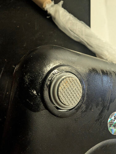

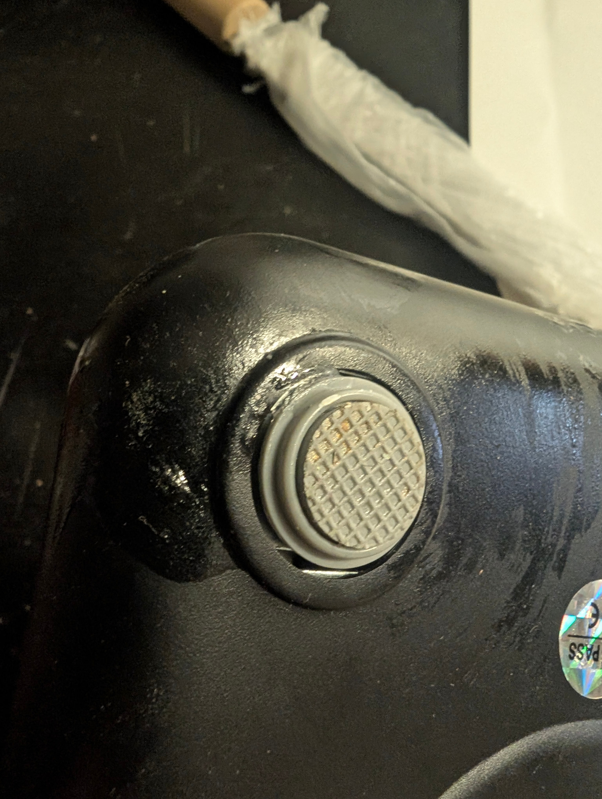

Small PSA to meticulously clean the scales when you’re done, and check all feet are clear of debris or blockages. @screenprinters
Thankfully I was just doing a final weigh in at the end of a project, not mixing chemicals or sensitive materials.
My part came in 200g shy of what I was expecting so I checked and one foot was essentially epoxied to the base. I’ve cleaned it out and got equal readings with a bottle of liquid weighed in each corner, so should be good to go!
For reference, a 500g bottle of liquid came in as low as 390g when it was dirty.
