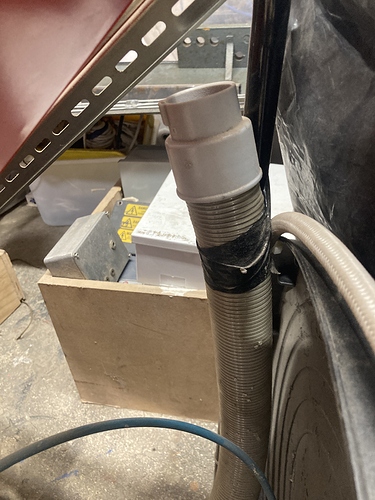

I had a look at the cabinet. Generally looks straight forward but there’s a hose out the back right side (photo attached) which I assume extracts the dust? What/where does this need to plug into?

There was acyclone from a standing hoiver for the end of that hose ( and a henry should be on the end of the cyclone, , pull a plastic bag on it, if you can’t see inside chuck a hoover on.
