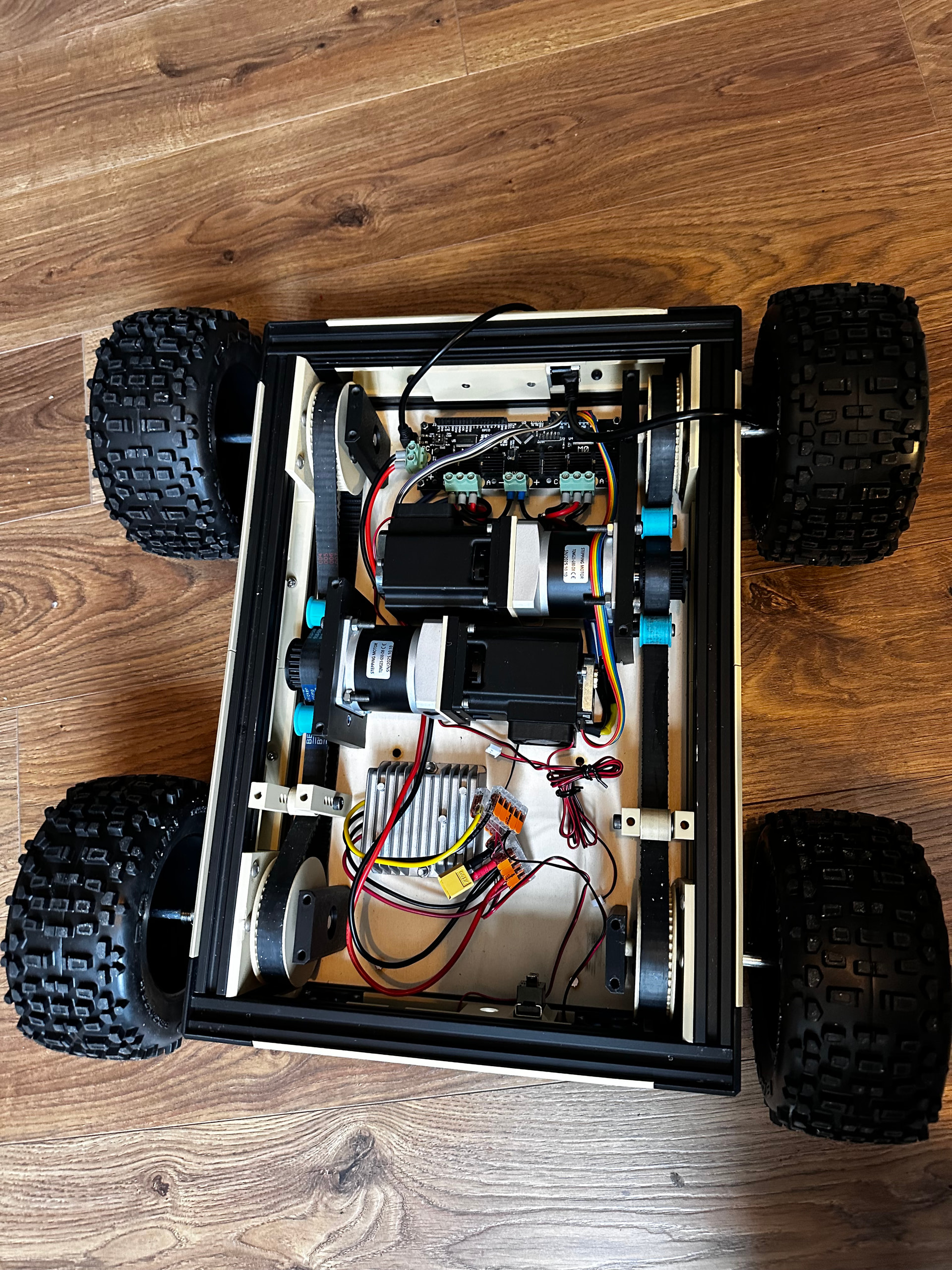

Hi,
with some chat and encouragement from the @metaltechs last night, (my first visit, cheers for making me feel welcome!) They suggested posting my project, So here it is:

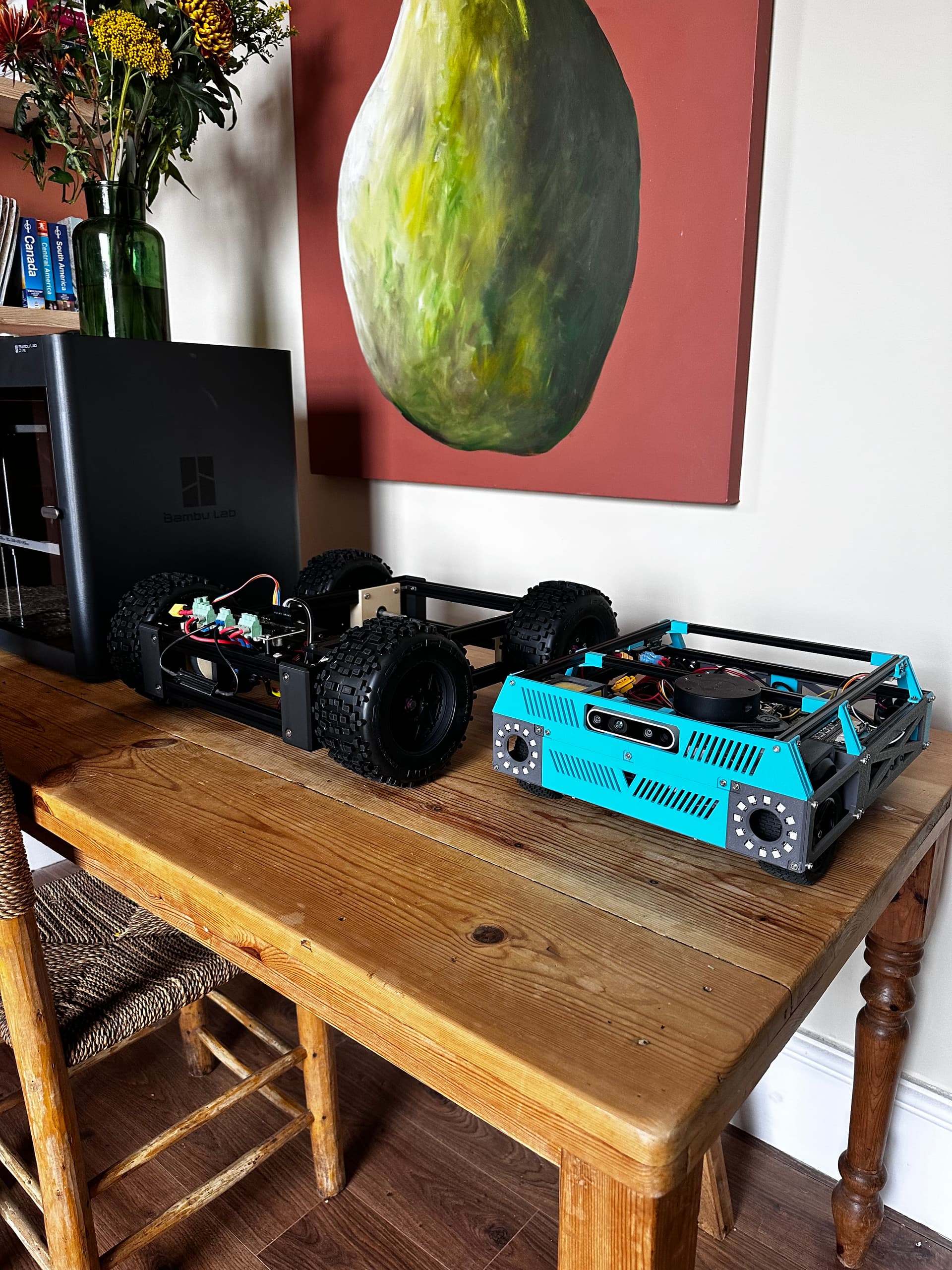

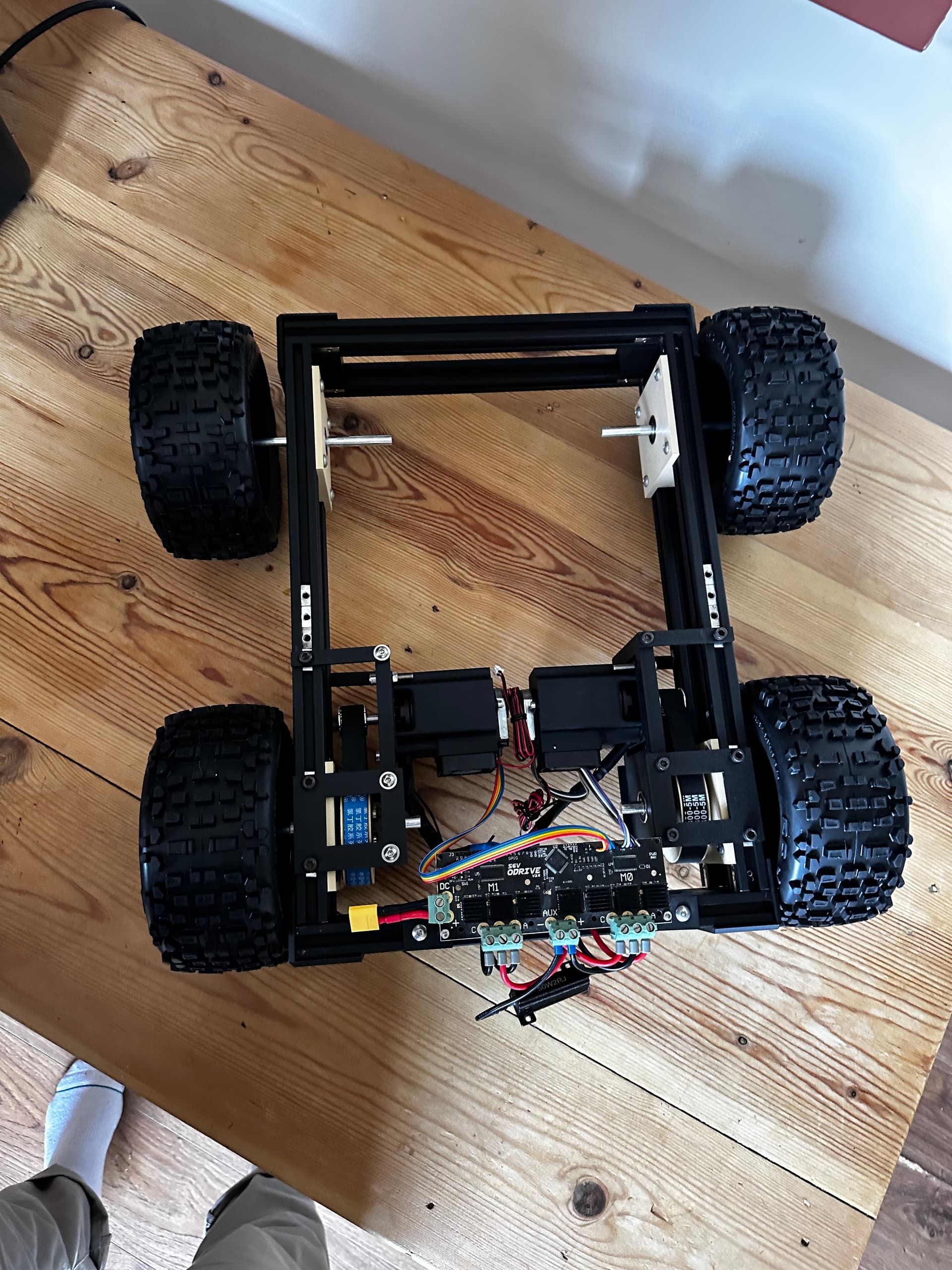

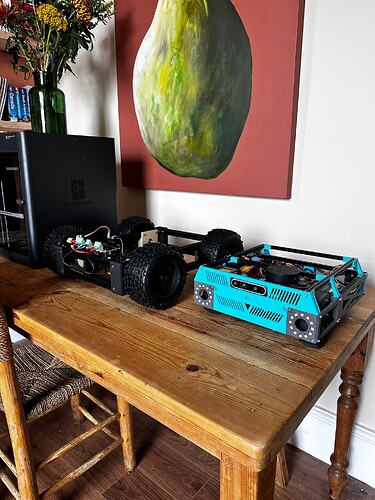

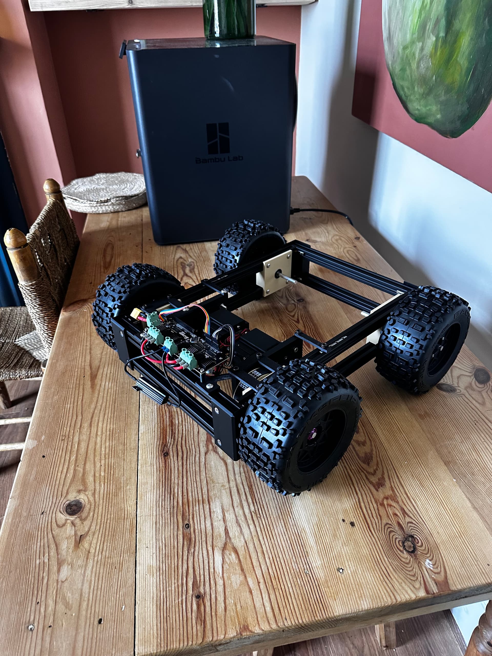

Ralph IX is the current WIP robot platform that has progressively gotten out of hand over the last few years, for reference the previous version:
The aimed plan for this is to create something more rugged for the great outdoors.
Planned improvements:
  • Leveraging tools available at the space this will be sealed more effectively with laser cut panels,
  • Robustness added with CNC milled aluminium parts
  • Moving to a BLDC based drive system.
  • bigger and more improved battery systems
  • 4WD to come (Belts to do this are on a very slow boat as it stands)
The plan is to keep much of the software the same as previous versions, blessed ROS2 makes this very easy. This will continue to use: lidar, depth cameras, gps, wifi networking, and an overworked pi serving as the brain.
Currently its looking as follows
for reference this is the previous version for comparison:
Any feedback, suggestions or pointers would be much appreciated!

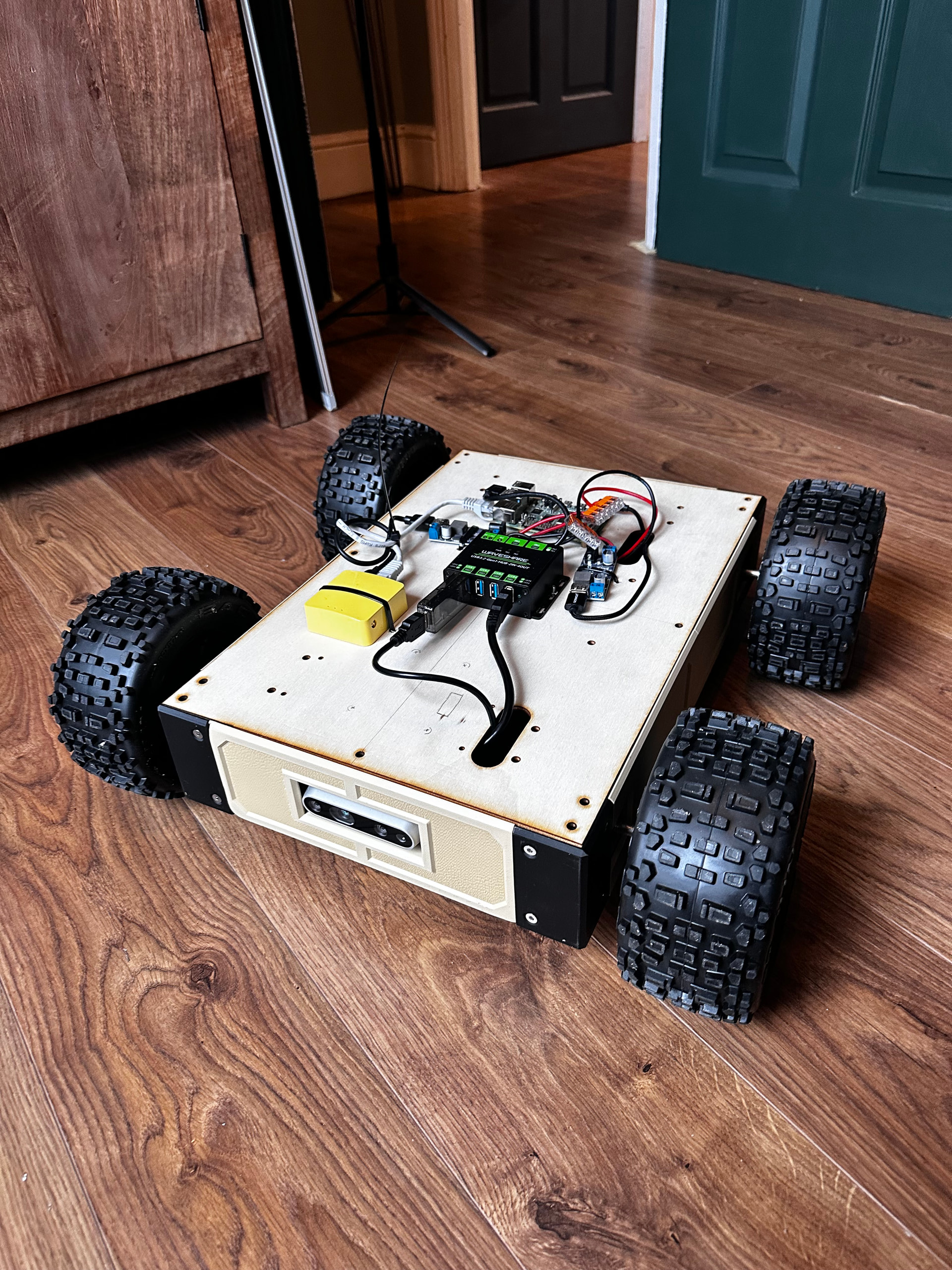

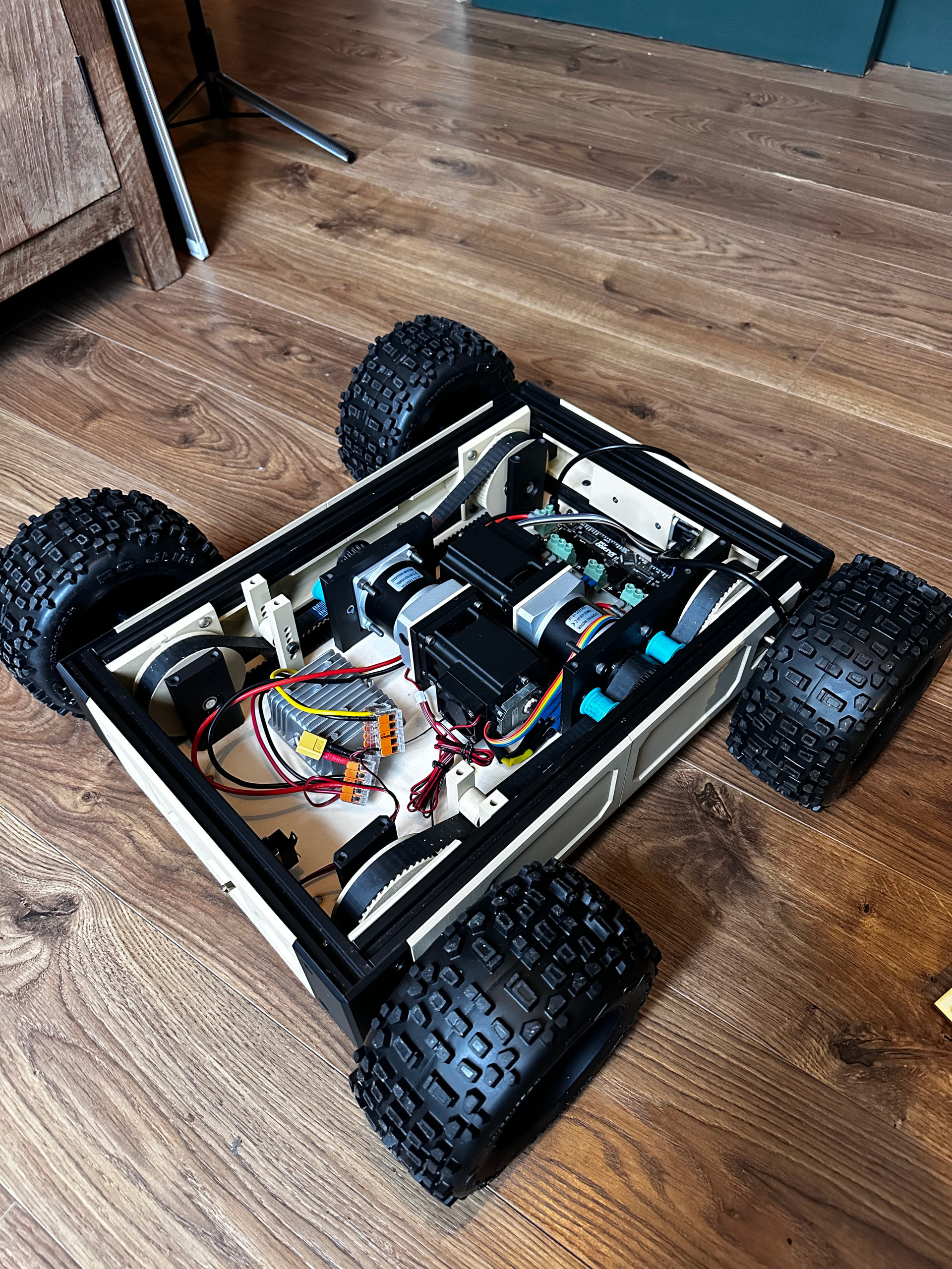

Figured a fair bit has changed so would put an update on this:
Added 50:01 planetary gearboxs, more torque and efficiency in mind, thankfully speed is by no means a requirement.
Belt Tensioning, Laser cut top and bottom plates, and a disorganised test setup of the computing / network bits on top. printed panelling, camera mounts etc
Next up: batteries, new axles (lathe induction pending) and a load more laser cutting for acryllic top sheet and final layouts
